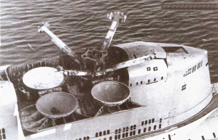

I believe this may be the deployed launcher for an R13, though it may be for an R-11. The boat may be a Golf class. Hoping someone can confirm the type of launcher and, if it is for R13, if it would be a similar layout for an early Hotel. A lot of "if's" and "may be's" but I'm hopeful this could be the basis for some scratch modification to Zvezda's Hotel. Also, if anyone has other information on just what a Hotel in surface launch configuration looked like, I'd like to learn of it.

Doing a reverse image search, it seems that the photo is of the D-2 launch system which corresponds to the R-13.
Here are some Russian forum threads for the Golf and Hotel where you can find lots of photos, although there is only one photo of a Hotel launching a missile that I'm aware of on those forums.
http://forums.airbase.ru/2013/04/t59990--podvodnye-lodki-proekta-629.html
http://forums.airbase.ru/2012/03/t69899--podvodnye-lodki-proekta-658.html

Thank you for the information on the launcher type and the links

Vepr is correct, that is definitely the D-2 launch system with an R-13 missile (~350 nm range) on a Project 629 (Golf I) submarine. The nuclear powered Hotel I (Project 658) class used exactly the same launch system. The D-2/R-13 required surfacing to launch, and an elevator system raised the launcher up to the top of the sail, stabilized by the arms encircling the missile. The later D-4 with the R-21 (750 nm range) on the Project 629A and 658M was launched from 40-50 meters underwater. I have cross sectional diagrams of both the D-2 (R-13) and underwater capable D-4 (R-21) launch systems.

I've found this plan on the second site which Vepr provided above. I suspect it may be the system in question, the D2. Can you confirm that and also, if the cross-sectional you have is of greater detail could you share it? Thank you

That's the D-2 system. The original Pr. 658 Hotel I had this as built. The Pr. 658M Hotel II had the D-4 system which didn't have the elevator as it was an underwater launch system. You can easily distinguish between Hotel I and II from the outside because the Hotel I has a "bumpy" set of missile tube doors. They are completely flat on the Hotel II.
