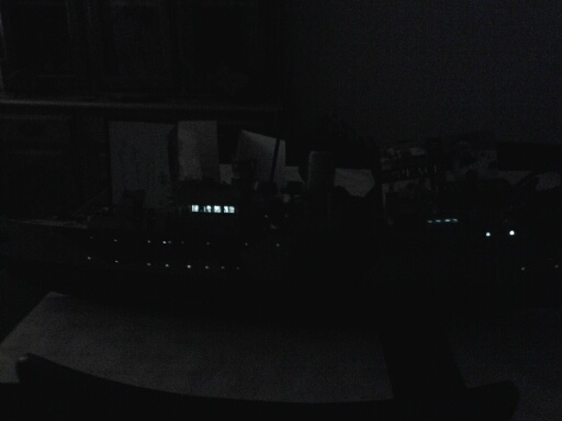

Re: 1/72 flower class conversion to rc exploration vessel
So quick description of the funtions, the search light are remote on/off, the double bulbed light in the tower rotates with the camera/gun turret in the front, and theres a camera facing aft by that aft search light viewing the spool, interior lighting illuminates with main power on, it has a bilge pump and a lead acid battery
