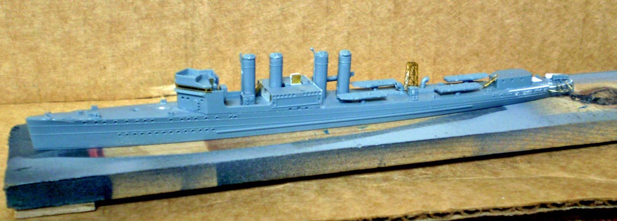

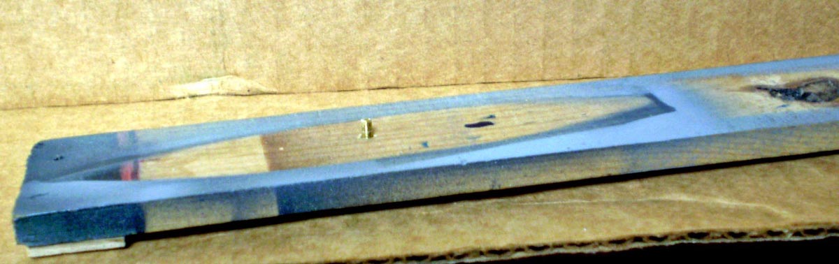

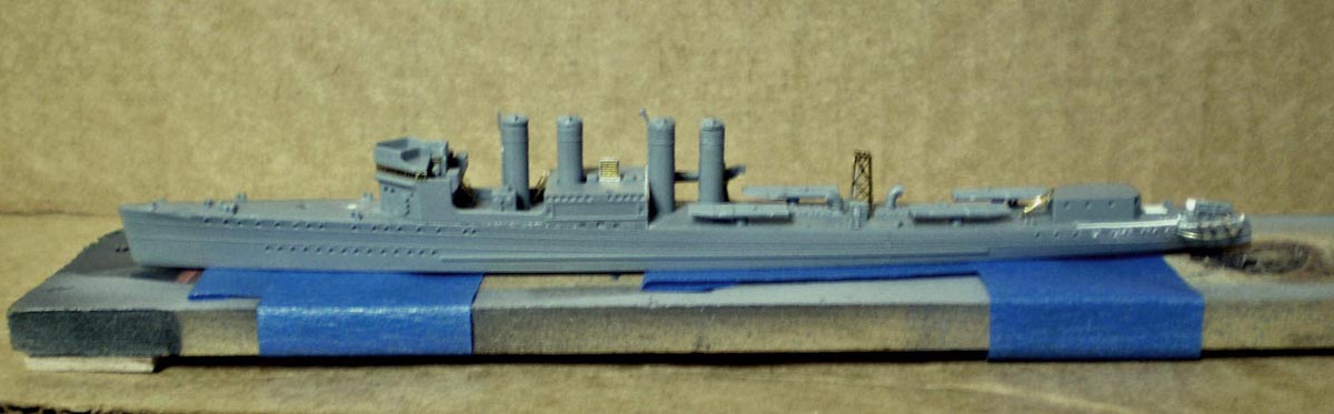

I wanted some way to better handle a 1/700 ship model when the construction phase reached adding a number of small photo etch detail parts. I took a piece of � x 1 � lath, and drilled a clearance hole for a #2-56 screw. I then glued a thick piece of styrene that had been drilled and tapped to accept a #2-56 screw inside the hull. The hull was then screwed onto the piece of wood that now allowed me to handle the model safely and securely. This plate also was handy for the painting phase. Scotch blue masking tape could be used instead of 2-56 screws although I think the screws make everything more secure. I�ve also used this type of plate for 1/1200 models.
