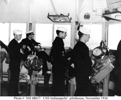

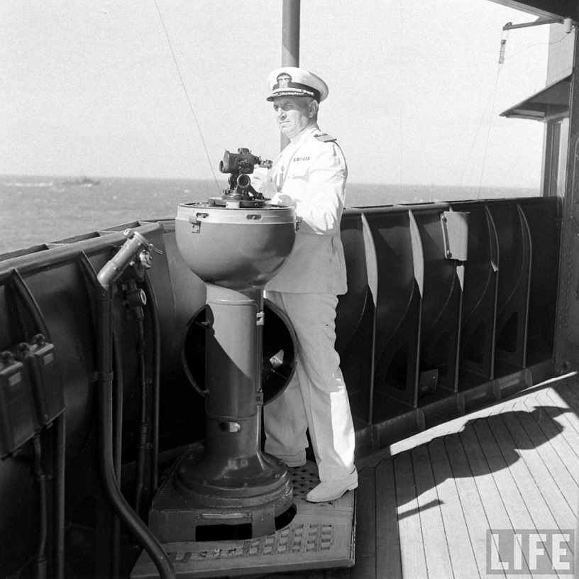

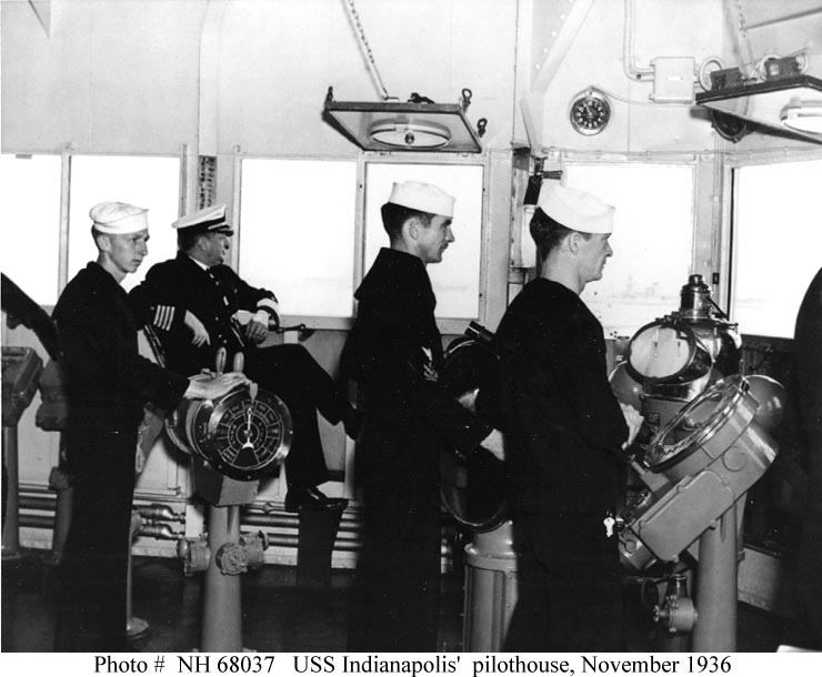

Re: Calling all USS Indianapolis & USS Portland (CA) fans
Here are some photos that may help (if you already haven't seen them). The detail is pretty neat.
Indy:
Life photos that Dick may be referring to. Portland:
Use caution when viewing Life photos because many of them were reversed left-to-right before publication!
Indy:

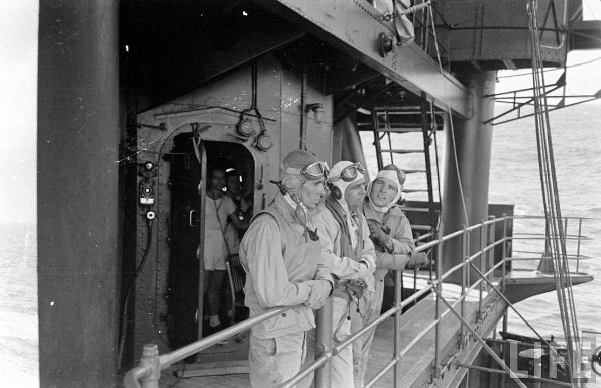

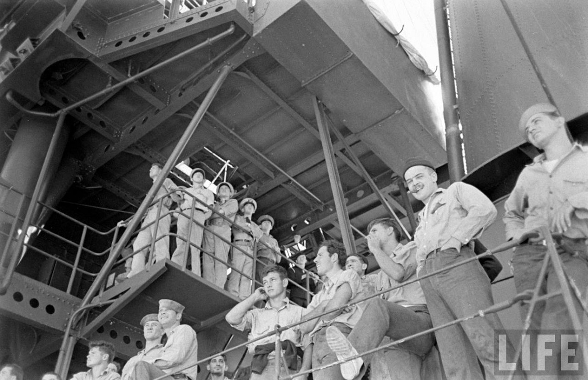

These are Portland, not Indy, but they may help since prewar the two ships were more similar, if not identical. You may have already seen these, but if not, here you go. Loads of detail visible in these.
All photos from Getty Images, among other things a repository for classic Life Magazine photos.
