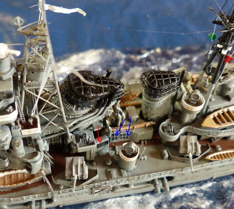

  9. There are two small symmetrical structures (parts J6, J7) on the secondary gun deck sides in the kit, both of them are incorrect (see Skulski fig. H5/3-6 for reference). J6 can be used as a basis for depicting the washing machine shed on stardboard, but J7 should not be used at all on the port side. Heavy oil hose shed is completely missing on the port side. Also the central structure supporting the front funnel (part P1) needs adding side vents.

I also thought I should enlarge on what I meant above in my initial post by point 9:
The red arrow below points to the heavy oil hose storage that was completely omitted in the kit, just like were the side vents on the central structure (blue arrows). Part J7 should not be used as shown in the kit instructions at all, but it can be cut, modified and placed accordingly to model the hose storage.
