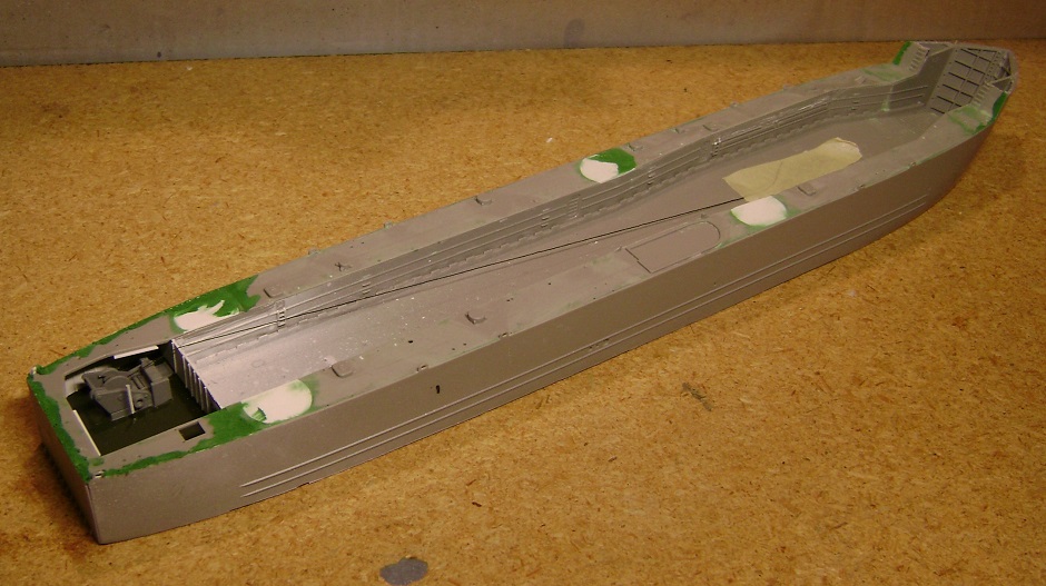

Before I attached the raised deck, I installed the focsle deck.  It would be easier to fill/file/sand the edges before the deck interferes.
Here's the focsle deck with a quick coat of gray primer.  Also, I've filled the bow door gaps.  These will get more attention later.
At last, a deck of .010 inch styrene is installed!  The deck is about .040 inch above the surrounding main deck, or 6 inches in scale. Once again, acrylic gel medium was applied over a wood base painted with acrylic Payne's Grey.
John :wave_1:

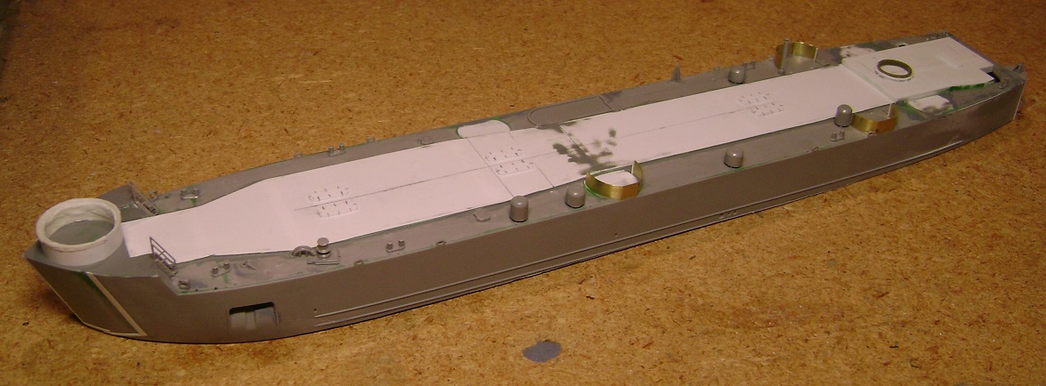

Today, we'll take a look at some more main deck detailing:
Port side view.  The gun tub forward of the conn is on its frame support, which was constructed of 3/64ths inch styrene angle and .010 x .030 inch styrene strip cross-braces.  Lifeline stanchions have also been installed around the deck.
The partially-assembled conn positioned on the deck just to get an idea how she'll look.  As I mentioned earlier, the conn superstructure is a complicated affair consisting of about a dozen or more pieces.  One has to be either very good at eliminating seams or settle for obliterating the finer details on the superstructure!
A view from starboard forward, minus the superstructure.
A view from starboard aft, minus the superstructure. The ladder for the elevated gun tub came from one of the kit's bow gun tub ladders.  Most of the topside details are installed.  Next comes painting.

Hi everyone,
Today, we'll have a look at the hull in primer.
First, allow me to thank Sean (Goodwood) for his kind words. :thanks: :thanks: :thanks: I know you're really curious about the launchers. I've been mulling over the dreaded launchers for a while and here's my plan:
There are 6 major parts of the launcher: (1) the base frame on which (2) the deflector is mounted, (3) the gate, (4) rear guide, (5) the frame, and the attached launcher (6) sub-assembly.  The launchers will be constructed using resin castings for the base frame and deflector, styrene pieces for the gate  and rear guide, and PE for the frame and attached sub-assembly.  I've already cast the base frame/deflectors and have been constructing the gate/rear guides.  Currently, I'm trying to come up with a satisfactory drawing of the frame/sub-assembly that I can submit to a PE shop to make a batch up for me.  (I'm not going to try making the PE myself � it would be a steep learning curve.) Any suggestions are welcome!  And, of course, photos to follow as I make some progress.
Here's how the hull looks in primer:
A view from port. I've started building a gun house for the fantail 5 inch 38, but I think I am going to purchase one from an online vendor.  More on that later.
Here's a look from starboard.  I won't be permanently installing the conn superstructure until much later because it will be fragile and too much work remains to be done on the hull first.
John :wave_1:

Hi everyone,
Just a quick post to show you how the model looks with the initial application of camouflage.
The model has a coat of Deck Green topside and Ocean Green for the rest of the hull.  Deck Green is a little darker than Ocean Green, but that is hard to pick up in these photos.
I only put an initial coat of Ocean Green on the conn superstructure because I still have to work on the seams on the upper superstructure before I go further with it.
Interim LSM(R)s were initially painted gray during construction but left Charleston, S.C painted in Measure 31 Design 10L. This was a scheme of the light Ocean Green, a darker green similar to olive drab, which was called Navy Green, and Dull Black.  I used WEM paints for the green colors and applied a dark grey in place of the black because I intend to weather the model to represent how she looked during the invasion of Okinawa in 1945.
The scratchbuilt fantail 5 inch 38 gun house is in this shot.  As I mentioned last time, I plan to order one from a vendor instead.
A scratchbuilt dome was built for the SU-1 radar.  Also, the yardarm on LSM(R)s 196 � 199 was cut off just outboard of the port navigation light.  This was done to give a clear field of fire to the rocket launchers.
John :wave_1:
