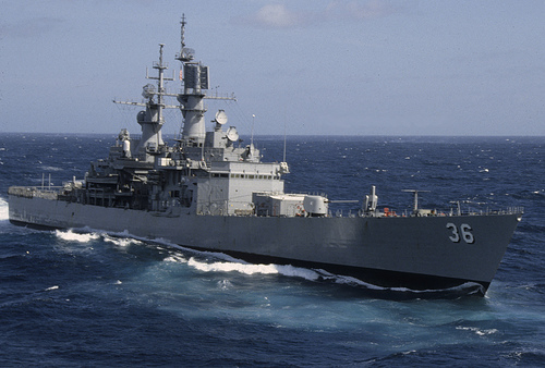

Good to see ya on here!! Here are a couple of pic's of USS California CGN36 to liven things up!
Cheers Bruce

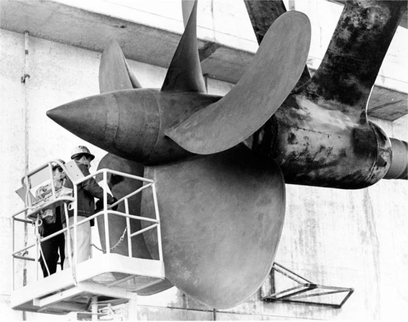

found another pic of one of CGN36's props the other day...And this one of the inside of the bridge!
