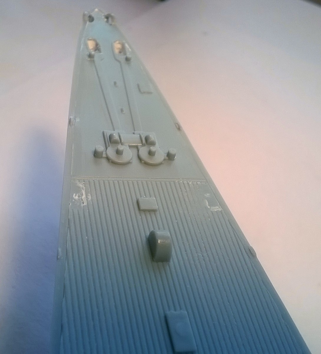

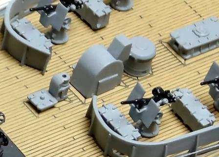

Hope someone can help here.

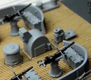

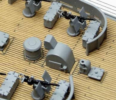

Just started an Academy Indianapolis and I was wondering if anyone could identify the following. Academy have moulded a semi-circular 'lump' on the fore-deck, as seen here -

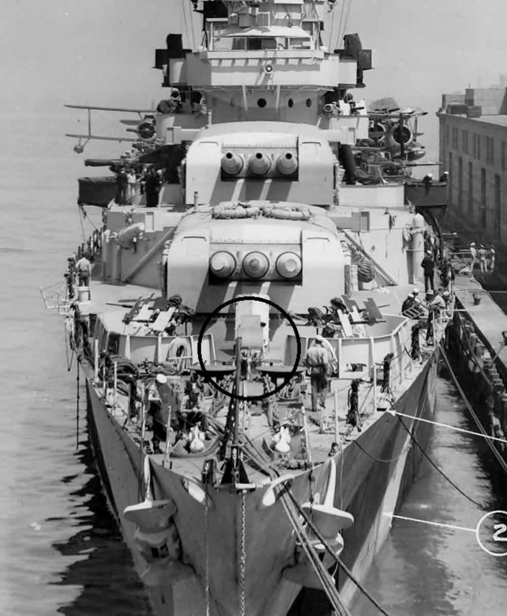

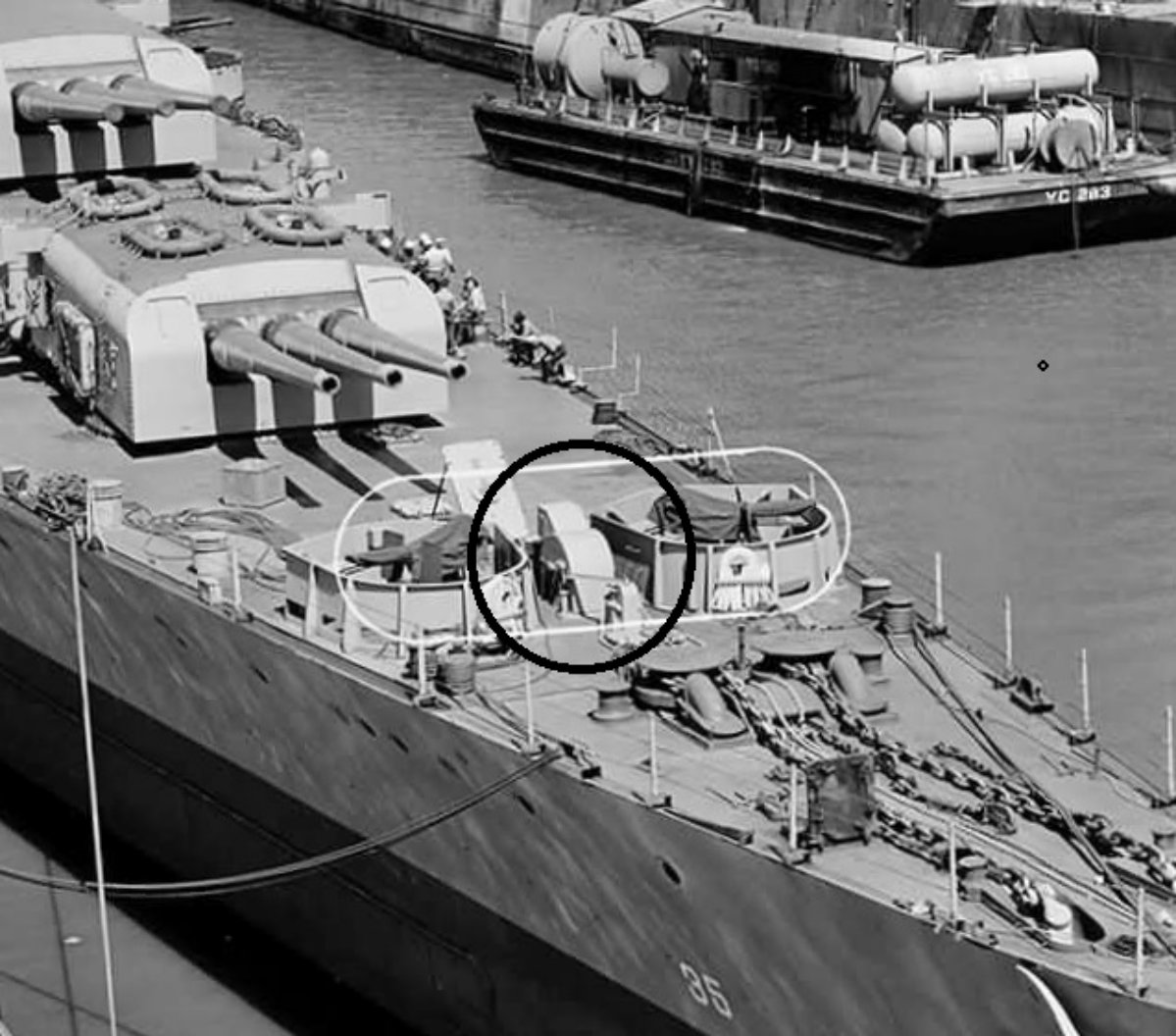

The same portion of the deck is seen below (detail taken from freely available images on the interweb) and the 'lump' circled in black.
I have checked an available plan and it MAY be an escape hatch cover.
Anyone any ideas?

Re: Calling all USS Indianapolis & USS Portland (CA) fans
I doubt that it is an escape hatch as there are three other hatches in the immediate area. It appears to be a cover over some piece of equipment, perhaps a ventilation fan, with an electrical box attached to the back, perhaps a control panel. The attached photos show the object in question on the well-detailed Tehnohart model of the Indianapolis. Unfortunately the instructions give no clue as to what the object actually is.

Thank you kindly for your swift and informative reply.
That will allow me to add a small amount of detail to the 'lump'
More info:
I looked at my set of Webb Warships Indianapolis plans last night. The "lump" is called out as an exhaust fan, which means the box with the door on the back is probably where the air exits when the fan is in operation. The entire area of the main deck forward of B barbette is shown as officer's quarters. The exhaust fan is located directly over the main officer's head and washroom.
Nice concise answer!
Yes Steve, it looks like that.
When I started to look at the real images, it reminded me of the old knife sharpening machines that were attached to bicycles that traders used when visiting remote villages and towns with!
Similar to this -
Officers toilet extractor fan!

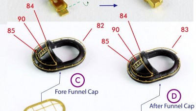

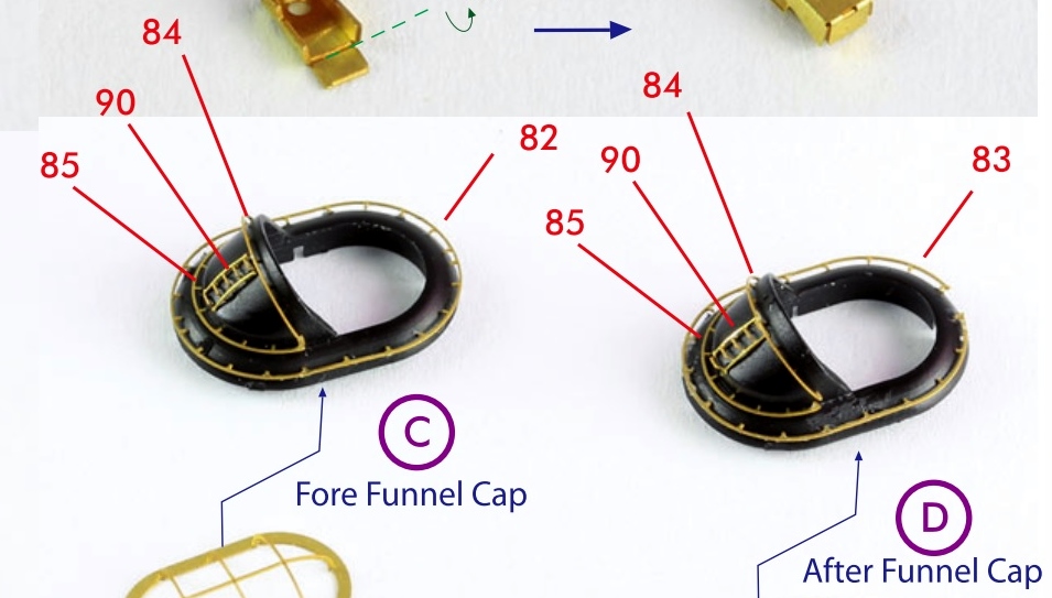

PONTOS INSTRUCTION CORRECTION
Just realized there is a minor mistake in the Pontos instructions. The handrails on the tops of the funnel caps have been transposed.
Part no's 84 & 85 should be switched.
Didn't spot it when making up the first one, but noticeable on the second.
