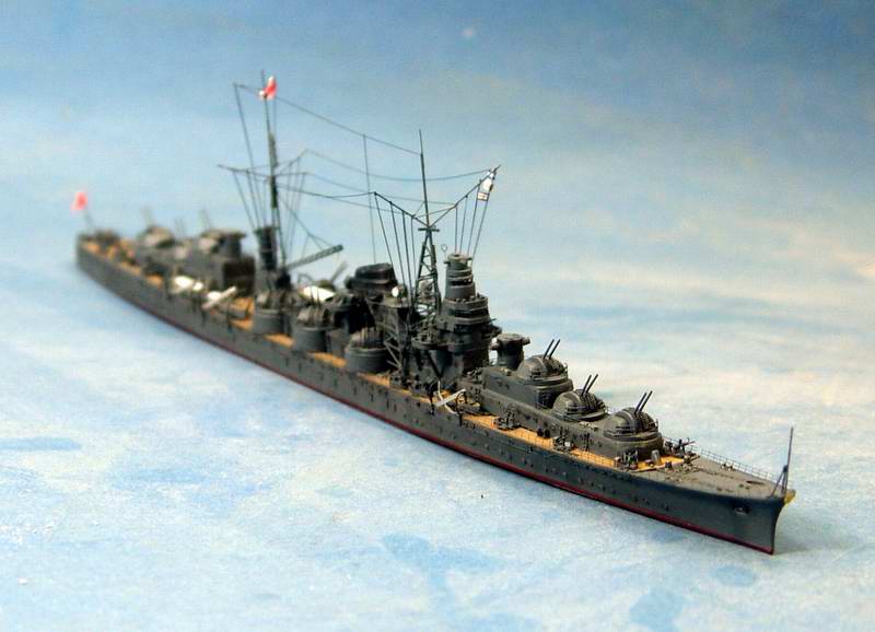

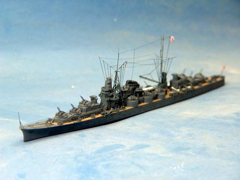

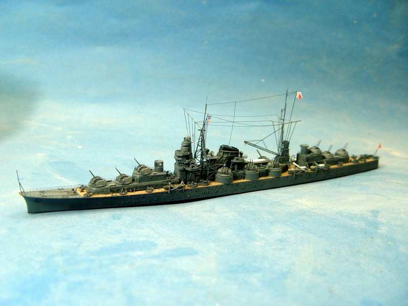

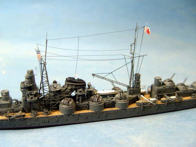

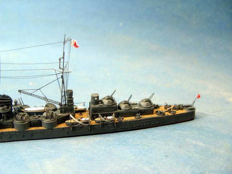

Love the Yasakuni (at least, I've seen that name applies elsewhere on the Web) - excellent detailing. I think these gunhouses work much better than the Akizuki ones I've seen in drawings

IJN could have really used her in 1944-1945. Nice concept. The type 89 12.7cm gun as the main armament sort of a IJN Dido class or Atlanta class.

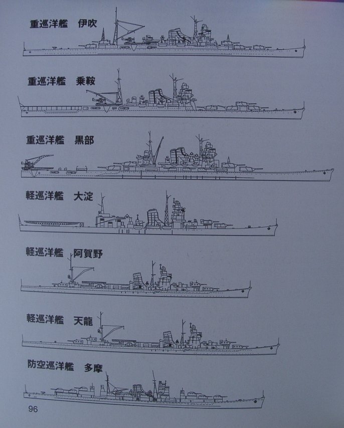

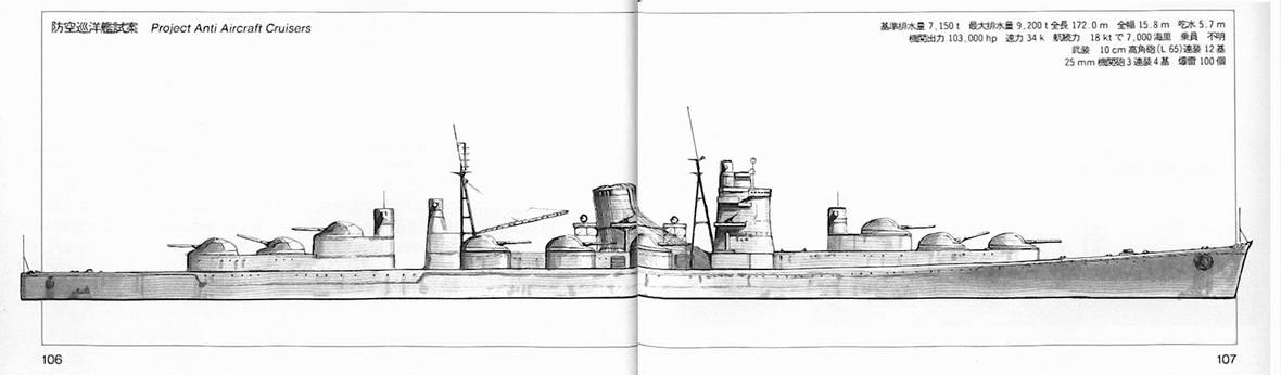

I dunno how 'real' the project was, but a diagram I found in the Interwbs described the main armament as the 3.9" (100mm) weapon as fitted to the Akizuki class DD's. Either way, the model is fantastic!

Now that's what I call a turret farm
and yet still manages to have that IJN grace about it. Nice build!

Nice, the 3 per side may be a bit heavy. Though that's a 12-15,000 tn hull, Is that a Mogami or Chitose hull? Mogami/Tone type superstructure. A late war 10cm-twin AA Cruiser would be interesting, I do like the 12.7cm/40 enclosed smoke shield turrets on this one, they look great.

The AAcruiser is base on IJN light cruiser Yahagi, and use type 89 gun.
I'm planning other one which base on Oyodo, and use type 98 gun.

Yahagi - oh - I thought it was a Mogami. The Yahagi was only 7,000tn about the same as the Atlantas, who were overweight with only 8 turrets. The Isuzu was nearl 6,000tn and only had 3. Each of those 12.7cm/40 twin turrets weighs over 20tn (the smaller 12cm twins were 20tn) that puts this ship way over weight. I thought the Mogami would be overweight with 12 mounts. Remember on the Oyodo that the 10cm/65 twin turrets were 38tn each.able wrote:The AAcruiser is base on IJN light cruiser Yahagi, and use type 89 gun.

Those aren't pre-made kits??? Well, sure they're long enough, but they have much lighter structure and are over 15� (5m) thinner, that�s about the diameter of the gun mounts. You also have to consider that each of those mounts have to have barbettes, ammo hoists & mag spaces. That�s a lot of internal volume and above-waterline weight. You might could cram them in, but you would lose a lot of space for the engines, fuel and stores, making a slower, top heavy, unstable, short range ship. - build is very good though.

I think the AA Cruiser design here is a bit optimistic in terms of what a ship that size could carry (those look like the AA Turrets from the Yamato, which would have been too heavy for Light Cruiser hulls of the IJN).
But the idea is the correct direction, at least.

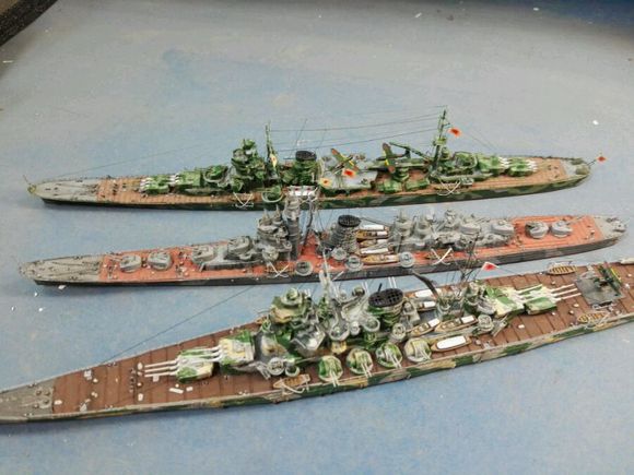

Beautiful, but not very realistic.
I've looked at what the IJN had to do to mount further 127mm DP guns on ships, and they usually had to strip a lot of other things from the ship due to the weight of the mounting.
The IJN really dropped the ball on underestimating the need for AA defense, while simultaneously demonstrating the dangers from the air.

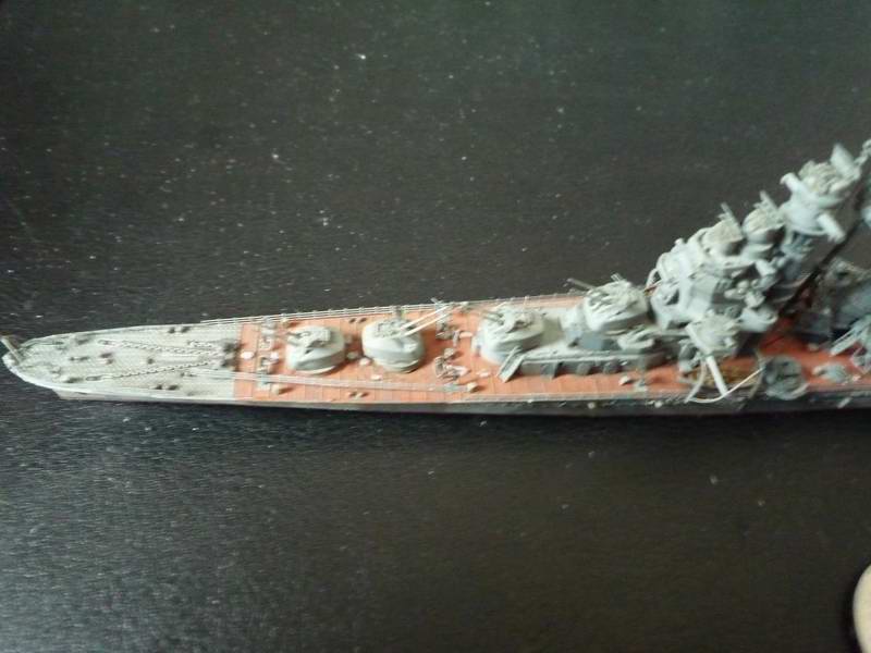

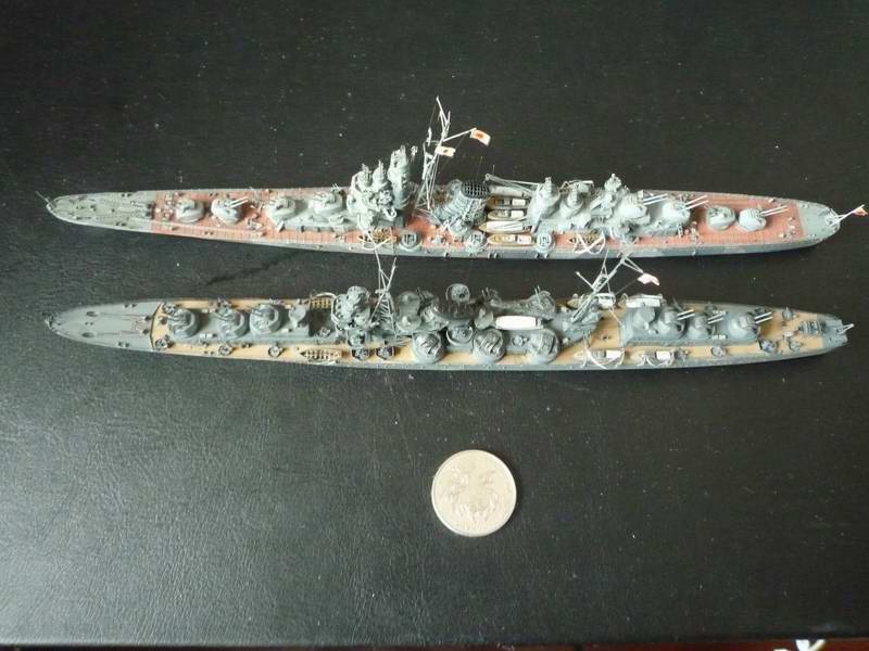

That 2nd one looks much closer to it. 4x2 10cm fore and aft. right? I would have gone with 3 (deleting the back-to-back turrets). I made a lite upgrade of the Tatsuta. I replaced her 14cm deck mounts with 4x1 type C 12.7cm/50 DD turrets (presumably removed from Hatsuharu/Shiratsuyu class Destroyers) It occurred to me to use Type B or D twin turrets but I went with the singles for weight concerns. Probably a 6 gun combination would be more likely (twin fore and aft & single amidships positions).

Ahh, what are these kits? are they available?
