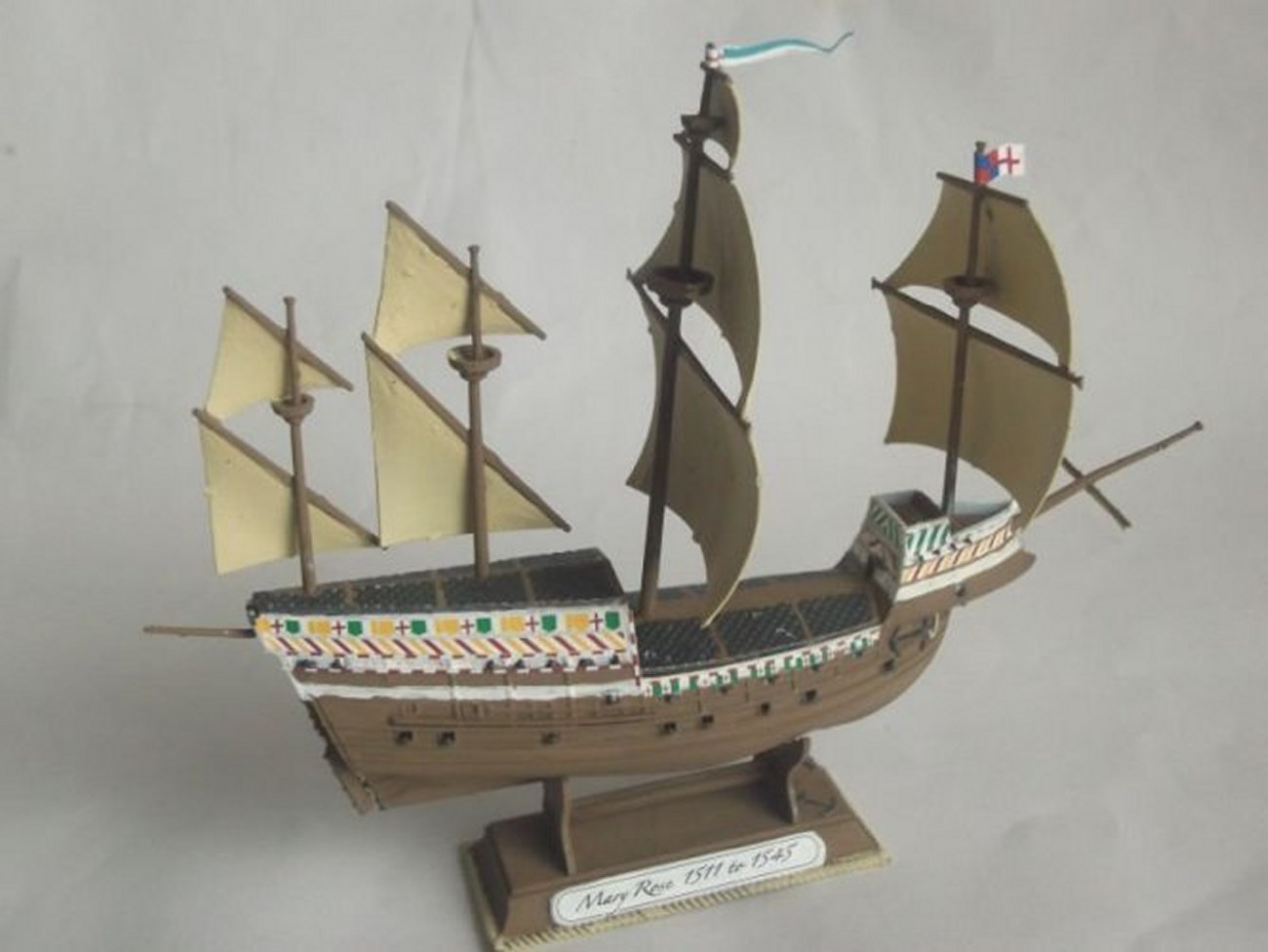

The kit out the box built... would be reminiscent of those old nostalgic Airfix models of small sailing ships of our youth, cute, but alas a bit toy-like...
( image from the internet--airfix forum)

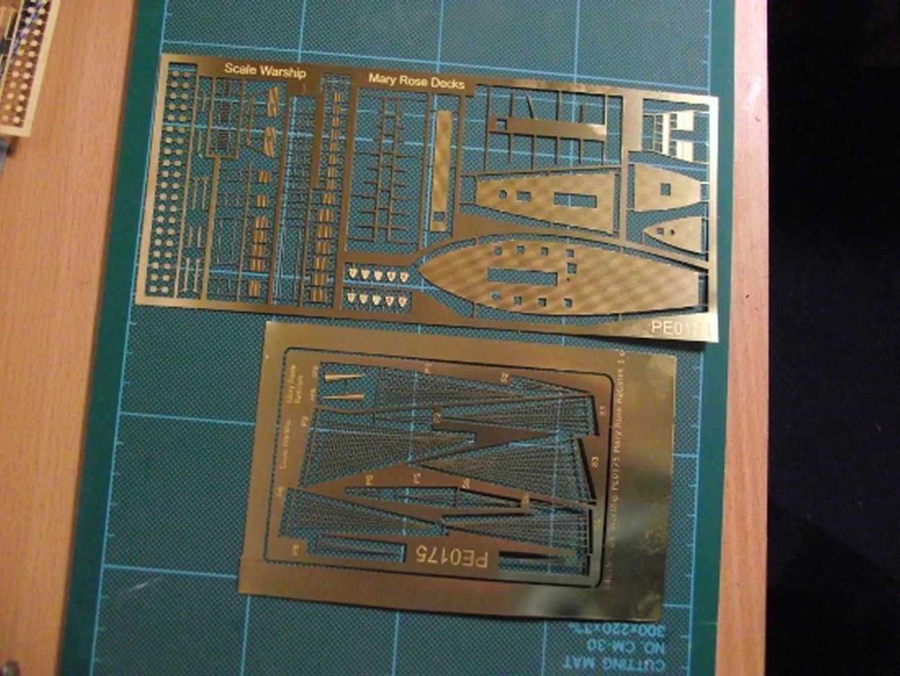

He rather usefully for me-- for this project had already developed a PE set
-consisting of decks , bulkheads, hatches -a few small parts and PE ratlines
more images of the pieces in action installed on his demo model can be seen..

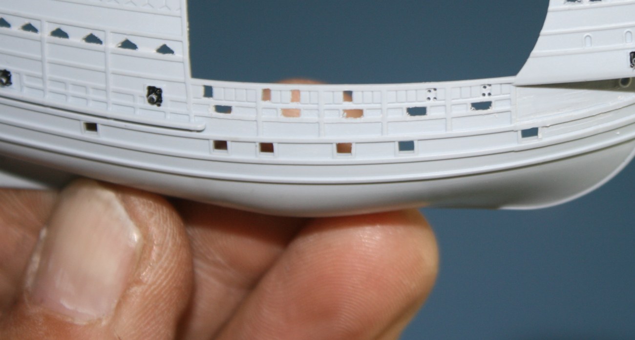

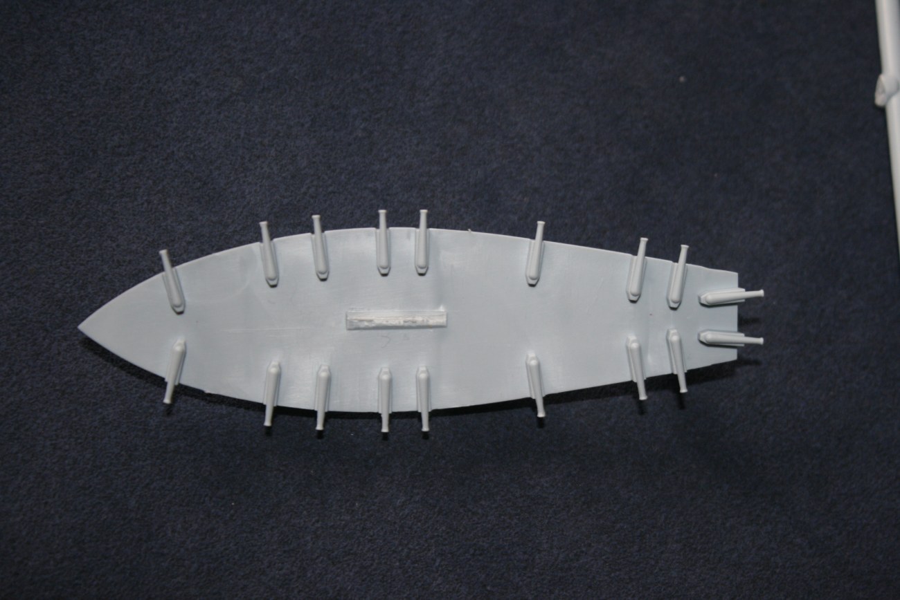

so I drilled out the muzzles of the big guns of the lower gun deck
and immediately set about opening all the archer blinds, thinning the overly thick ships sides mouldings and opening up all the holes that would have small guns or cannon poking through them !!
there were a lot of very small apertures to cut out !!
the Airfix deck was a mere curio and was discarded
I followed the instructions from scalewarship for fitting deck supports-and then deviated slightly in height, position and material..!
with a bit of paint on it is starting to pull together

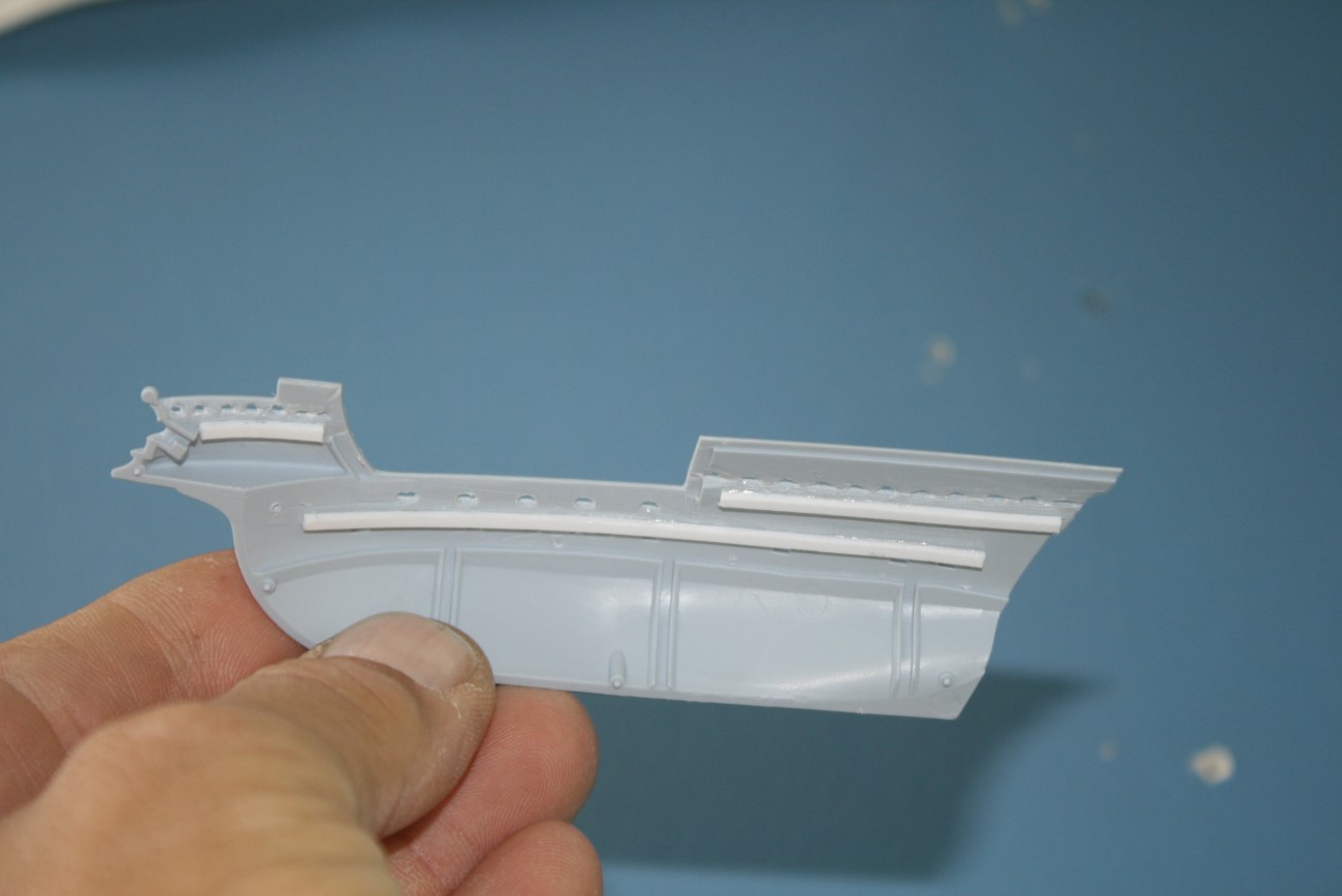

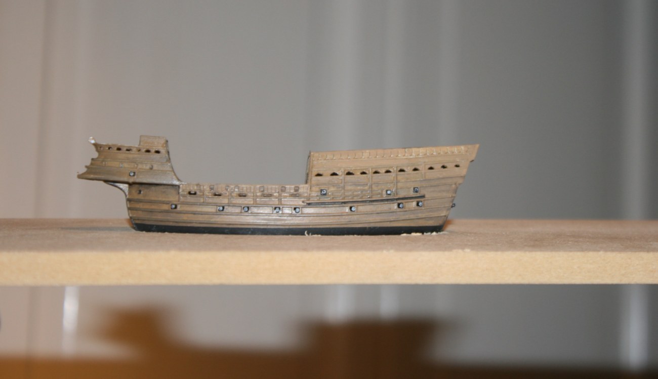

I spent some time darkening and shading the wood ( where it would be exposed)
as much of the ships topsides are fortunately covered in gaudy painted stripes and shields!
anyhow --

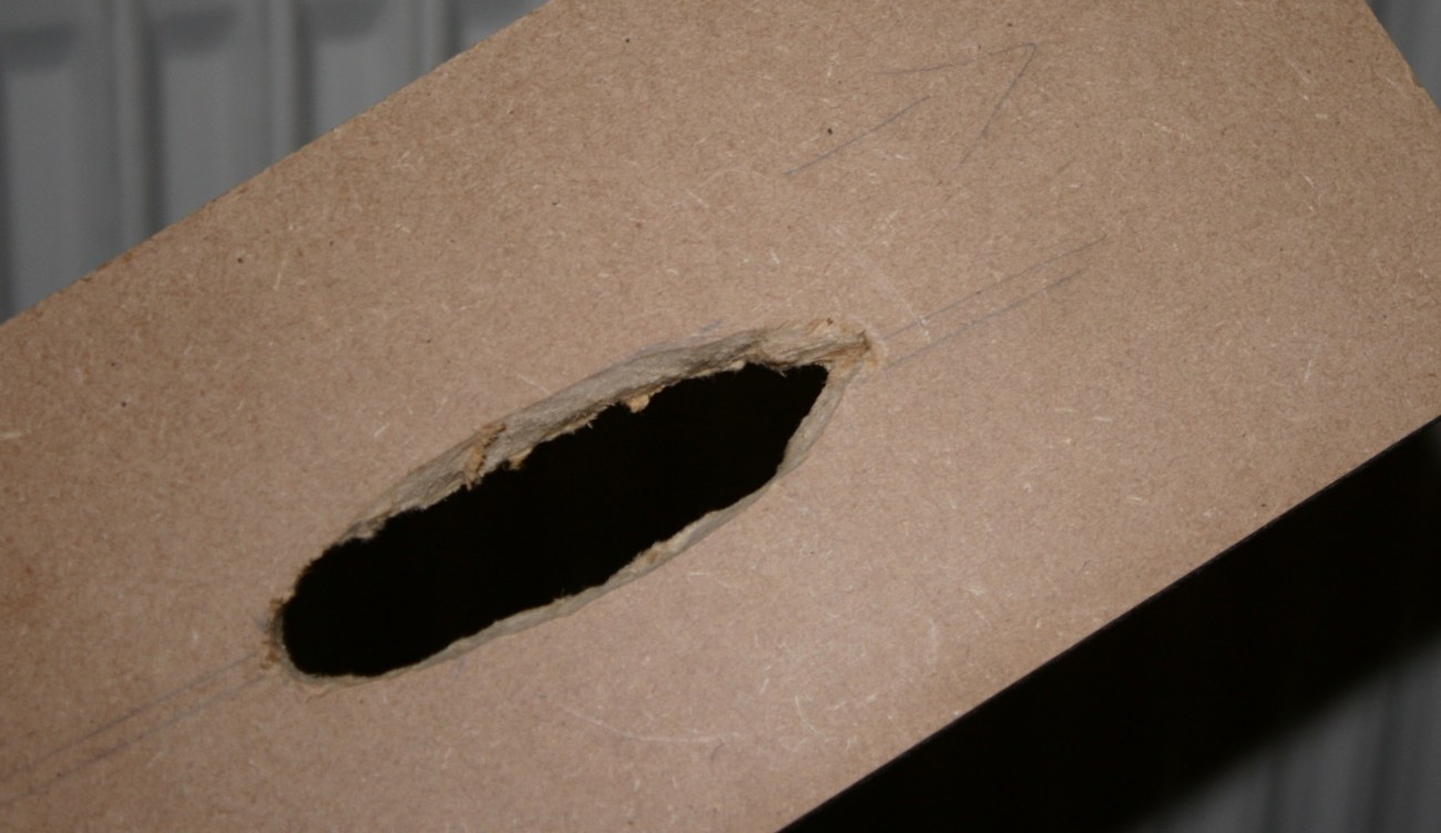

with reference to the conversations at the museum .-- it seems that the underwater was most likely treated with a pitch / tar concoction- appearing blackish -it being pre-white lead and pre copperplates
so rather than waterline the ship by cutting.
(-being a hollow plastic model as opposed to the to-me-more familiar resin casting- )
as I did not want to compromise its structural integrity for fear of the metal etch decks coming adrift during the cutting/ sanding process
I elected to cut a hole in the waterline base insert of the case.
I took some measurements using a digital vernier calliper gauge and marked some offsets on the baseplate
the cutting could have been more accurate..(!) :big_grin: but it was good enough!
--rather than the more usually depicted vessel-on-a-square run,
I have decided to set the ship with a small bit of heel on a broad reach
( but not this much!!!! )
-as that would mean having to close the gunports--which would make the model less visually interesting )
nothing is glued/fastened as yet
but the initial feel is to my liking so far!

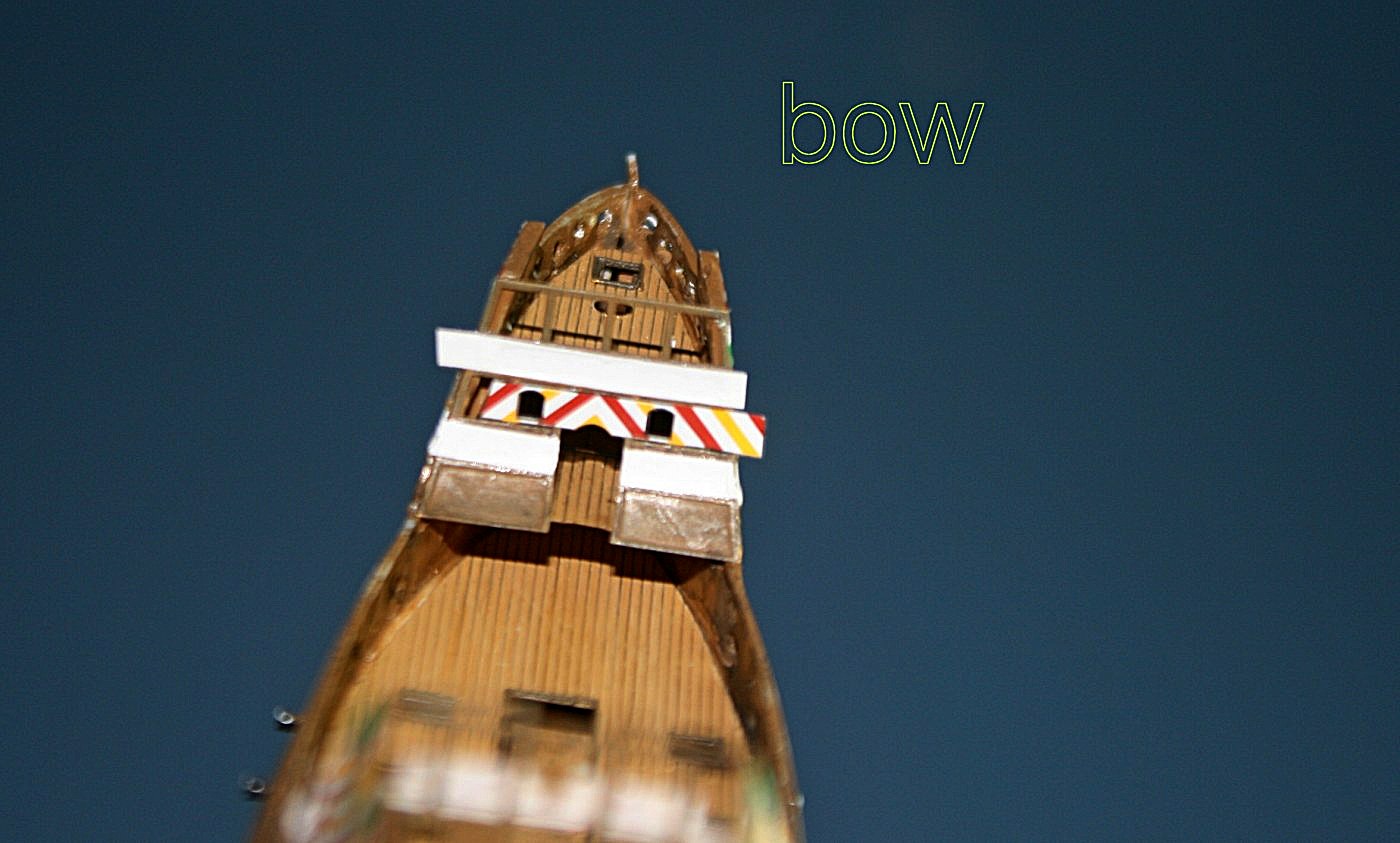

The delightfully gaudy nature of ship of this era was well assisted by the, on the whole-- excellent decals..
However I found that the decals were in places rather short in all sorts of areas--especially with the new PE decks meaning that some parts
were now exposed that would previoulsy have been covered by the " netting" deck insert...
==> I simply bought another kit and robbed it of the decals ( cheap enough at � 5.99 )--
with benefit my daughter ( 10) can build the kit out of the box in wood natural... :big_grin:
decalling progress was swift-
the plain white areas I used the really excellent TL-decal strips ( from Germany)- albeit with lots of decal softener.
but a lot of fiddly cut-and shut splicing of the Airfix decals --usually cutting on a diagonal joint
luckily the second sheet was of great help, with adding additional sections in
T the whole ship tapers and narrows in all sorts of directions !!
My plastic cutting was not as good as I thought it seems...
much improved once I pulled my finger out and upped the game!
more progress shortly !
