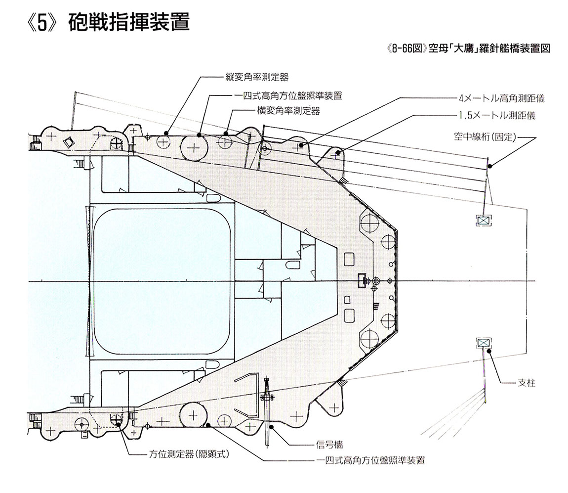

the compass bridge deck is open aft the window structure. I now realize why that modeler did what he did. He probably mis-interpeted this overhead illustration of Taiyo's bridge.
The opening is quite clear in the beam view of Taiyo.

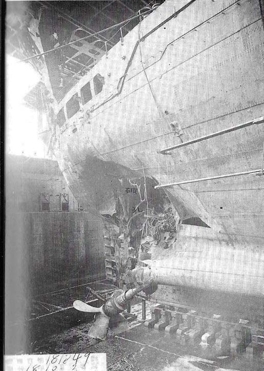

Theses photos of Taiyo are dated October, 1942, and are from the Shizuo Fukui volume on IJN CVs, part of his 3 vol JNVI set. The picture quality is not great, but neither are the originals. There are also some pics of the flight deck and, most surprisingly, the deck does not appear to be wood planked. It's covered by some non-skid surface; it may even be linoleum (my guess.) This is much earlier in the war than I would have expected, though these sisters were really just glorified aircraft ferries.

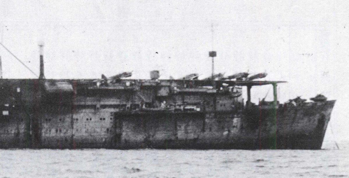

Well, I have to say that I am a bit stumped on this one. I've been through all my references but one (I'll look tonite), and while it's clear that Chuyo has both Type 94HA and the smaller 25mm MG directors, it's not all clear for Taiyo and Unyo. In fact, I can find no trace of a director usually associated with the 12cm mounts. No sponsons for same. It is possible that the 25mm MG director are located forward close to the bridge, in the catwalk/sponsons to either side of the flight deck.
The photo below is of Unyo in Feb, 1944. (It is often mis-identified as Chuyo, who suffered very similar damage from a torpedo. However, if you look closely, one can see that the bow is actually gone, and the forward flight deck has collapsed all the way back to the forward large caliber gun sponsons and the bridge area. Chuyo's damage was further forward.) Admittedly, it's not the clearest photo, but this is the best version I could find. There are no large sponsons that hold large directors.
I can't really say why this omission appears to exist.
