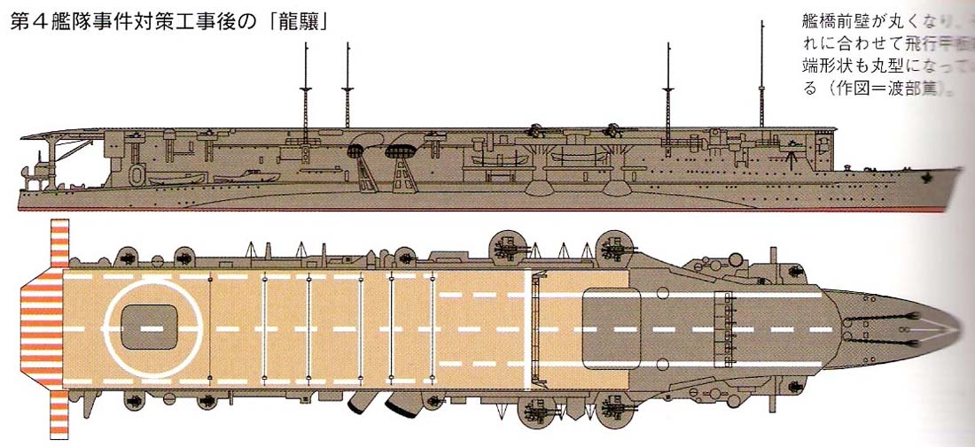

I'm building Aoshimas Ryujo as 1942 Version with the great pe parts from Tetra Model Works.
My question is, they supply two decks for the bow of the flight deck, one in wood, and one in steel.
I saw pics of the model with a steel deck, but Aoshima make a all wood flight deck.
Someone knows which one is correct?
Greetings Christian

Posts: 9128
Re: Calling all IJN Carrier fans
Post by Dan K »
I'm not sure. Not enough information available. However, the Gakken IJN perfect guide favors metal:

ch hoeltge
Posts: 359
Post by ch hoeltge »
Thnaks Dan, I went for the metal deck.
As said the pe set is really great :D

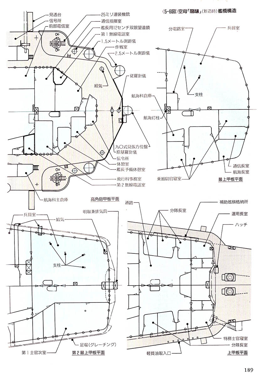

Posts: 9128
Post by Dan K »
Looking very good.
According to this illustration, there is one 12cm binocular mount on each side.
ch hoeltge
Posts: 359
Thanks again Dan.
Sadly this platform isn't anymore on my ship. It was removed during one of the refits.
But I can try to put it on the deck behind the original position.
