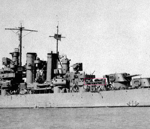

I am including a link to the photo I am posting below, because the link allows for a much larger, detailed view of the image.
http://www.navsource.org/archives/04/049/0404935.jpg
But what are those things that I have the red and purple boxes around in the attached image?
This thing looks like a railing that is REALLY THICK. It runs from the thing in the last photo (with the purple rectangle) to the aft sides of the 1.1" tub bulwarks P/S.
Here is another view where I have drawn a line through the thing in question:
And the last thing is some "structure" that the thing in the first two photos looks like it is attached to (unless there are ladders at the end of the superstructure that interrupt that "railing" before it actually gets to this little "tower").
But what the heck is that thing?
MB

Matthew, I am not sure what is lashed to the top of the rail, but the object boxed in purple is the stack for the diesel generator.
DrPR
Posts: 1689
Re: Calling all USS Brooklyn/Helena class (CL) fans
Post by DrPR »
The "railing" you lined through appears in Navsource photo 0404931 (US Navy 1197-3-42) of the St. Louis. Instead of a railing this may be a bulwark - a low bulkhead that serves the same purpose as a railing.
Very high resolution images (80-90 Mbyte) of the St. Louis in the Naval History and Heritage Command Ship Photography collection show what appears to be a solid bulwark here (19-N-54226 16 Oct 1943). 19-N-28229 (6 Mar 1942) shows something like a spar or boom in place of a bulwark - similar to what you show in your picture. The vertical black streaks in your picture could be anything hung out over the spar.
These images are much, much, much higher resolution and quality than the Navsource images. Just go to the naval heritage web page and search for "USS St. Louis" CL-49 - be sure to use the double quotes. You can also search for any Brooklyn/Helena photos.
The "thing" sticking up at the after end of the after superstructure, just forward of turret #4 looks like a diesel generator exhaust. This is really apparent in 19-N-28229. The Clevelands were similar in construction to the Helena and they had an emergency diesel generator room aft of the after engine room. The exhaust pipe from the generator came up near the after end of the aft superstructure.
I have attached clips from the high resolution photos.
