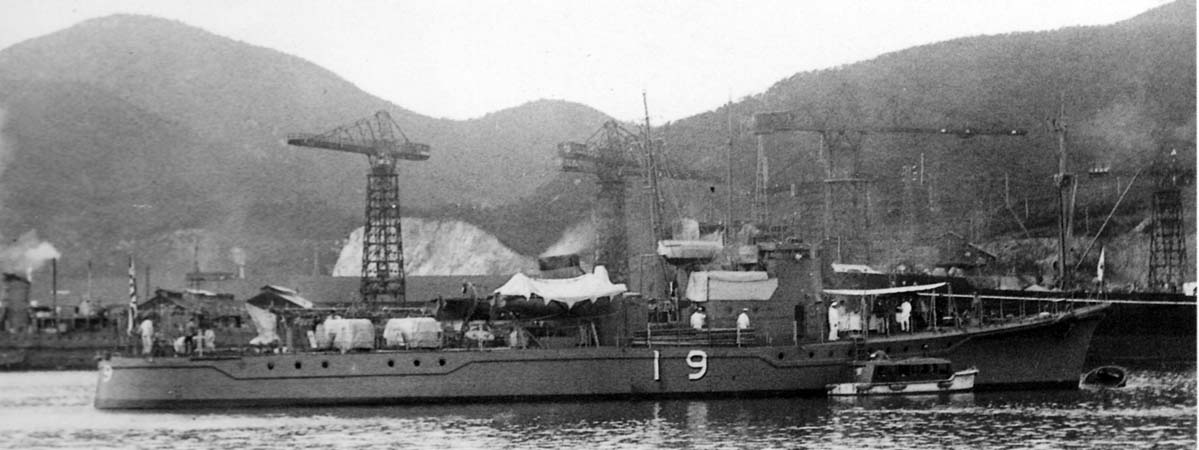

Some pics, in order:Type 13 #25, Type 13 # 19, Type 28 # 51, Type 28 # 52

They also all look like they are wearing degaussing cables, even in the post-war photos.
I thought the Japanese began removing degaussing cables when they proved to be of little use (or do I have that wrong?)?
And the cable on the No.13-class ship (#19) looks wider than on the other No.28-class models. Is that the case?

I doubt the degaussing cable on #19 is any wider than the others. The degaussing cable was found to be ineffective by 1943-44, but that didn't seem to stop the installation of them, at least on smaller vessels.
