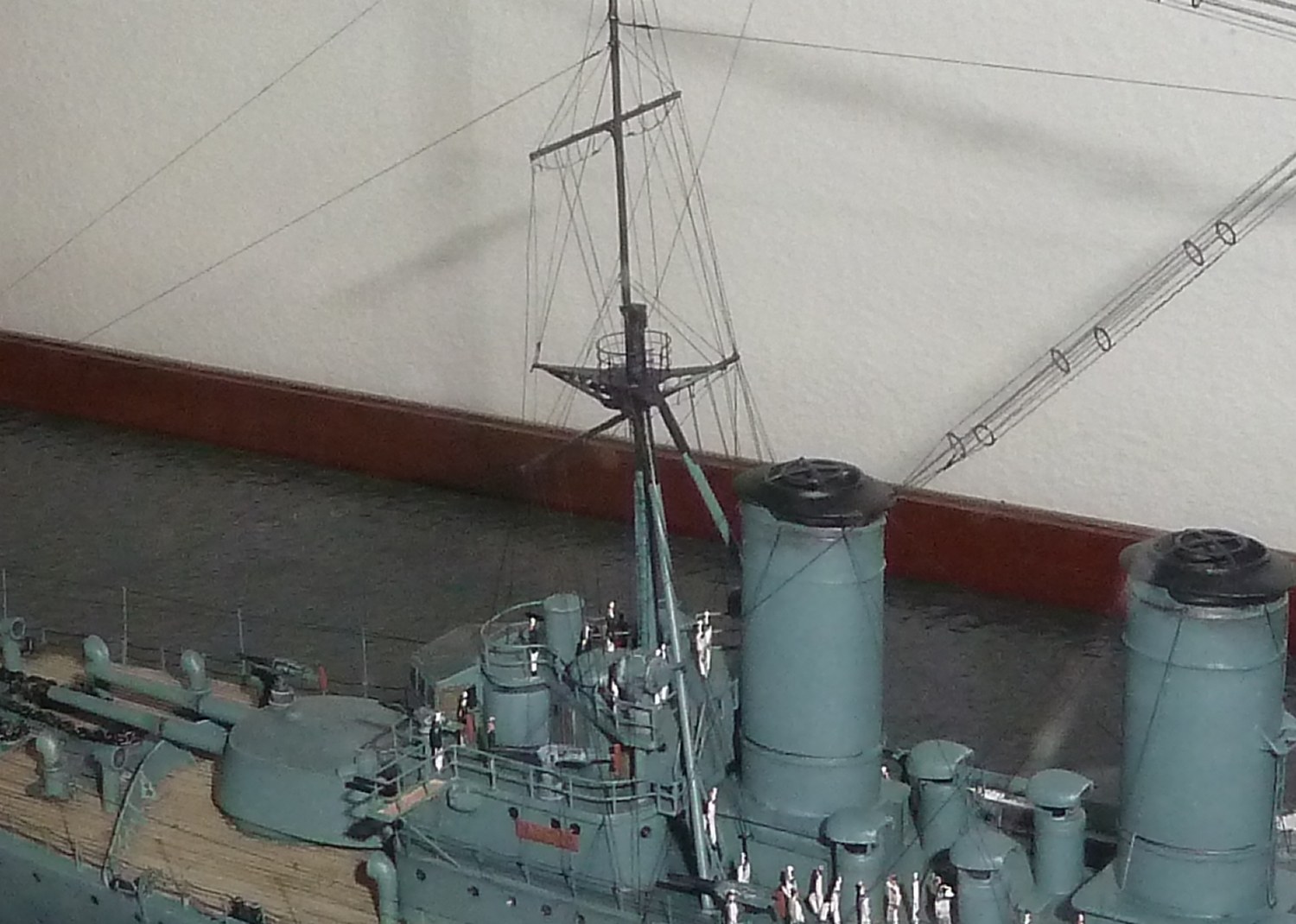

Can anyone give any tip or technics for make the rigging in the horizontal masts as you can see in the attached photo?
I tried small wire and thread, but doesnt work...
Sry for the bad photo, it is not the best but is very clear to show what I am looking for.
Thanks in advance

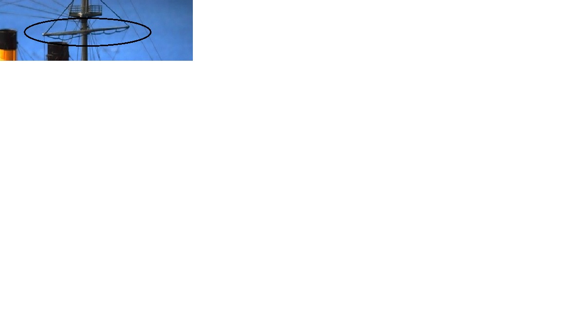

It sounds like you're looking for ways to do footropes?
- JIM BAUMANN
- Posts: 5689
Re: Rigging on horizontal masts
For footropes use stretched sprue. much finer and thinner than PE
Have a read here
link ==> viewtopic.php?f=4&t=37536
1)Form a long loop fromend of yard arm to centre mast( or on some ships beyond to the inboard end of the yard other side of the mast)
2)in the centre of loop attach the vertical with Revell contacta glue ( see above link for technique and use)
3) once the glue has softened the loop--pull the vertical upwards and ikt will make a neat kink - glue to the yard arm with the Revell glue.
repeat as many times as needed --each time allowing the loop to kink
needs a bt of practice...
see examples below in 1/700 amd 1/350

Thank you very much for your help and information.
Yes, I was talking about footropes, bt didn�t know this word...
Now, time to proceed with then on my models.
