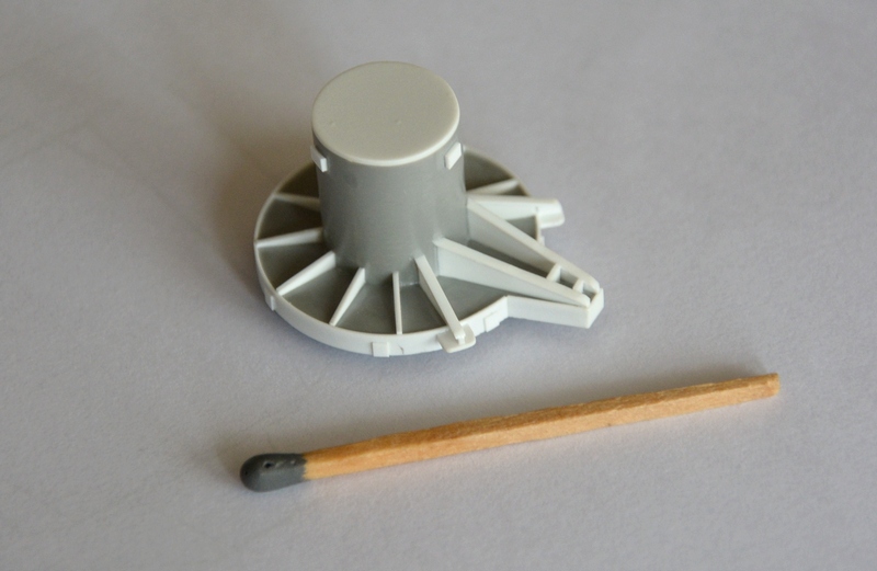

What Revell offers is not much:
It will be noticed that the director trunk is the earlier, longer one, that has to be cut down, and that the general detailing is quite poor again, so all the details have to be erased too.
The main problem with Revell�s director is that it has got two cuts at the rear that do not correspond with the model to be built, as can be seen in this pic of USS The Sullivans, that had the rear of her director perfectly straight:

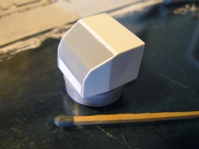

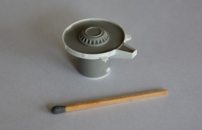

As the thing had to be modified in depth, instead of making a putty mess I preferred to cover the whole structure with styrene; the antenna poles were long to build, but not difficult at all:
The blast covers are made with Evergreen and stretched sprue rings, carving them with X-acto blades, files and fine sandpaper. They are not identical, as this is not necessary nor convenient because the real ones were not either after being set in place and moved by the wind.
So it has started like this, minus vertical ladders and fine detailing:

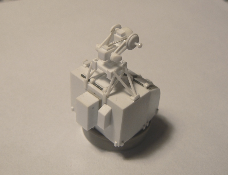

And then a couple of pics of the Mk.37/22 already finished minus the circular antenna. The wiring at the back, that will be done with stretched sprue and will be quite fragile, will be set after the final paintwork so that it will not interfere with the brush and break.
It lacks the antenna, but I am not sure yet what model Jorge Juan displayed in the mid 60�s, the moment of her service life I am trying to reproduce.
Brgds,

Posts: 3879
Re: Work in Progress: 1/144 Jorge Juan (ex USS McGowan)
Post by Rick E Davis »
JORGE JUAN would have still had the Mk 25 radar on the Mk 37 director in the 1960s.
Jabberwock
Posts: 502
Location: Inverness
Post by Jabberwock »
Willie wrote:Hi all again, folks,
Brgds,
Willie.
THIS is modeling!
Cheers, Jabb

Brett M
Posts: 297
Joined: Thu Dec 23, 2010 5:00 pm
Location: Salt Lake City, Utah
Post by Brett M »
Wow, that director looks AWESOME. Nice work, this ship will look great.

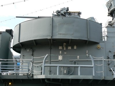

The upper position fort the aft 3in/50 Mk27:
The initial element, with everything that can be used in the kit plus the first modifications, is this:
The previous pics onboard USS The Sullivans will allow to detail the beams to perfection. It is necessary to notice --and I didn�t-- that these beams are not all of them the same shape and are not evenly spaced. The process is very simple, but time consuming, and unnecessary to say, I had to do it twice, until I managed to produce this :
With the available pics the superstructure and the director platform were very easy to make:

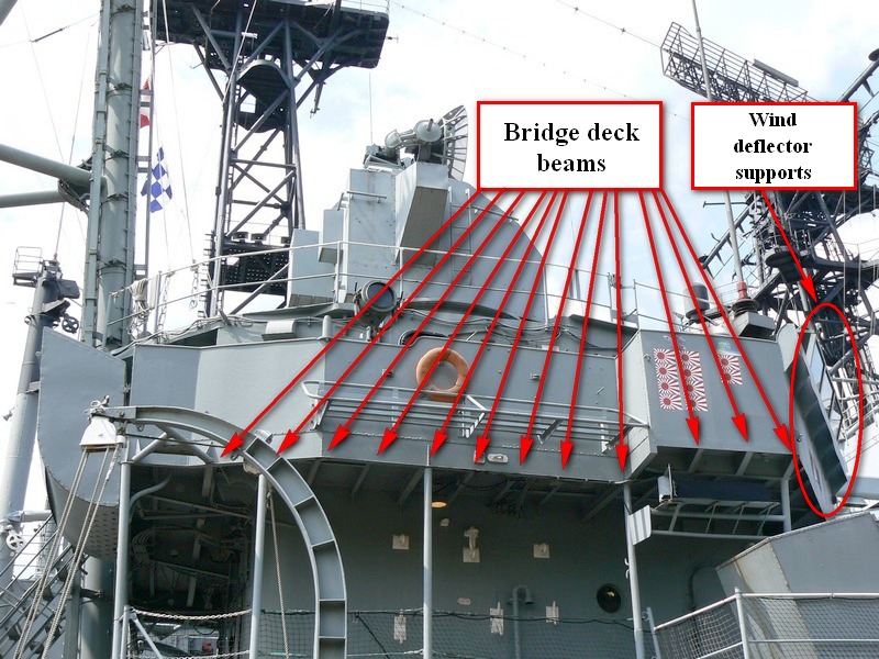

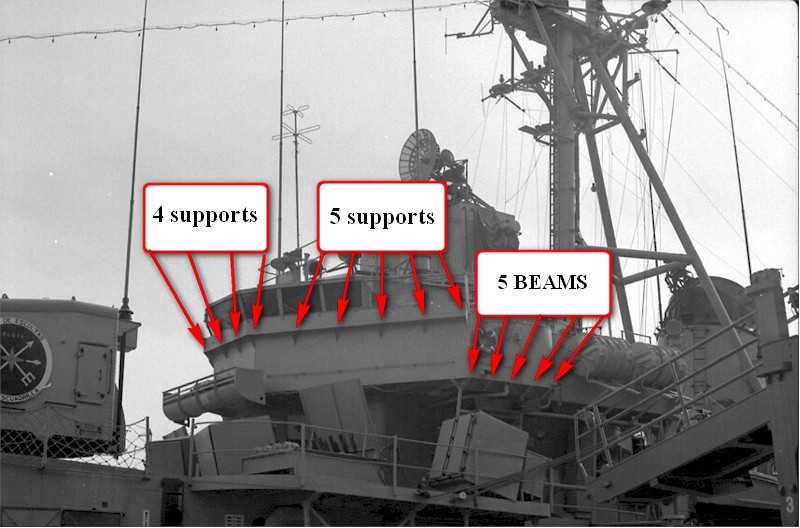

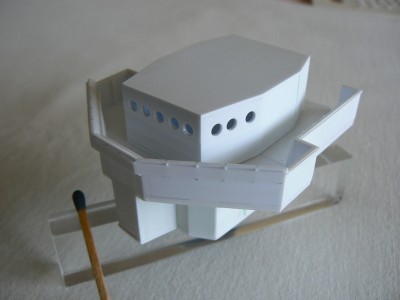

Once I was finished with the basic structures, I got involved with the bidge structure. According to AOTS and my own Buffalo photo album at USS The Sullivans, this is what has to be done:
The basic supporting structure of the bridge is the common one to all square bridge Fletchers. As a very welcome help, I used the round bridge structure of the first Fletcher series that the Revell kit offers, as the height is correct. The length of the final block is 1.5 mm. too long, but considering that the hull is virtually 800 mm. long, this is acceptable for me, or at least I can live with it.
Once the first block was finished, I went on with the bridge deck, using as a guide a 1/144 deck plan that I had drawn before with all the structures that had to be built. This deck is quite irregular, as it can be seen:
With, again, lots of file and sandpaper I was able to produce perfect bulkwarks, with no open seams and no need of putty. I was very happy and the structure itself was like this :
Everything was OK until I noticed that both the pics and the plan corresponded to USS The Sullivans, and I am actually building Jorge Juan, that, as her sister ship Alcal� Galiano, had a different bridge deck plan, with straight lines. Here Jorge Juan with straight bulwarks:
The difference is not big, but it is there, and it is obvious enough as to need to discard the element and to build a new one. Patience is something that we modellers have got in great store. Double work, double fun...
This structure is obviously way more simple, and with straight bulwarks, what makes things easier.
When both are placed together, the difference is obvious::
The bridge block is made with independent deck and ceiling, both cut in 1.0 mm. Evergreen plank to give it strength, and closed with Evergreen stripes in several widths to give it the necessary height.
Closed and complete, the pilot house is now like this:
It is a very easy process, but somehow boring. I hope you like it anyhow.
Brgds to all of you from this side of the North Atlantic,
Willie.[/size]

Hi all once more,
After completing thie pilot house, I started the detailing of the structure. As it is big enough, it allows making things that would be way more difficult to achieve with bigger scales, as the deck beams again.

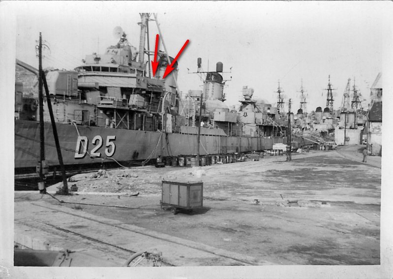

I have got only e few pics of Jorge Juan herself, so I had to use the USS The Sullivans album. This is what has to be done:
There are again differences in shape and length in these beams. The pics are very detailed and of precious help, but they correspond tho USS The Sullivans, not Jorge Juan, and a pic of the last reveals substancial differences in the wings beams and the supports of the wind break:
The beams can be done without further trouble using Evergreen stripes of several thickness, although I had to modify some of the profiles. It is very, very, very boring, as the pieces have to be cut with absolute precision, but the process is extremely easy.

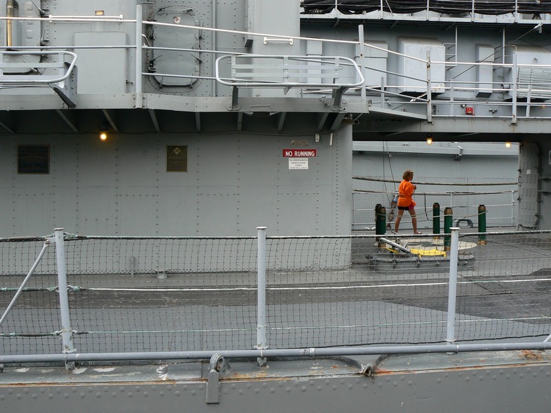

The wind breakers were a good headache, because they are curved in shape, and in very visible position:
I was looking for a suitable profile for some time, kind of yoghourt container or alike, but without success, so I had to look for elsewhere. I realized at last that as the outboard part will be almost invisible due to the vertical part, I could make the windbreaker with an oblong section, not necessarily curved, and file and sand the inboard section until the suitable curve is achieved, what will have the side effect of very easy supports for the outdoor plates. This is what has to be done:
As it can be seen in the pics, the split between the board and the windbreaker will be covered by the kind of tubing that links both elements. It is now like this :
The supports for the bulwarks are made according to the pattern that Alan Raven offers in his superb book Fletcher-class destroyers, pag. 87. :
The vertical plates of the windbreakers are placed a bit lower than necessary. It would be very easy to have placed them higher by making the supports wider, but I made a couple of tests, and they were not very satisfactory, as it ruined the general profile of the bridge; so I had to lower it roughly 0.75 mm. so that the split could be seen without disfiguring the general outline. Once the pilot house is set in place, the general effect is very realistic as well:
And I think that with this, the bridge is ready for more intrincate detailing.
I hope you like it, and warmest regards from this side of the North Atlantic,
Willie.[/size]
