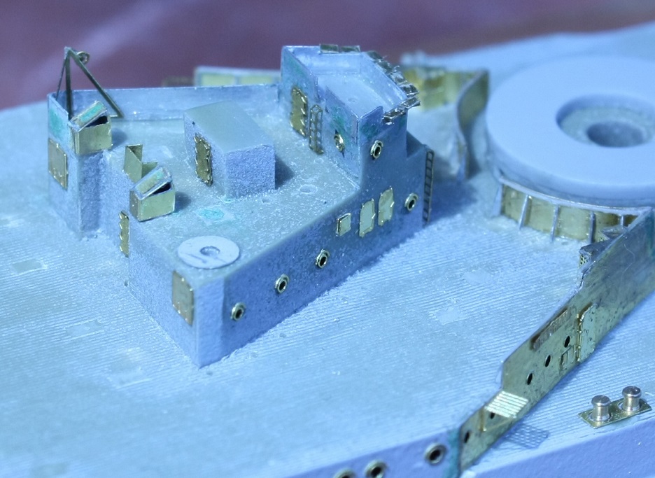

I went on to detail the after superstructure. In the Profile Morskie plan there is a structure on the aft end whose outline is not confirmed by any other source. Therefore I didn’t accept if and came to a solution which is mix-match of information from various sources and probably not correct at all, but I just couldn’t do any better from what I had. I cut off the bulwarks deeming them too thich and replaced them with aluminium sheet. Sanding them flush with the sides of the superstructure was tedious.
I embellished the superstructure walls with everything necessary
