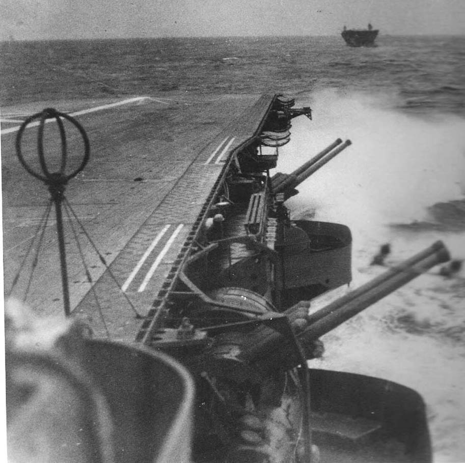

Another observation:
On Katsuragi, the aft deck end white (and red?) stripes show up nicely in this shot:
The camouflage pattern of the deck seems to continue right through these stripes however?!
Did they try to overpaint the stripes to make them less conspicuous, accidentally or on purpose letting them still shine through?
On Amagi, something similar seems to be the case.
On photos, her stripes do show, but seem rather vague. Also, the remains of some other patterns seem to be running through them.
They are a simpler strait pattern instead of the chevrons on Katsuragi.
This is how it looks like in the color movie:
They are present, but look quite green!
Overpainted, but still showing through is my best guess?

I don't know about you, but I am WAY past that point on my tanker builds. I'm becoming a bit ridiculous about it, to be honest.Just tell me when we have reached that point, ok?
IJN flight decks were ringed with metal plating covered by treading. The wood did not extend right to the flight deck edge. The width of the this strip varied by location, and class. Also, the edge of the flight deck had rain gutters attached to it.
Unfortunately, I do not have a photo of any Unryu type that clearly shows the treading. In looking at some of the more clear Amagi photos, I do wonder if the treading portions were ever applied. Seems like those would throw small shadows and be more obvious. Of course, the camera just may not be close enough. The Amagi close-ups at the stern do show the rain gutters, though.
Here's the classic shot of Zuikaku's flight deck with the treaded metal plating and rain gutters:

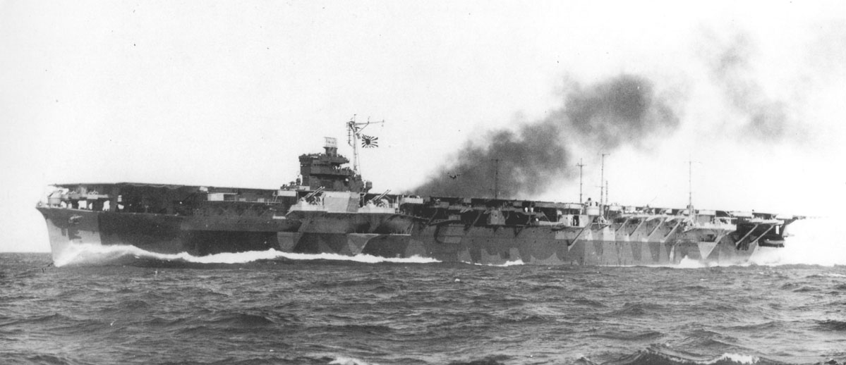

I'm wondering about the radar on top of Amagi's (and Katsuragi's) islands at the end of the war.
These 1944 photo's show type 21 at that location, just like all publications state they were equipped with when built:
Amagi:
Katsuragi:

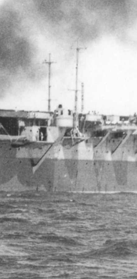

But The 'thingie' on top of Amagi's island after the war doesn't seem to be part of that, and it also doesn't looks like type 22:
This photograph, taken from the upper hangar deck of Katsuragi, upwards through the hole in her flight deck, shows what I think is the same 'thingie', but now with some extra 'spikes' and it looks more like a radar antenna:
I think the single 'pole' on top of Amagi's island is the exact same type of antenna, but stripped down after the war?
But which type is this?
Marijn
- Posts: 9128
Re: Calling all IJN Unryu Class CV fans
Yeah, both Amagi and Katsuragi had their Type 21 radars replaced by type 13s, and, for a while, a Type 22 as well. For Amagi, I'm guessing it occurred during her March 1945 dockyard visit.

I only wonder whether the drawer of that illustration hasn't been a bit fast with interpreting it as a 'regular' type 13 antenna:
- On the photo I posted of Katsuragi, the antenna is visible next to the type 13 on her mainmast, and they look rather different in detail.
- Also, it has a pyramidal base which isn't present on the illustration. That base was also not there when Amagi had it's type 21, so it seems specific for the new antenna.
- The 'spike' which remained on Amagi is much shorter than the type 13 on her mainmast (see pic with red circle). But of course I don't know whether this 'spike' ran all the way to the top of the antenna or not...
Maybe it is a type 13 radar indeed, but with a later type of antenna (maybe smaller and cheaper?)?
That would be possible indeed. The type 13 on her mainmast was still present after capsizing, making it a bit strange that the radar antenna on the island would be missing due to damage.ijnfleetadmiral wrote:Not to mention that towards the end of the war, a lot of the ships were being stripped of AA guns and radar sets for use elsewhere on the mainland. Not a far stretch to consider that this applied to Amagi.

One more thought about her radars:
The wiki-page on Amagi states that the other type 13 was located 'on the aft starboard retractable radio mast'.
The photo below doesn't show any trace of it however. Maybe it was detached after (or closely before?) her sinking, and maybe the antennae on top of her island were too? Or maybe it was removed during the march refit and replaced by a new antenna on top of the island? Or maybe they all fell down due to the bombings (but that seems a bit unlikely to me)? Or maybe the wiki page is simply incorrect on this point (imagine that!
Any thoughts?
Marijn
That's clearly the one, so type 13 it is indeed!
That would be quite likely indeed I think. This shot of her being attacked at 19 March vaguely shows something spiky on top of the top rear of the island, with a smaller item just in front of it. That might be already the type 13 and type 22 in place. The resolution is of course insufficient to be sure, but it doesn't look like type 21 to me�Dan K wrote:For Amagi, I'm guessing it occurred during her March 1945 dockyard visit.
Any thoughts?
Marijn
- Posts: 9128
Seems like a typo. A second Type 13 was usually mounted on the port, forward aerial mast, facing aft. Katsuragi had one. Amagi's is probably buried in the mud.
marijn van gils
- Posts: 2770
- Location: Belgium
That clears that up too�
Many thanks Dan!
