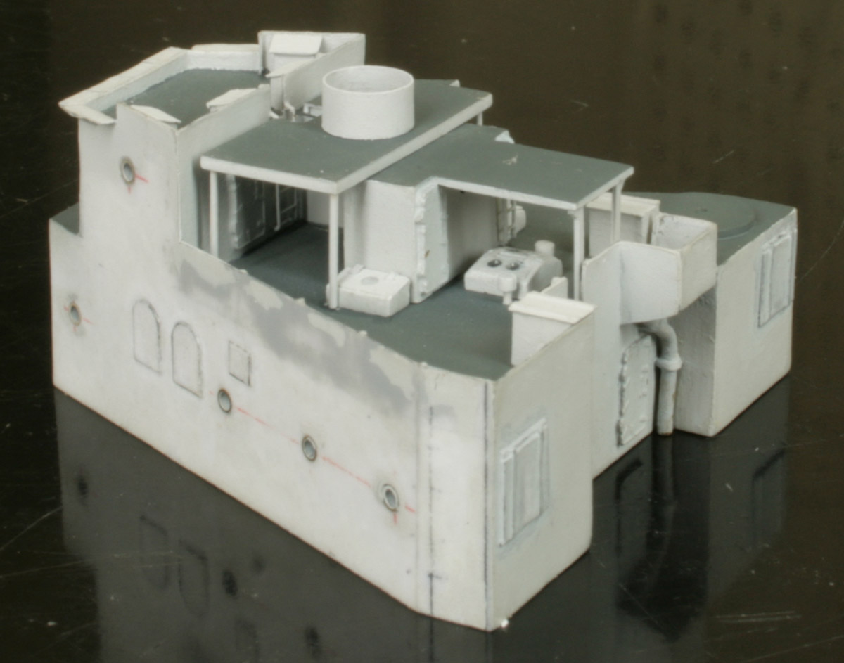

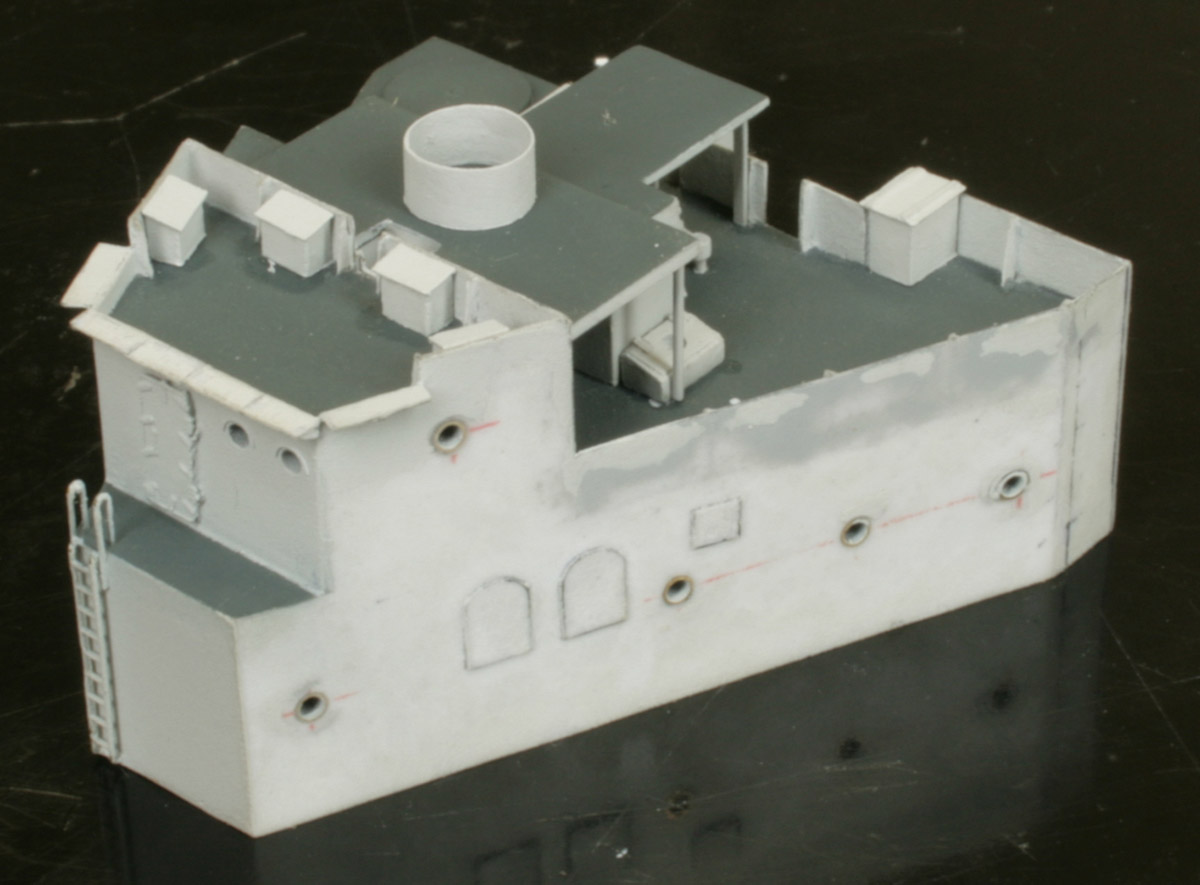

Aft deck housing
Nice little self contained item. I've taken to scanning plans drawing etc and creating new simplified line drawings from them as this allows me to merge drawings from different sources (and time periods), standardize sizes (have you ever noticed that it isn't that uncommon for certain features to be of a different size in different perspectives on the same plan?) and think about how I'm going to build something. Using a layered program (in this case Photoshop) I can easily separate different features to work on in isolation.
Here's an example of a line drawing for panels to fix to the outside of the base styrene structure with solid bulwarks and location of doors, portholes and a couple of other bits.
Because it's derived from the original housing drawing, it turned out to be a real good fit.
Under the hood....large strips of styrene stuck inside free edges to stop them from bowing
Initial coat of grey reveals a number of small flaws that need to be sorted; glue blobs, gaps, surface blemishes, burring etc.

Rear deck housing MKIII.
For some reason the paint on the sidewalls became quite 'rubbery' and a bit tacky (too much handling -> sweat/skin oil????) and collecting dirt so it's been stripped off along with some detail. Easy to redo when I'm done messing around.
