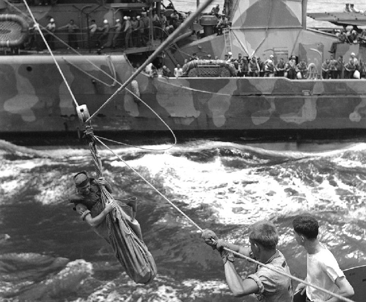

Re: Calling all USS Sims class (DD) fans
Another image of a SIMS class destroyer in late 1942. This photo has no date, nor does it say which ship the crewman is being transferred to. But, from the configuration the photo was taken after 1 August 1942 when her MINY refit was finished.

- Posts: 8649
Great photo. The Navy Yards had no consideration for future modelers when they painted these complex schemes. Didn't they realize how hard they were making it on us to replicate these?

Martin, what makes it twice as hard to model a ship in one of these camouflages is very seldom do we have photos of both sides.

Roger,
That is easy to solve. You simply paint the starboard side of your model in the pattern of a destroyer for which you have a view of the pattern on that side and paint the portside in the pattern of another destroyer that you have with a view of that side.
You get to model two ships at the same time.

Or, you can take your best guess based on similar ships; if there are no photos, who can prove you wrong?!?http://www.shipmodels.info/mws_forum/posting.php?mode=reply&f=49&t=16269#
- Posts: 3889
That is generally a good course of action, actually on many Ms 12(R)mod destroyers anyway in mid-1942, doing a mirror of the pattern from the known side is "almost" a safe bet. And after a point many of the USN yards adopted a "common" style for the Ms 12(R)mod ... I can spot a Boston Navy Yard Ms 12(R)mod camo job pretty easily ... that was used nearly the same way of several destroyers.
However, the DesRon 2 SIMS class destroyers are an interesting group in that there is hardly any commonality between the nine sisters. I have "partial" views of several of this destroyers taken at various times. There are some units that look like their pattern was slightly altered while in service during touch-up painting.
But, as you say, take your best guess. If you wait to get the EXACT pattern, the unfinished model maybe sitting there for a long time.
