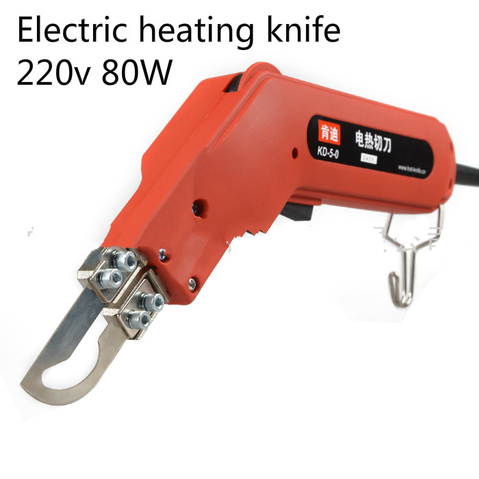

Another alternative:
Use Hot Knife Cutter.

Kometa wrote:Another alternative:
Well, that's a good way of totally destroying the plastic part! :whistle:

Oh, no.
Absolutely not. There are two models. One simple and one more expensive. I have tried the first in many models without any problem.
