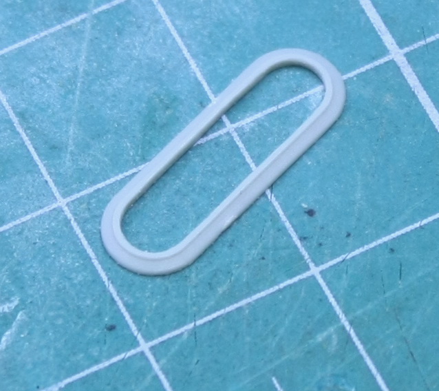

There is a pair of vents on the deck behind the funnel base which are represented only by a slip of resin � around it I built up the vent out of PE mesh and styrene sheet.
