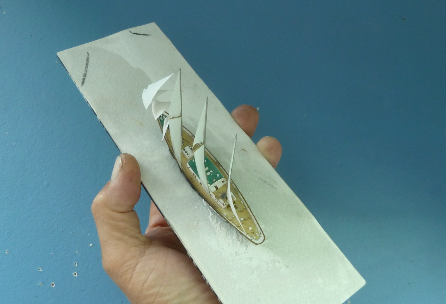

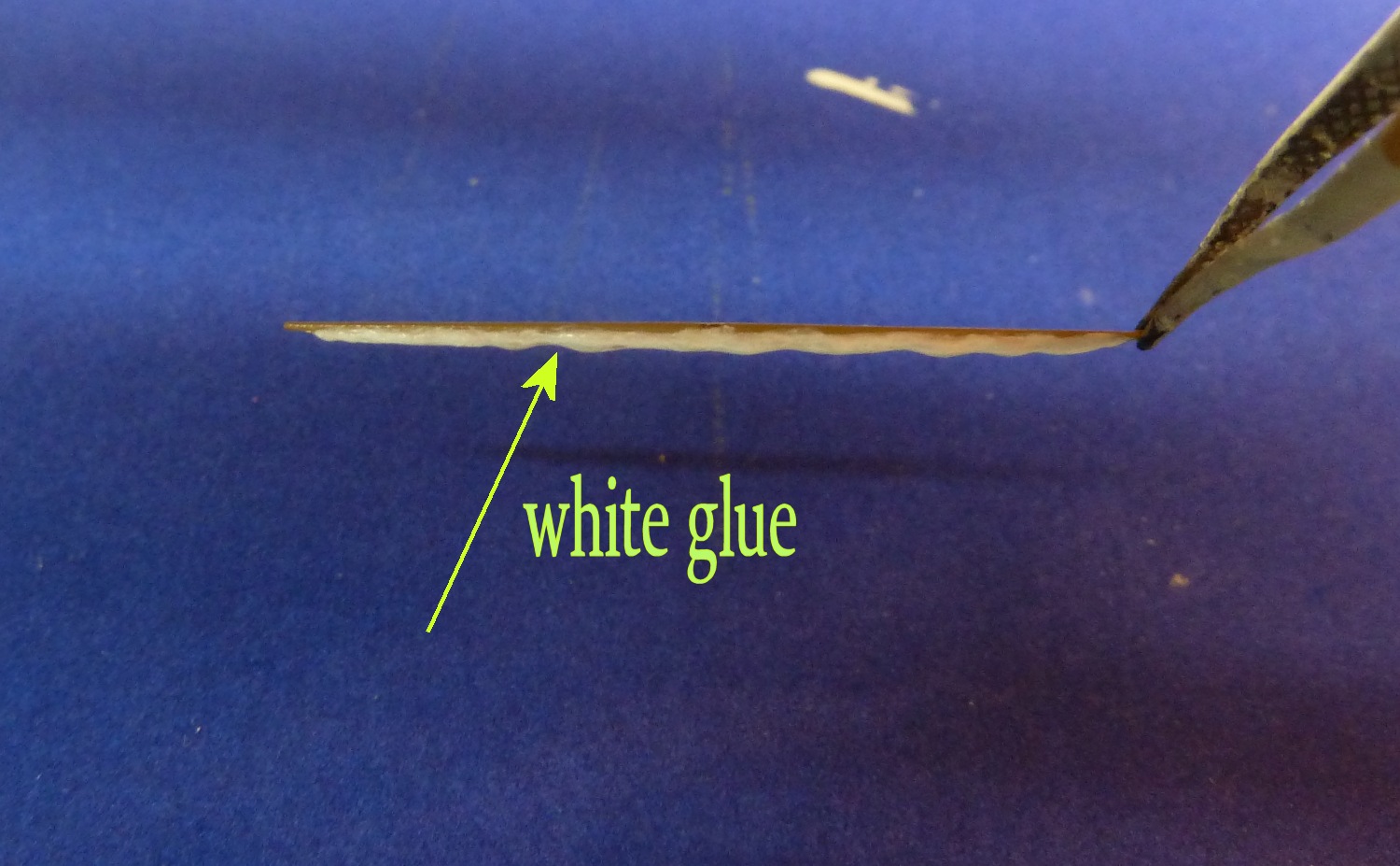

But before I did any colouring I had to make them moisture impervious and stiff enough to take a shape
I experimented with CA-- but the paper went grey and the surface was was not to my liking, I tried a thinned enamel paint and vanish combo,
( using hemp colour to be easier able to gauge the coverage effect) and also used matt varnish airbrushed on, the latter was ultimately the most successful.

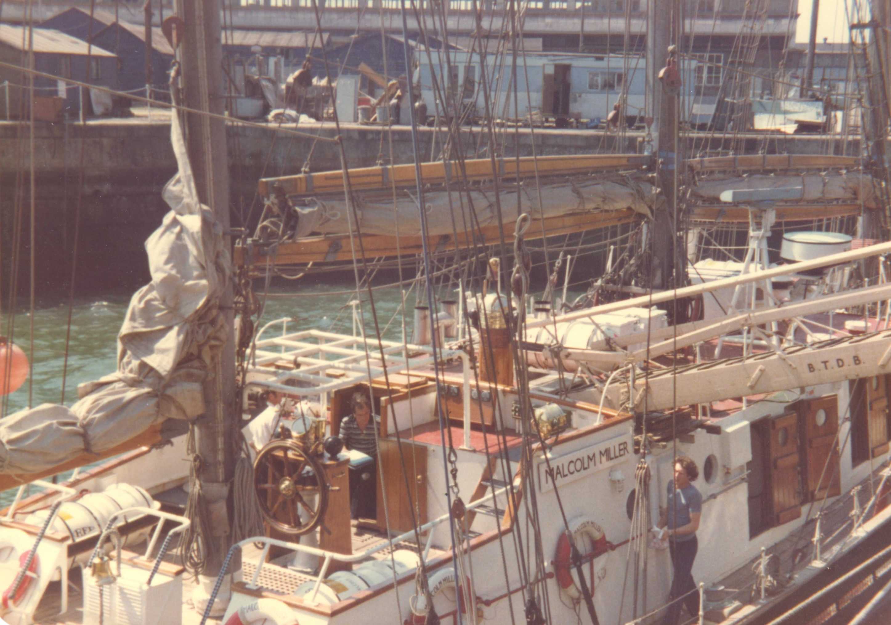

that when sails are backlit by the sun-- the seams, reinforcing, reef points etc are quite prominent,
with the sun shining on them they appear almost solid white and hardly any seam detail is visible.

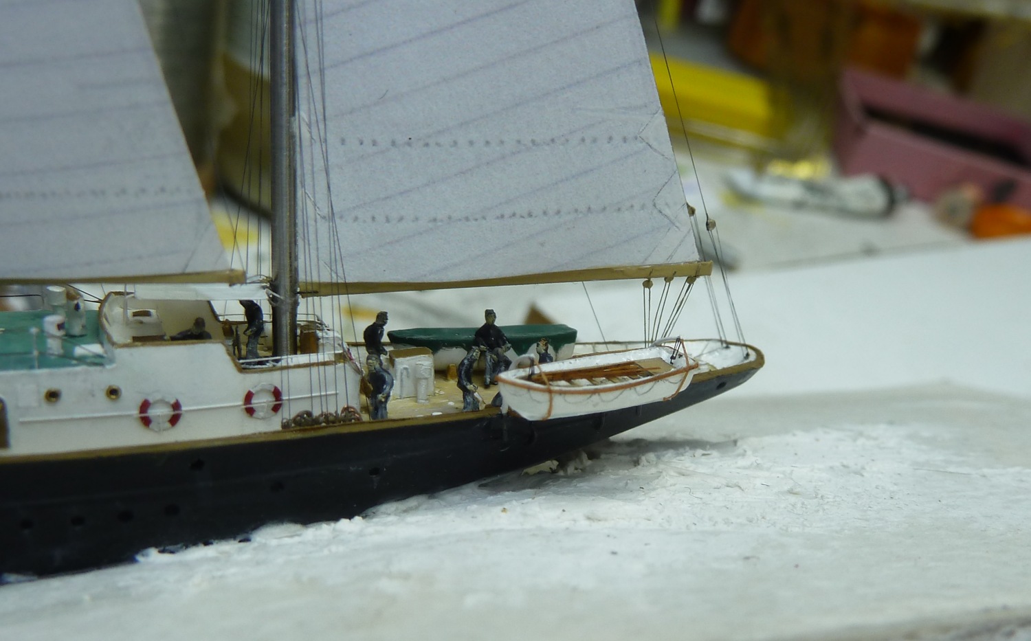

in model form ,we the observer/ viewer know that there are seams--but we cannot alas encompass all the variants if the above scenario,
hence a compromise is needed.
To this end I decided to overcoat the sails and their seaming with layers of thinned white paint.
I tried airbrush but it gave a ghostly, overly homogeneous ' dead'; feel- (alas probably more correct...)
- so I resorted to brushed washes.
Its an inexact art/ science and I feel I can hopefully improve vastly on this in every direction in the future

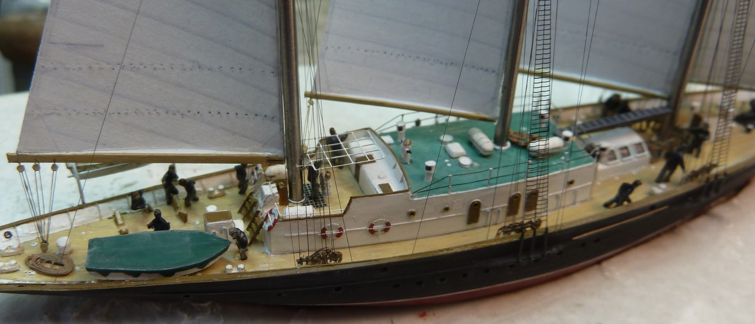

after a number of layered washes the effect I sought was appearing

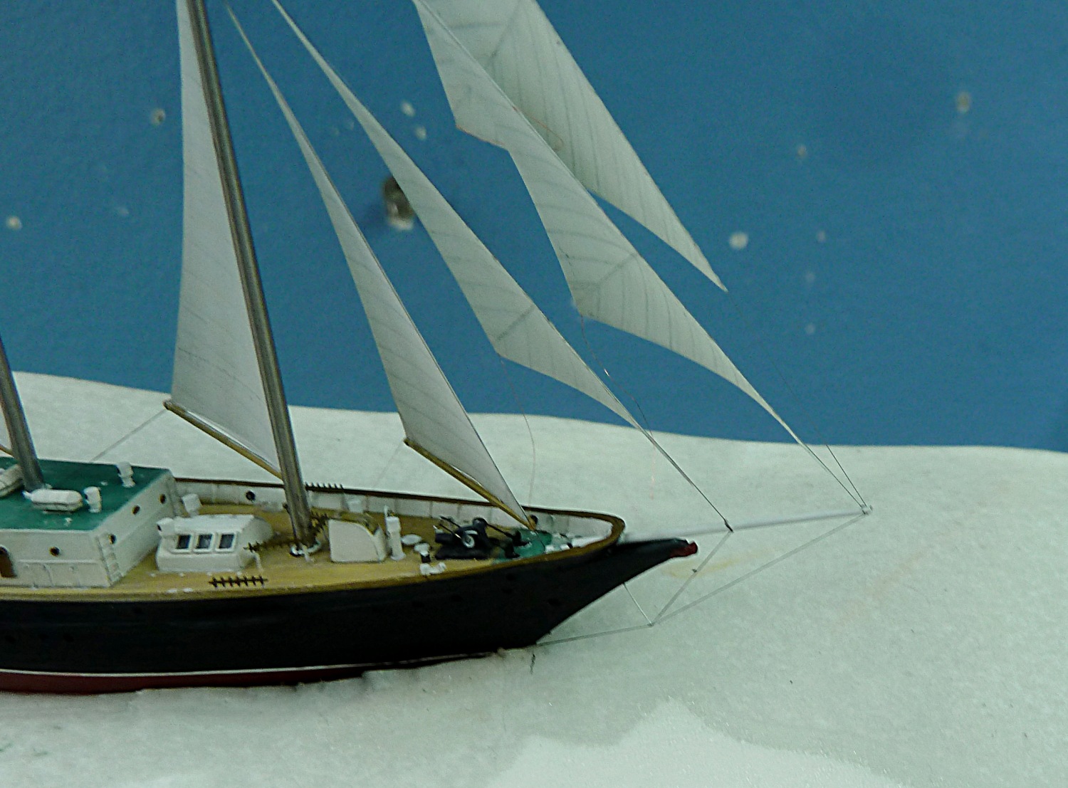

Getting the desired set and twist into the sails was carried out by using a clean cylindrical tube and pressing this onto the sails on-top of a post-it note pad , repeatedly rolling back and forth until the shape started to appear.
The biggest issue had was of getting the large number of head sails to set on their stays without sag or kink.
Wire would be the obvious material, but I was worried that if kinked once it would be irrecoverable
I used the .oo3 line from' Uschi von Rosten' for the stays, set up with some degree of tension ( thankfully my masts are made of stainless steel
( masquerading as anodised aluminium)!!! and they were up to the job and showed no sign of deflection.
I have had a test-rig of this material in the various sizes outside in my garden in bright UV light and all weathers for the past 4 years-- seems unaffected ...
so an easy life out of UV light in a sealed glass case..... :cool_2: ?

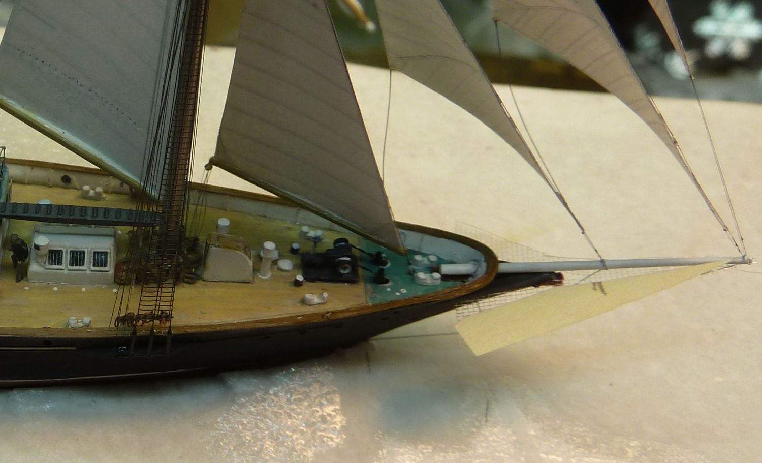

The brass bow sprit was also braced as per the real thing

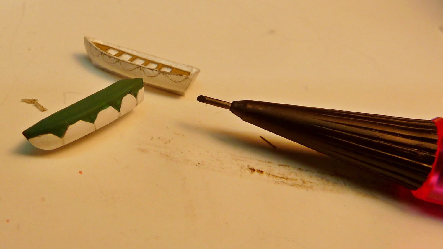

Winston Churchill carried usually 2 sometimes 3 dinghies.
The kit items at first sight I was about to dismiss as being too deep, square and clunky...
but... study of the old news reel footage showed them to be about the right shape and size--so Imai were correct.
But moulding tech back then resulted in rather fat gunwhale coamings and a boat interior that was way too shallow
curable ... with much paring, digging and micro-chiselling fro the sea-boat slung outboard in davits port-side
The boat on deck on chocks was canvas covered.
I did not bother hollowing this one, but installed a string back ridge of wire
and then made the canvas ,by spanning white glue across the gaps, after 2 coats the desired effect was reached
The davits on the leeward side were distinctly tapered;
I used ( wasted? :cool_2: ) some 1/700 Master models tapered yardarms
to make them and cut them off just past the un-tapered midway point :smallsmile:
The boats are now painted, they need oars and and finishing, the canvas still needs a final pencil outline and the the edge of the coaming defining with a light drybrush

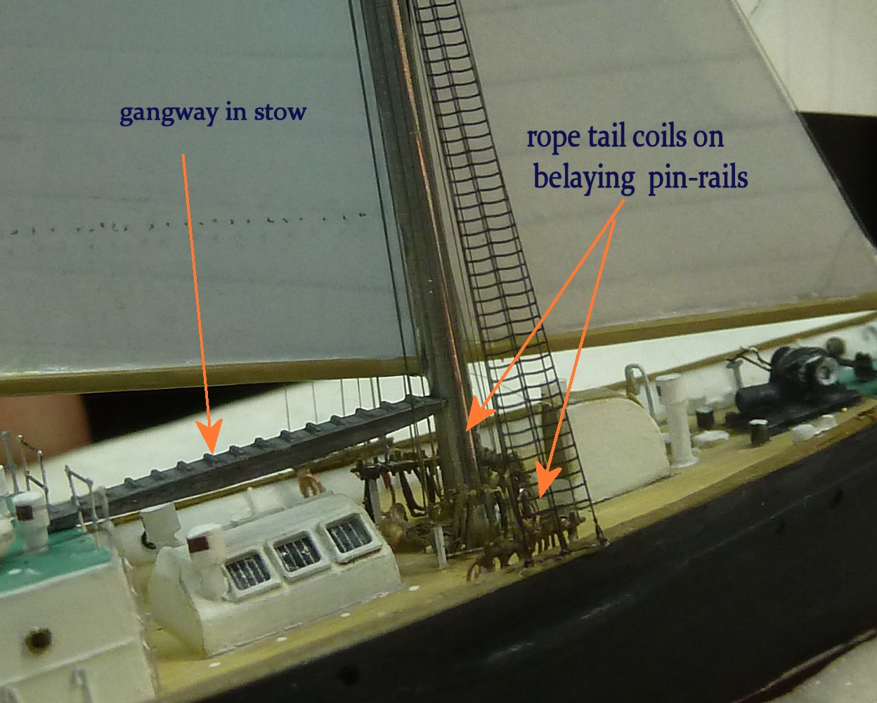

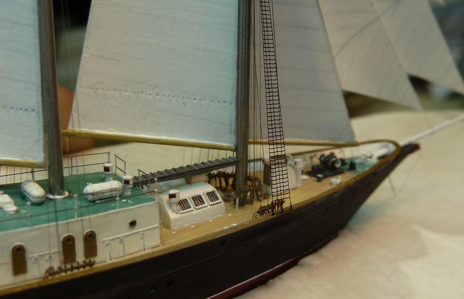

Working from midships outwards I first installed all the ( feasible to me ) halyards , hoists and tackles I could discern
using the Uschi .001Thread , in the main for its resilience and inability to get damaged by to knocking and kinking accidentally
The dark grey is not offensive; against the sky or any light surface all rigging on the real thing looks a dark colour,
though... I have started washing some of the halyards with a tan wash... :cool_2:
At the terminations of the lines at the belaying pinrails I added rope coils ( as per photos of the real thing above)
thgese wreemade of very thin copper wire , painted and hung in place using matt varnish.

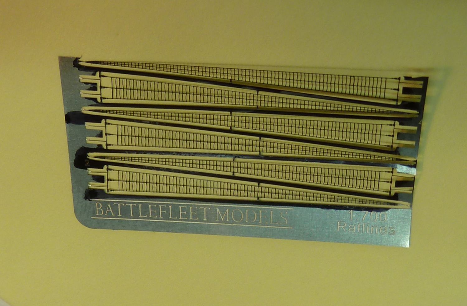

I used some items from Alliance- ( Battlefleet )- albeit the 1/700 version as they were the right width / height
the slightly more frequent foot-ropes don't really offend my eyes ( compromise!)

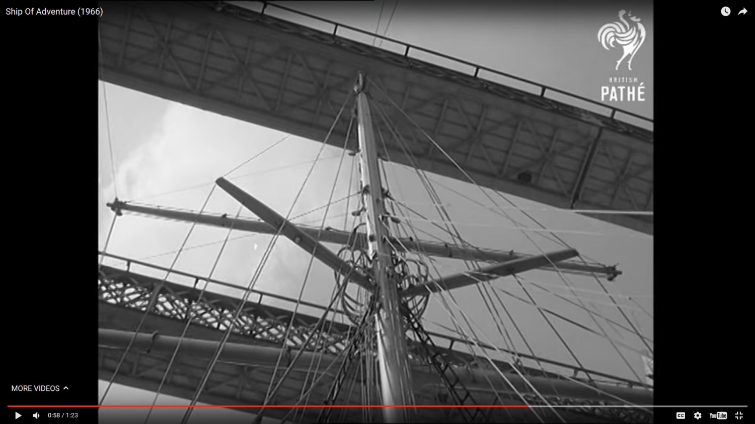

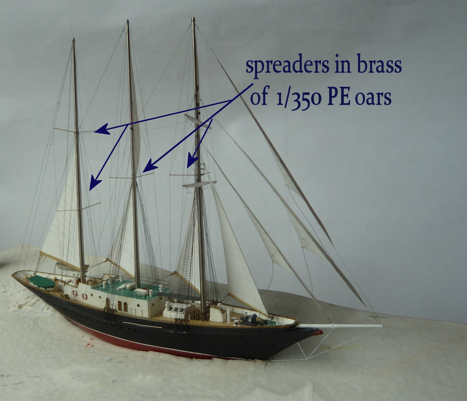

The spreaders were glued to the masts --they were made of 1/350 PE Oars
---being cut so that only the very extreme slight flared top of the oar-blade was left on-- to give a greater glue base...
It was all a bit fiddly to get them all at the correct height and the correct upward sweep-
apart from the fore mast which had upward and aft sweep.... ( to clear the square sails )
Thereafter the lower, intermediate and inner shrouds were rigged-- of stretched sprue

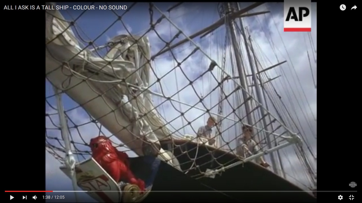

I have been making small templates
and scouring my own supplies and dress / hobby shops for many different very fine nettings....
then I noticed that the net orientation and hole size varied... from square(ish) to centreline to diagonal...

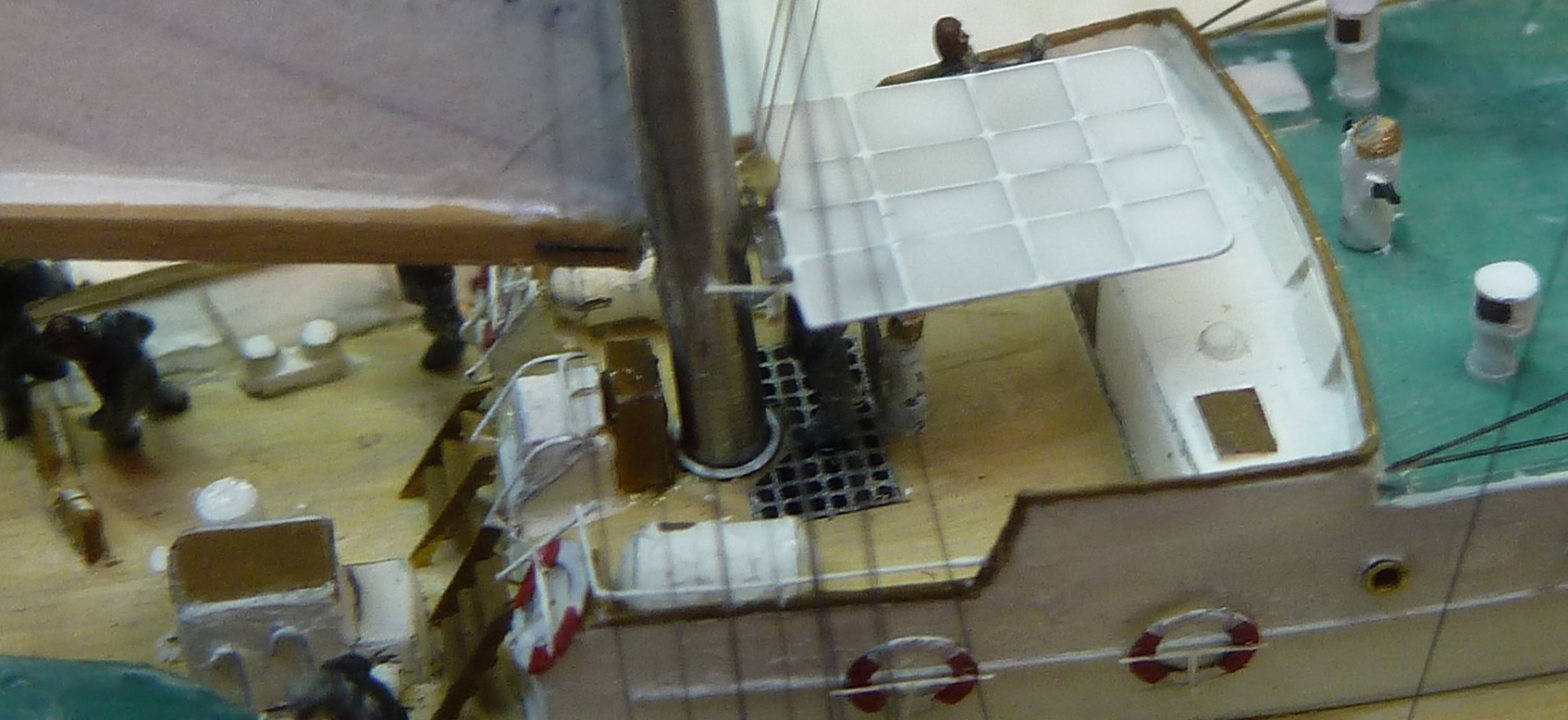

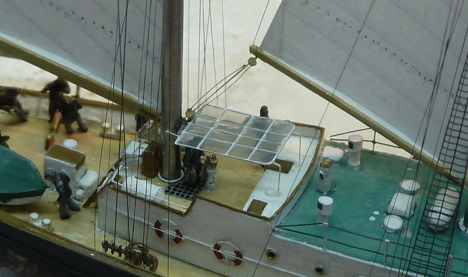

Winston Churchill had a small sun-roof over the helm position ( or for UK waters-- more of a wet drizzle roof...)
This was spanend across a staggeringly substantial ( for its purpose ) piece of frame work ,
and is a distinctive feature of SWS as well as her near sister ship Malcom Miller
Photo of Malcom Millers sunroof frame --which differs in design and size somewhat to that of SWS
In model form I searched thru' all my PE scraps- this was nearest -alas of unknown origin...

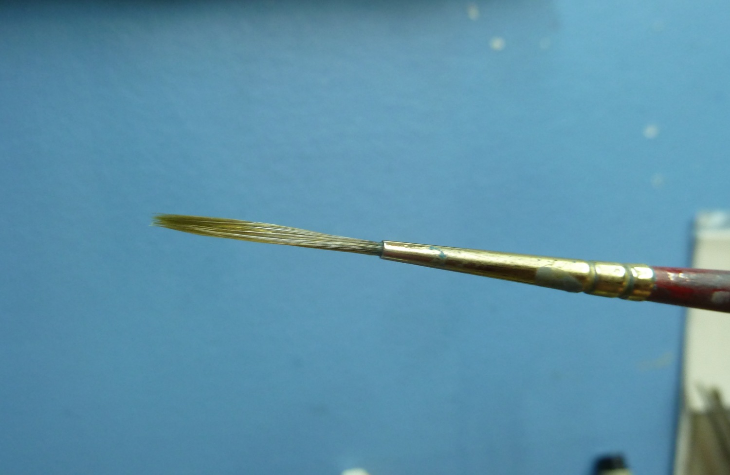

I covered the frame work with thinned white glue
using a ' rigger' brush ( marine watercolour artists brush used for painting fine swiping fine lines --hence rigger)
This brush in this application is very soft and long--hence maintains contact of the glue film over large areas without the film ' popping'
The white glue dries clear
....and after paint gives a nice very lightly textured impression of the canvas hollowing out slightly over the high points of the framework
The 'sea-boa't hanging in its davits was furnished with oars ( stretched brown sprue) and had its tan coloured straps added
( made of brown stretched sprue)
and the mainsheet multi-purchase for the large Bermudan rigged mizzen was rigged with its blocks
It was important to have all the crew-members on deck standing vertically relative to the sea surface
whilst actually standing on the slanting deck of the heeling ship..
==> The figures suffered the required brutal ankle and knee surgery stoically ... :cool_2:
The head-sails gained the tackline down-hauls
the next update should hopefully find a solution for the bowsprit net and more details added
The model is now reaching the stage where I can see light at the end of the tunnel.... :cool_1:
:wave_1: :wave_1: JB

after much fiddling, many attempts I managed to get the bow sprit netting in place to my liking
Now the sea base has had its first coat I can see it too distictvly--making a harsh contrast
I shall gently wash it with light grey to tone down the white

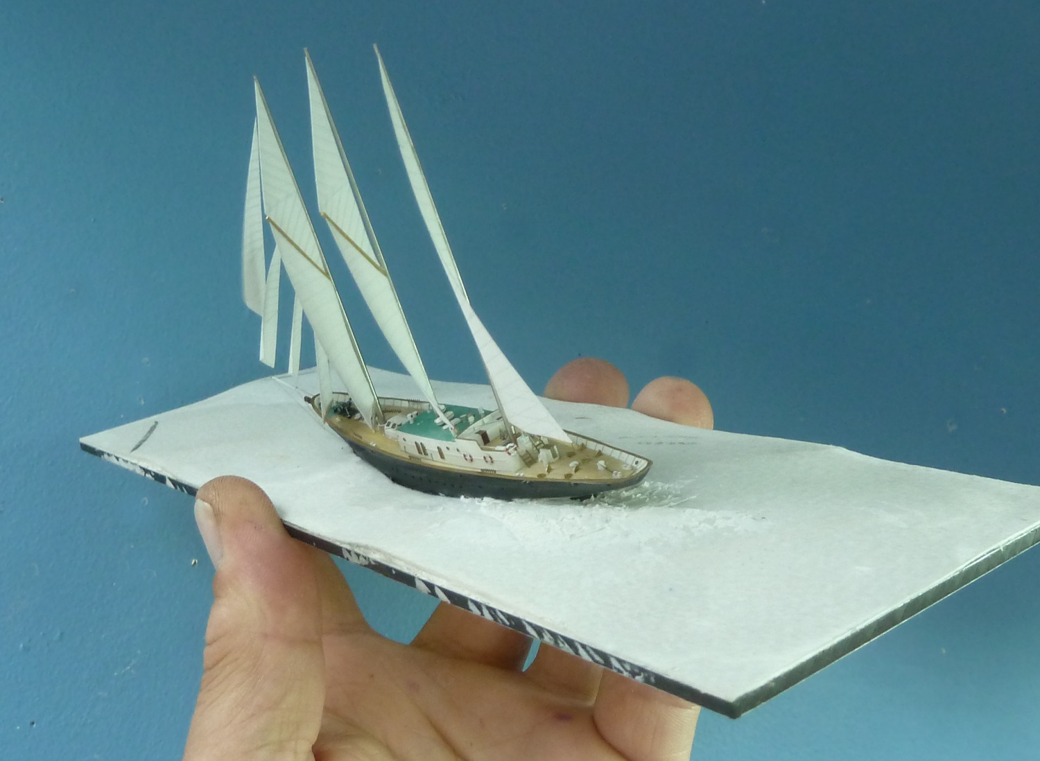

.... :cool_2: and so the model has reached completion...
Painting the sea was a pleasure--as the model really came to life !
Despite being a ' modern ' sailing ship( launched 1966) , I've learnt much and quite enjoyed the research--
often from Pathe news reels, but also from private video footage that has been uploaded to youtube
There is much that I would have tried harder on were I to repat the build,
- I have gained valuable experience in small sailing ship modelling which I shall put to use
in a future 3-masted sailing ship project that is germinating as we speak... :big_grin:
....but in the meantime I shall build a couple of small ship models that do not have sails !!
...-though they will have ratlines... :cool_1: :big_grin:
Some " proper" photos will be taken soon and appear in the gallery in due course
--meanwhile a couple of point-and-shoot camera images from today see below:

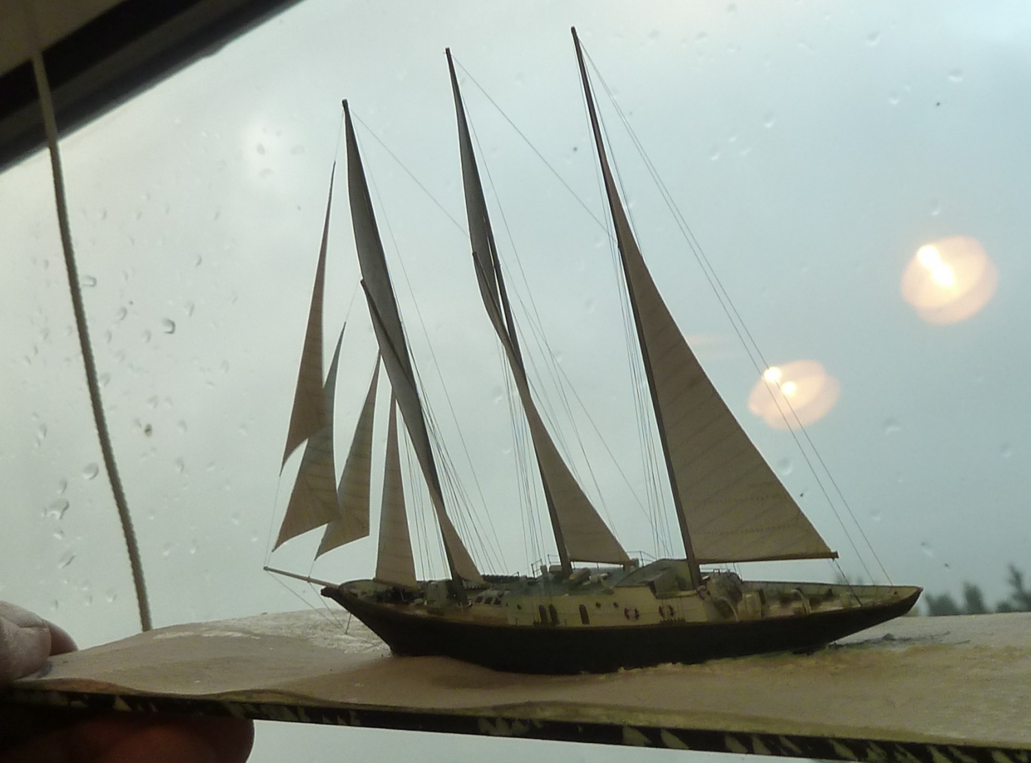

Herewith today's snapshots of the finished model
Jim Baumann :wave_1:
