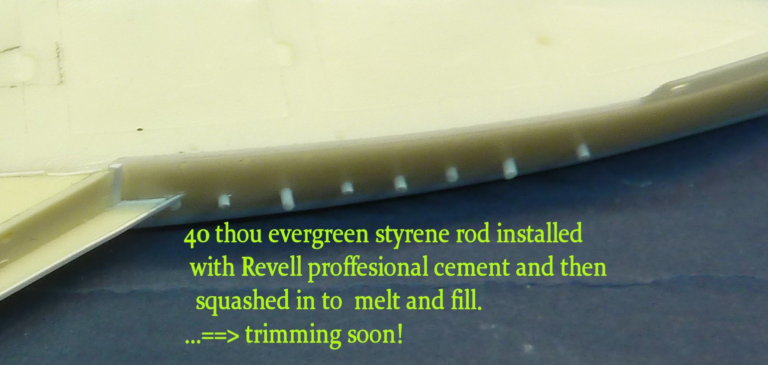

Infuriatingly --after staring at photos--I realised that there was a bit of an issue again with the portholes... (!!)
It seems the same hull casting was used for the WW2 Thanet version of the kit as the WW1 Ascot version...
Aarghhh!!
As a Navy built ship she had an upper row of portholes only
the lower portholes were added after WW1 in civilian service...
here is Athelston in her inter-war pleasure steamer guise as Queen of Kent- with lower portholes
and as its should be in WW1....
as can be seen on the Ascot builders model and every other image of the ship in W1 service... ( see image in my previous posting)
Hmnnn...
so this is the current status quo-- "HMS Porcupine..." :cool_2:
