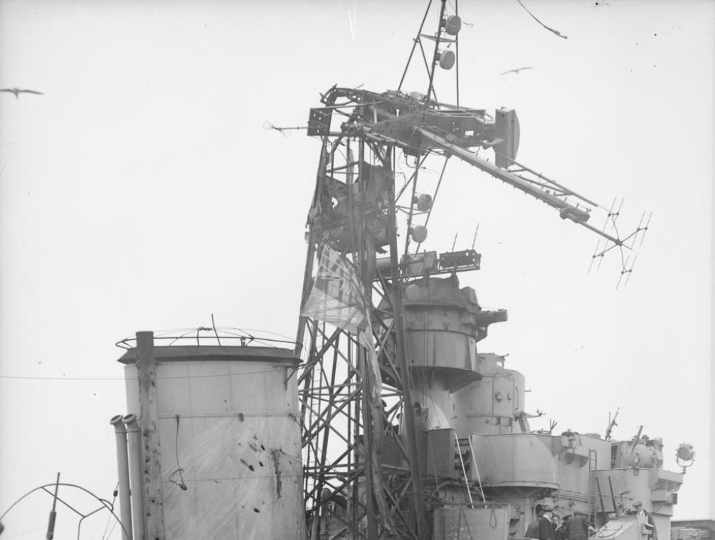

In 44 Tartar`s rangefinder turret was a MK II W, her fire control was the later Mk 285 array which consisted of 3 parabolic reflectors each housing 2 seven element yagi booms. If you look back in the thread I have posted a couple of shots of the array.
Her earlier 285 array in 41 consisted of 2 double and a single central reflector, they were a different setup.
The attachment shows her 285 array, and damage sustained in 06.44 action., by this time she had been fitted with lattice foremast.
She is fitted with a 291 X antenna atop the masthead, the smaller parabolic RDF looks like a 276 outfit AUJ, the image also shows a 253 IFF hourglass antenna.
If you are pondering what the circular objects are on the main yardarm?
They are lantern hoods fitted over the fighting/signal lights to help conceal their illumination from the air.
Many ships by that time had been fitted with these lantern covers, including lower shades, see the attached image.

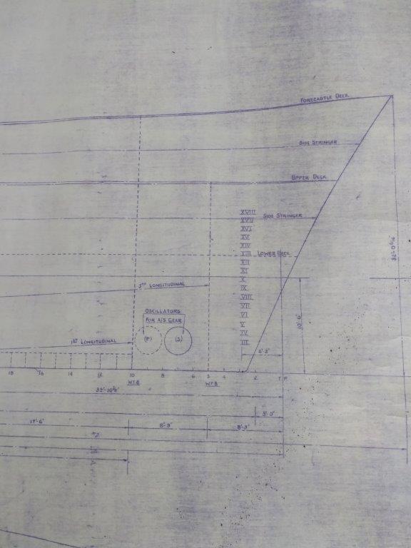

While researching where to end the antifouling and paint waterline marks for my restoration project of a scratch built 1:72 HMCS Athabaskan, I dug these out of my father's drawing tubes. These are portions of drawing 3S Docking Plan specific to Athabaskan. Scale is 1/4" to 1'
Portion of drawing 3S Docking Plan

The bow drawing is of interest, I had previously pondered the circular equipment.
Separate to the retractable 144Q Asdic pod, some Tribals were fitted with them, while others were not.
The Australian ships Arunta and Warramunga were not fitted, but Bataan was.
The use of the word `Oscillators` would indicate `Fessenden` diaphragms, and A/S could pertain to `Acoustic sweep` for acoustic mine sweep.
But A/S could also relate to Hydrophones, Can anyone provide more detailed information?
