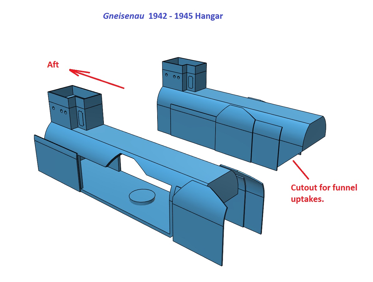

Sean, from available references, this is the best I can make out of Gneisenau's enlarged 1942 hangar with any confidence. The rendering shows two views, one of the hangar with open doors and a cylinder representing the catapult pedestal which is inside the hangar, and the other view with closed doors. As you can see, it is very different than Scharnhorst's hangar. Scharnhorst, as you know, had a rooftop catapult and rooftop sliding doors. Gneisenau could launch aircraft from within the hangar.
In addition to identifying and modeling features and details of the hangar, there is also a new, large, multi-level boxy structure built aft on top of the hangar. Some photos show a cylindrical tub on top (Cerberus), while other photos show just a splinter shield (wreck photos). The shape, size, position and footprint of this structure is very difficult to determine from photos. The structure does appear on the original builders' plans for the ship's planned 1943 reconstruction but not clearly (Breyer, 26-27 - see cropped, reduced image below). The aft end of the structure is probably flush with the hangar.
No references I have access to show the hangar interior, which plans show could hold two Arado aircraft, one on the catapult and a second stowed aft and above. Exactly how the second aircraft was stowed is a mystery. A third aircraft could be stowed on the roof, but not launched from there. The catapult and pedestal type and configuration are not discernible from available references. We could assume that is was identical to the type previously fit, and may have been the very same catapult, simply relocated to the hangar during hangar construction at Brest.
Rooftop details are unknown but rooftop tracks of some kind appear in the builder's plans, probably for an aircraft stowage cradle.
Hopefully better references will be made available and both the hangar and boxy structure can be modeled and detailed accurately for 3D-printing or scratch-building.
Any help is hugely appreciated.

Wow, Steve. That's some impressively quick rendering!
I would bet on it being the same catapult, just lowered from its previous position.
These things almost never end up looking like smooth sheet metal, so there's almost certainly more exterior surface detail to the real thing than what the drawings are showing. In addition to the rooftop Arado storage rails, it looks like there were also searchlight platforms on the aft sides of the hangar at the time of Cerberus - so some railings and ladders would be in order.
Regarding the interior detailing, I'd think a decent amount of overhead framing would be needed, given the need to span such a large opening and support the weight of the third Arado on the roof, and provide support for a probable gantry crane to move planes between the storage shelf and the catapult. Probably throw in a ladder or two for mechanics to get up to the shelf to work on the stowed aircraft, and some storage lockers in reasonable locations.
Unless someone comes up with that perfect photo, or truly authoritative drawing, I think there's little need to worry about it. Given the very crude paint patterns and grainy photos of Gneisenau from mid-41 until destruction, there's an awful lot that can't be proven. I don't generally like just making up details, but in this case I wouldn't feel too bad about just following the logic of it. (And what better way to bring that evidence to light, than to scratchbuild it wrong for all the world to see! It's sure to come crawling out of the woodwork a few weeks after it's too late to change it! :) )
Mounting all three aircraft and applying that Cerberus camo should keep the area busy enough to make the entire effect busy enough compensate for all the unknowns.
