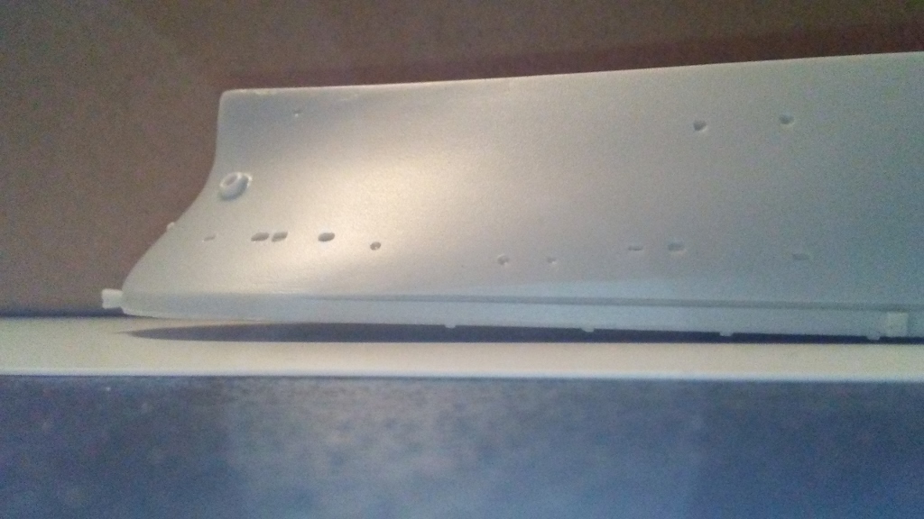

Guys I most likely overlooked this in the forum but I have TWO really bad warpped hulls for two resin 700 scale LPH kits (Wave-Line SPR-07/Pit Road) If these where full hull I could fix them but with them already WL the warp goes all the way through the flight deck, I have racked my brain over different ways to address this issue but I am at a loss at the moment.
Sanding them flat is not an option as it will change the height from the water line to the flight deck, sanding the flight deck in the center is not much better of an idea as I will lose the molded in details. The stern of the hull touches the table and the bow touches but the center is like a 1/4 moon shape, I looked at both kits I have and they are the exact same, I know others have built this kit and if you had the same problem how did you fix it? I think, actually pretty positive that the warp is a mold issue.
Any suggestions would be great.

Another question: is this warp a more or less simple arc, or is the hull also twisted? For a simple upwards "bow" I have a couple of ideas, but if it's twisted that's going to be a handful. I have one of these kits and I know how that integrated hull/flight deck casting is a solid hunk of resin.

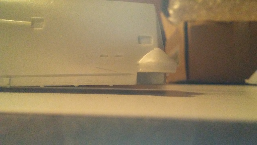

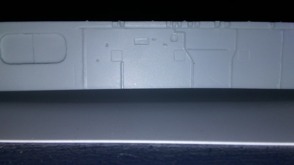

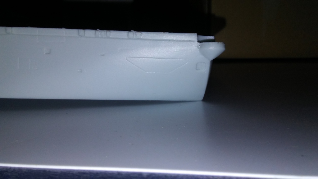

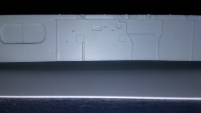

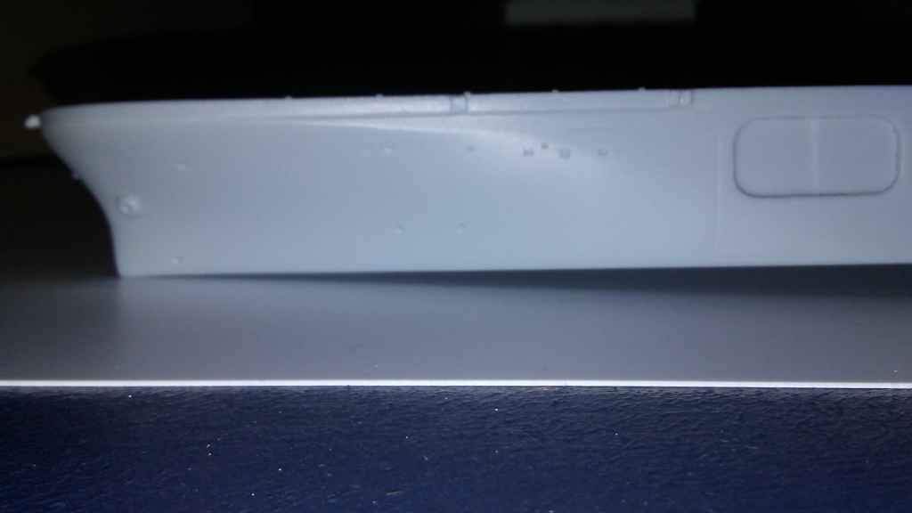

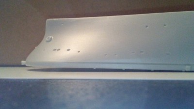

Jodie here are a few pictures of the kits hull it is more or less a simple arc but also has a slight twist to the hull its self. The gap between the hull and the table is nearly 1/8" inch wide. I am thinking about the microwave trick to see if I can get it heated enough to clamp it down to a flat metal surface to at least get the hull to sit flat.
Any ideas other than what's been suggested so far?

Thanks for the photos, Jim. That does help - and that is a doozy of a warp.
For whatever it's worth, the way I would address this would be to locate three or four areas along the hull where there's no detail, or whatever detail is there can be easily replaced. From the bottom, make some relief cuts about halfway to two-thirds up the hull (but not all the way through, since you don't want to damage anything on the flight deck). Then apply whatever heat method you're going to use to soften up the hull, straighten the hull out and clamp it down so it will set flat, and then leave it be until it's hardened.
Once it's set, fill the relief cuts with plastic held in place with CA or epoxy and sand off the excess, then use whatever filler you normally use for finishing, replace whatever detail you may have lost, and then proceed as you otherwise would.
I make no warranties on this method; it's just the one I would use if my kit had this problem.
