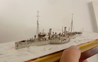

the yard-arms ( tapered brass - Master models of Poland ) are up on the masts
The ratlines are now installed

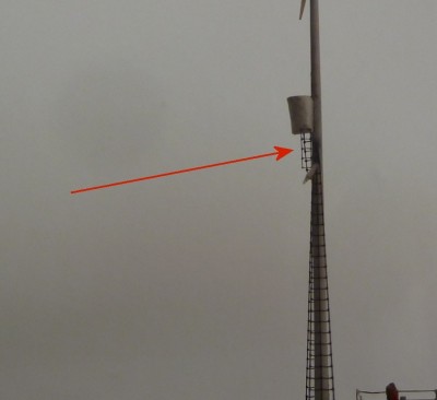

and a significant detail..
It was mystery to me looking at the low res images how the unfortunate crew-member would get from the top of the ratline shrouds
into the look out -- as the shrouds stopped well short of the look-out .
zooming in and out of the available the images I found the answer--still must have a pretty scary pastime-
especially if pitching/rolling at sea....
Brave chaps ...!
I emulated something similar

PostPosted: Thu Feb 15, 2018 6:02 pm
Posts: 5555
The model is .... -- inexorably nearing completion !!
among other jobs before the rigging commenced in earnest was to add some detail to the main sweep winch.
A google and you-tube search gave an understanding of how this type of winch functioned.
I added some " wire cable" to the empty plain drums --made of copper wire 3/4 circles--spriung in place and glued
Winch brake operating wheels were added from PE AA 1/700 and 1/350 gun sights,
The cable guides were made of various brass PE scraps cut and adapted to shape
Whilst not perhaps a 'accurate' replica it gives the flavour of that ilk of winch
I also added the supporting struts add gussets to the cable deflecting frame
with paint it looked more subtle
The Davits for the ships boats had their falls rigged, the companionway had its hoists rigged--along with a spreader bar and the sea-boat was secured in its swung outboard position with tan-canvas straps made of flattened stretched beige sprue .
a gash shute on the stb aft side was added also
For a simple ship it had considerable amounts of riggings--
I added as much as I could that I was able to glean from the photographs
The aft sweep deployment gantry frame was also rigged as accurately as the photos and my understanding of its workings allowed
The ships overall is taking on shape-- and though not beautiful could be considered to be handsome!

Really nice build Jim. The weathering and detailing is a nice reference.

@ Rui....... The crows nest, is it canvas covered?
SSHHHHhhhhhhusssssch..... :Mad_5: :Mad_6:
Brave chaps ...!
They are called "futtock shrouds" and have been used since time immemorial to get into a man of war's fighting-top the way Real Men do it, around the outside edge, instead of through the perfectly convenient opening in the centre of the platform (called the "lubber's hole" just to rub it in).

Phenomenal work, as always! I can't believe how much detail you manage to get onto something so tiny. Masterful.

superb work Jim, think I'll sell my kit now lol

Hello Jim
always a exeptional skil :thumbs_up_1: a real modeling lesson :woo_hoo:
cheers
Nicolas
