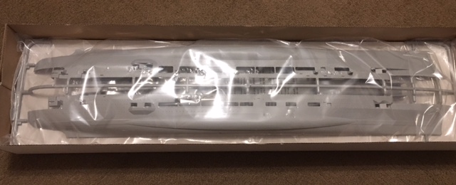

File comment: The two hull halves and the hangar deck.
Detailing is very nice, crisp and clean, it does not appear that there will be a lot of cleaning.

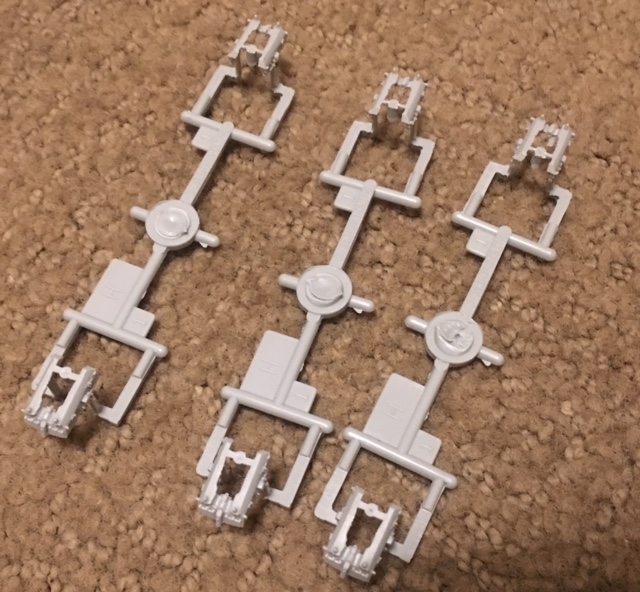

File comment: sprues D as shown there are four of these that have the main body of boats main weapons including shaft and rudder for the boats, detailing here is good as well just like the other line of German ships they offer.

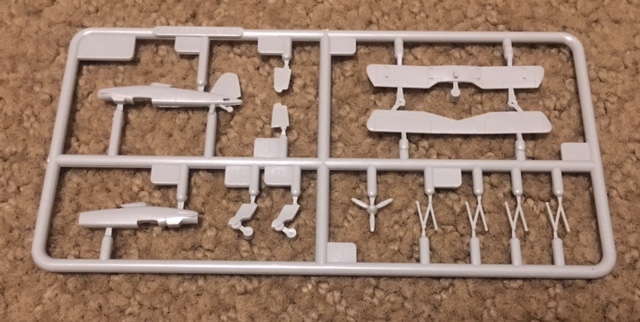

The one part of this kit I was looking forward to was the airwing, finally something different, they have included the four aircraft they had originally planed to operate of this carrier, the AR 195, JU 87, BF 109 and the FI 167. They have included 5 of each aircraft.
The detailing clean and they offer some additional pieces like a drop tank for the BF 109 and for the AR 195 the have opted with a full photo etched frame of the canopy along with photo etched arrestee hooks for al the aircraft.

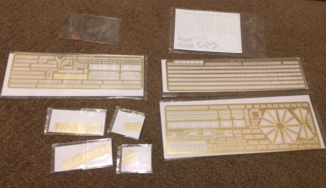

File comment: Here is a bonus surprise, not only have they included the photo etching for the ship but they have included a real anchor chain and some photo etching for the aircraft.

File comment: BF 109
