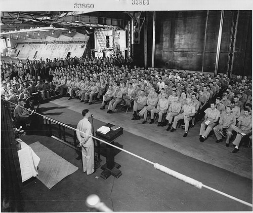

I've glued down the starboard hanger sections. Added a few fun items along the way. It's not perfect and I'm missing some stuff but at least I can see the similarity in pictures.
Task Force 48 provided me with a picture that I was intrigued by and wanted to run with. The picture below shows a Sunday service being held at the center elevator area.
You'll notice that the bulkheads around the elevator are very dark. I don't know what year of the war this was taken but given the number of times the Enterprise was painted, it seems it was dark at one time or another. We thought there was a very good chance these were painted deck blue to prevent the elevator opening from being a giant white target square for dive bombers to aim for if it was down in an attack. Going with this assumption, I've decided to paint the bulkheads around the elevators deck blue. I can't prove this but it adds interest to the hanger area and I like the idea. Don't fret modelers, I also have pictures of this same area painted the same color as the rest of the hanger...so go with your creative spirit.
