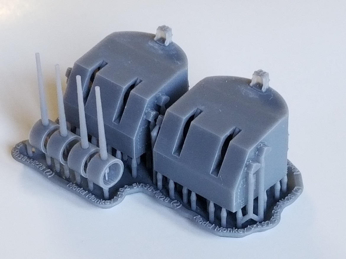

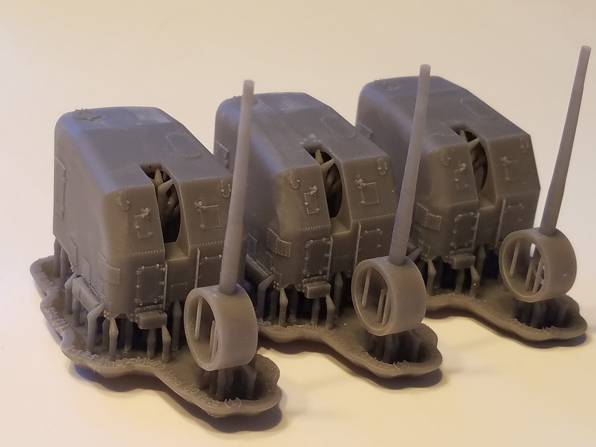

Here is the 5"/38 Mk.28 twin-gun mount (for fast battleships) set in 1/192 scale.
The 1/200 scale set is expected to be identical in appearance, just 4% smaller.

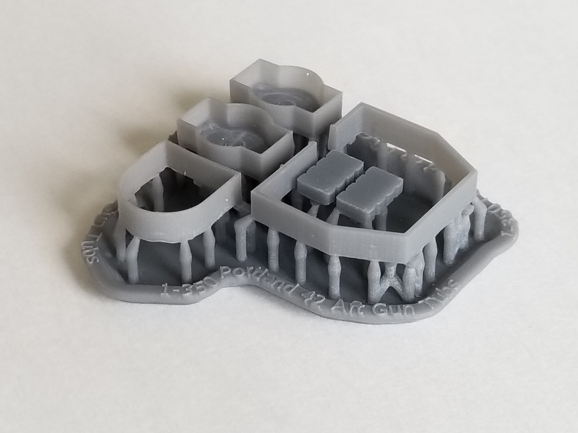

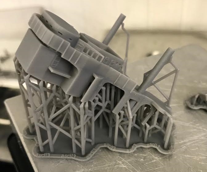

PostPosted: Sun Aug 19, 2018 12:09 pm
Posts: 3438

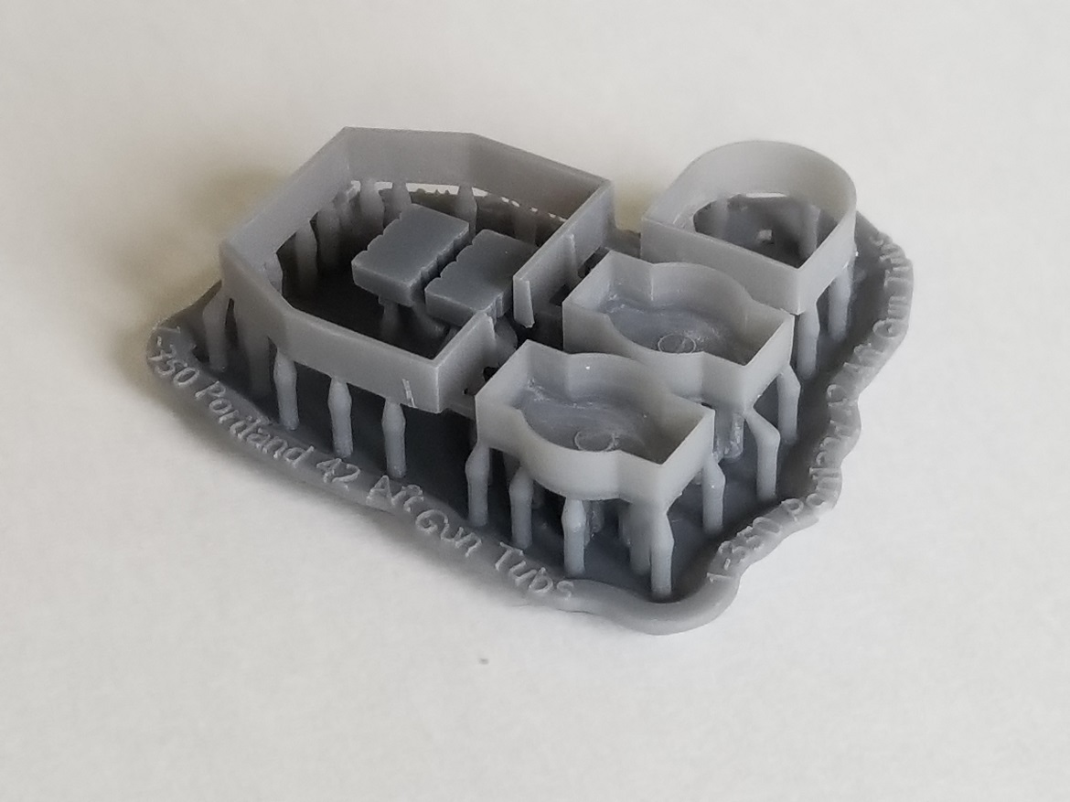

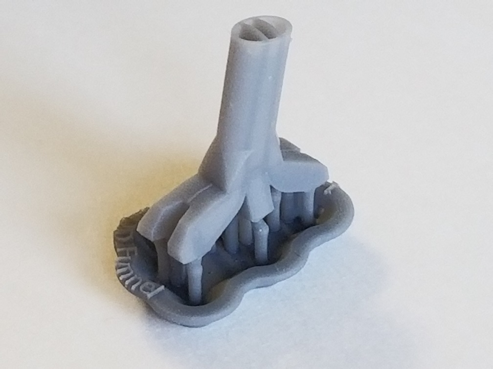

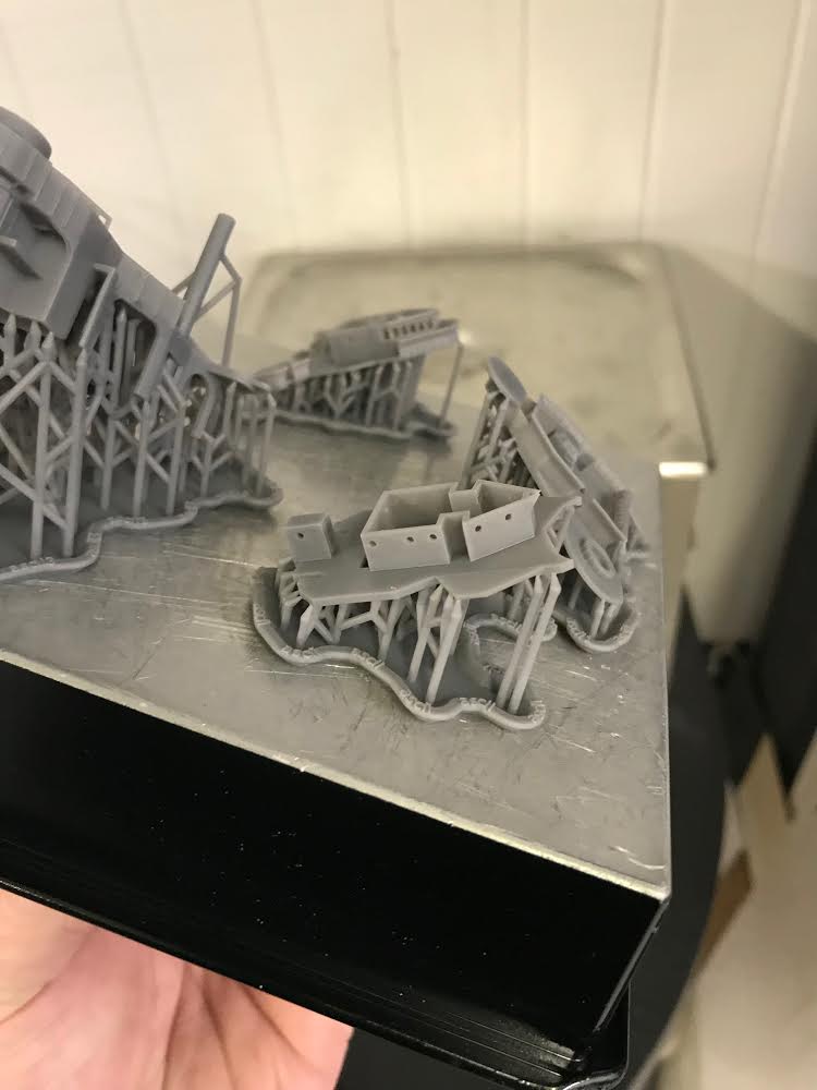

Good news, superstructures are printing well so far.

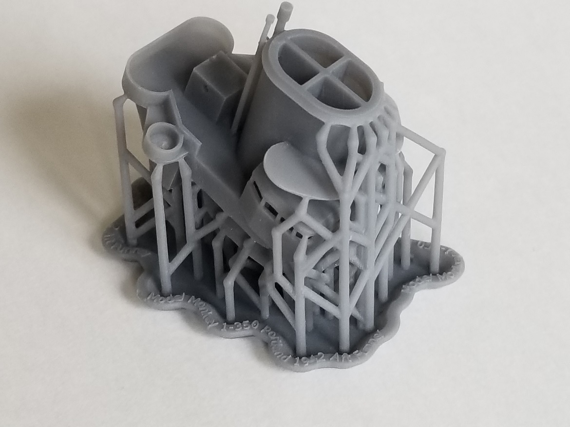

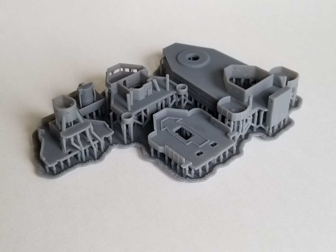

For example, here are some photos of products to help convert your 1/350 scale USS Indianapolis CA-35 kit to sistership USS Portland CA-33.
Notice how the printer did a great job capturing the planking on the cambered Aircraft Handling deck and the steam pipe opening on the funnel.
There are a lot of support sprues but no worries, their attachment points are small and weak, just 0.6 mm in diameter, so they can be cut off easily using a common cuticle clipper. This is especially true for small, blocky parts like turrets. For the large, flat pieces like the aircraft handling deck show below, the best way to free the parts from the printing support tray is to cut the tray away from the model, not the model away from the tray. In other words, cut sprues at a point nearest the tray, not near the the model. Cut your way around the tray from the outside working your way in. Remove the tray. Then trim the remaining dangling sprues from the model. Gently sand away any remain "nubs" just like you would injection molded polystyrene.
These photos show all the products exactly as they are when they come out of the UV light booth, ready to ship. No priming or other finishing has been done on these models. This is how smooth the surfaces really are.
Hope this helps.
Model Monkey 1-350 USS Portland 1942 Aft Funnel a.jpg [ 176.82 KiB | Viewed 1461 times ]
Model Monkey 1-350 USS Portland 1942 Aft Funnel b.jpg [ 179.23 KiB | Viewed 1461 times ]
Model Monkey 1-350 USS Portland 1942 Aft Gun Tubs a.jpg [ 170.84 KiB | Viewed 1461 times ]
Model Monkey 1-350 USS Portland 1942 Aft Gun Tubs b.jpg [ 158.74 KiB | Viewed 1461 times ]

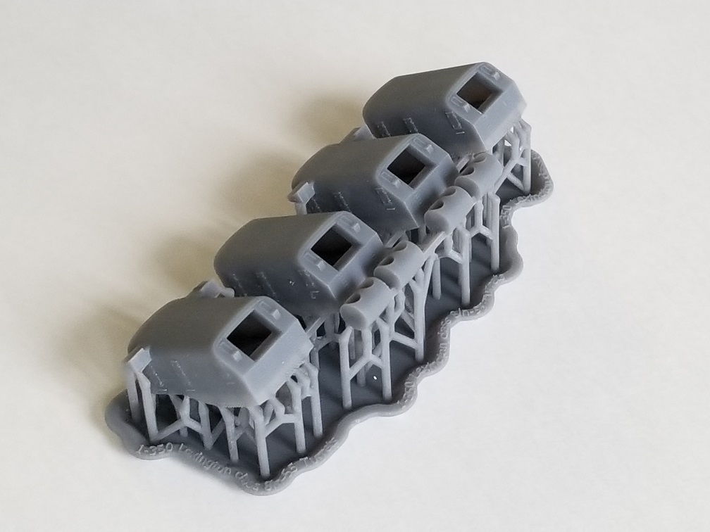

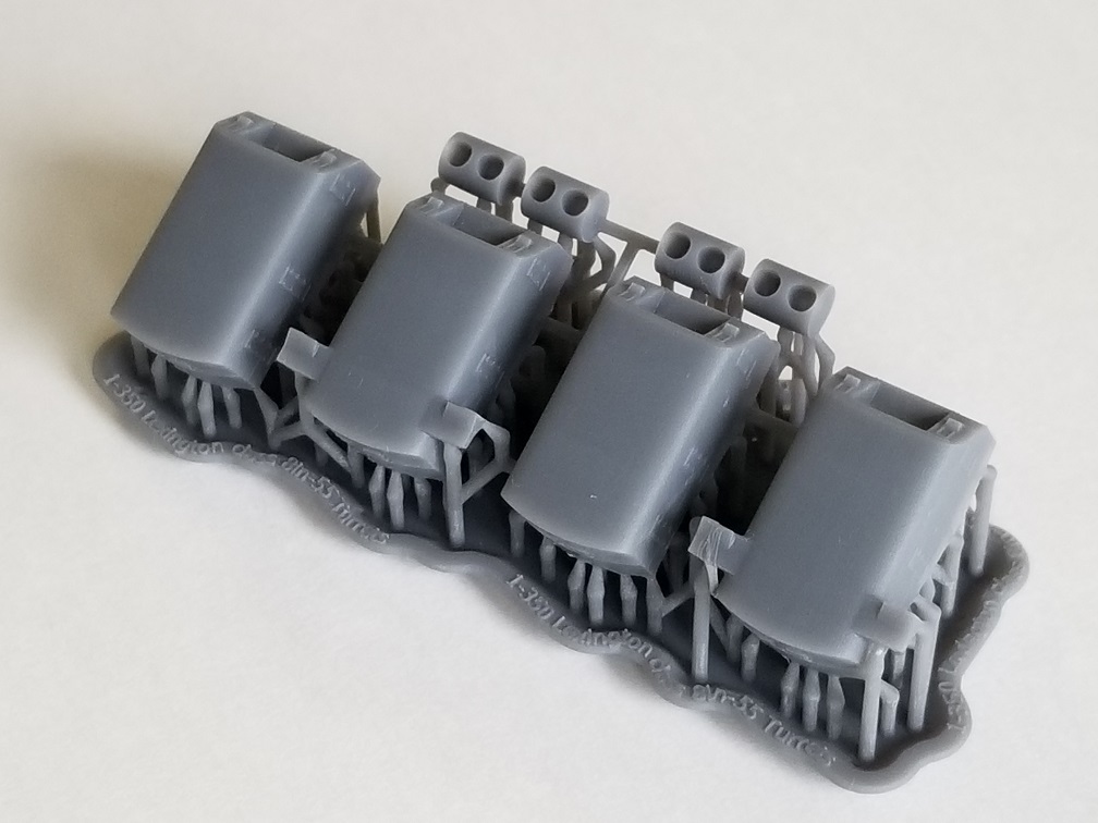

Hi Jon,

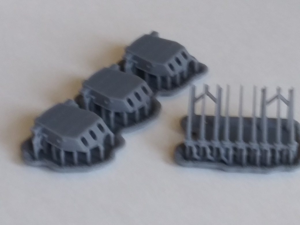

Good news: 1/700 scale Lexington class products are now available in gray resin, as are Pennsylvania class battleship products. Pennsylvania and Arizona products are also available now in 1/426 scale (1/429 true scale).
Lex funnels may be printable in 1/350 scale, but not yet certain. The 1942 funnel cannot be printed with the round-ended "Chicago Piano" positions' splinter shielding attached to the rear. The shielding will have to be purchased separately.

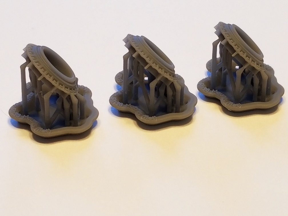

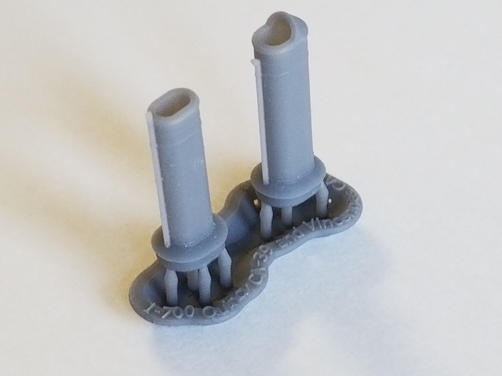

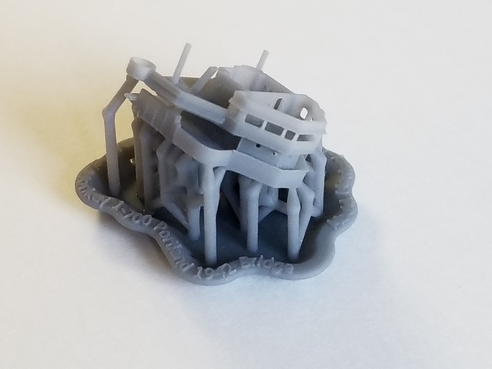

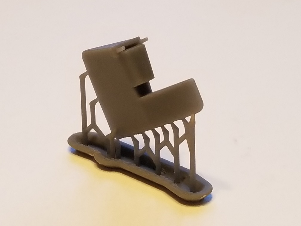

Here are some photos of recent printings of other products. None of the products in the photos below has been finished in any way. This is how they look when printing is complete and what the customer will receive.
Model Monkey 1-32 P-51 Mustang Exhausts with Shrouds a.jpg [ 167.53 KiB | Viewed 1172 times ]
Model Monkey 1-700 Vincennes and Quincy Funnels a.jpg [ 131.82 KiB | Viewed 1172 times ]
Model Monkey 1-700 Vincennes and Quincy Funnels b.jpg [ 132.19 KiB | Viewed 1172 times ]

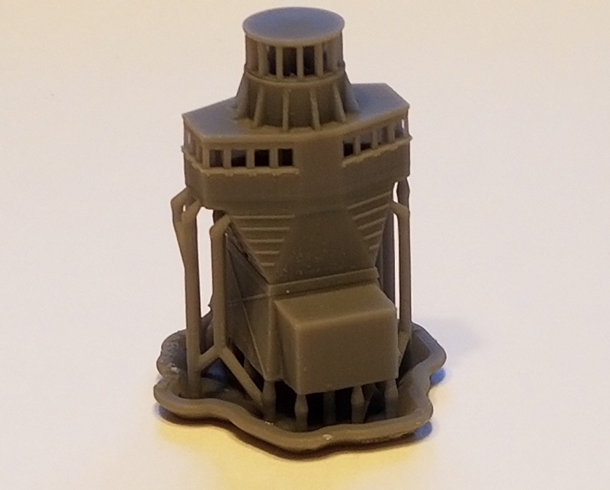

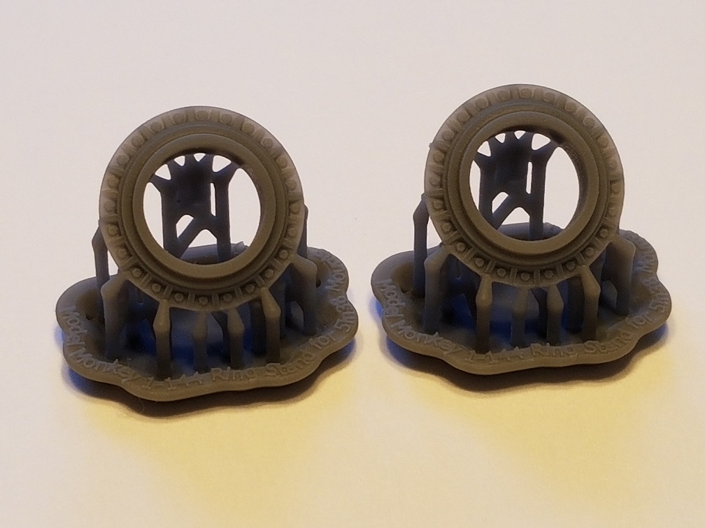

A few more examples:

A couple more 1/700 scale examples:
