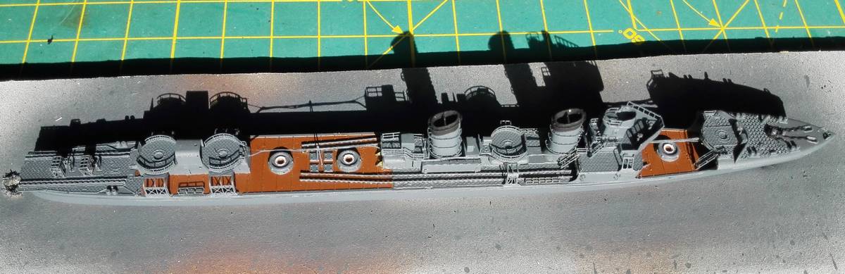

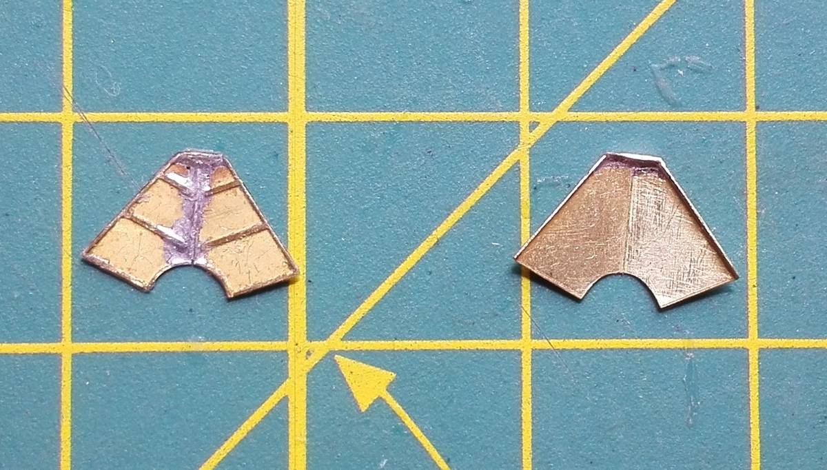

PostPosted: Wed Aug 15, 2018 7:44 am
Online
Posts: 797
Location: Czech Republic
Finally some progress done here! After some small details like pole masts fore and aft, details on foremast and mainmast, standing wires etc. I went for the last larger piece of the puzzle - the metal roof over the bridge incl. covering of the upmost part of the bridge windows. I managed to find a large enough piece of brass at last so I cut it totally new and adapted to the required shape as seen on the photos below.
File comment: (original part letf, new part right)
I should also cover some of the details not attached yet to the model:
Torpedo tubes
While the original Pit-Road TTs were quite good, I will replace them with the corresponding 533mm dual mounts from the excellent Pit-Road NE-04 set, adding only a sight and a „steering wheel“ to them.
Cutters & launches
I noticed the starboard boat and its respective davits amidships were missing on the Yunagi 1936 photos. Dan K suggested that their removal might have been only a temporary measure, but I noticed similar arrangement on a photo of Hatakaze in 1940 (1 cutter each side on the bridge and 1 motor launch amidships, just to starboard in case of Hatakaze). I checked the few wartime photos of either class but there seems to be no definitive answer once again. My decision was to show Yunagi with two 6m cutters and one 6m motor launch as on the 1936 photo as there was no other reference available. I had no replacement for them (the NE-02 set only has 7m long boats), so I have to use parts from the original kit after removing davit attachment holes from them. This I could not do really clean in case of cutters, so I will mask the remaining traces by placing life rings and oars over them. I also scratchbuilt a canvas cover over the motor launch from a piece of plastic.
Now everything is ready for a coat of Future (the roof will get some Sasebo Grey first indeed).
