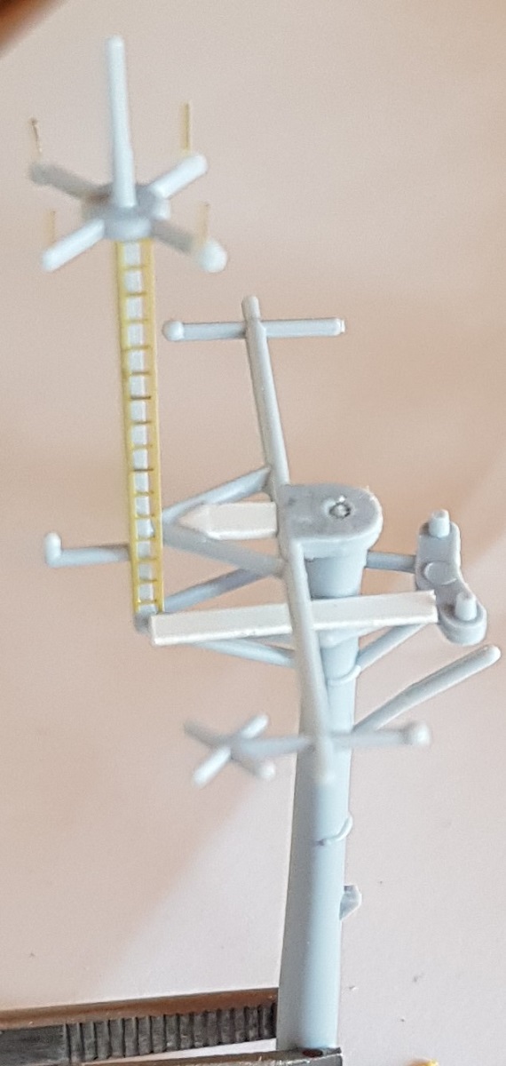

been doing some detail work...the mast
added walk way's for the marines ...on wich I can put small railings...like on the real one
the one in the middle is good...the other one...I'm not convinced...might try it differently...its 1 mm thick...means 40cm in reality...thats a lot for a walkway
