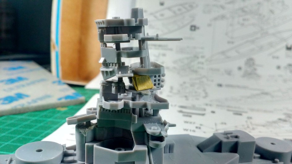

I want to assemble the bridge all at once temporarily. I successfully did that using using double sided tape, though i'm not sure if it will be easy to remove the tape residue from the plastic. Here is the fully assembled bridge without some small parts and details

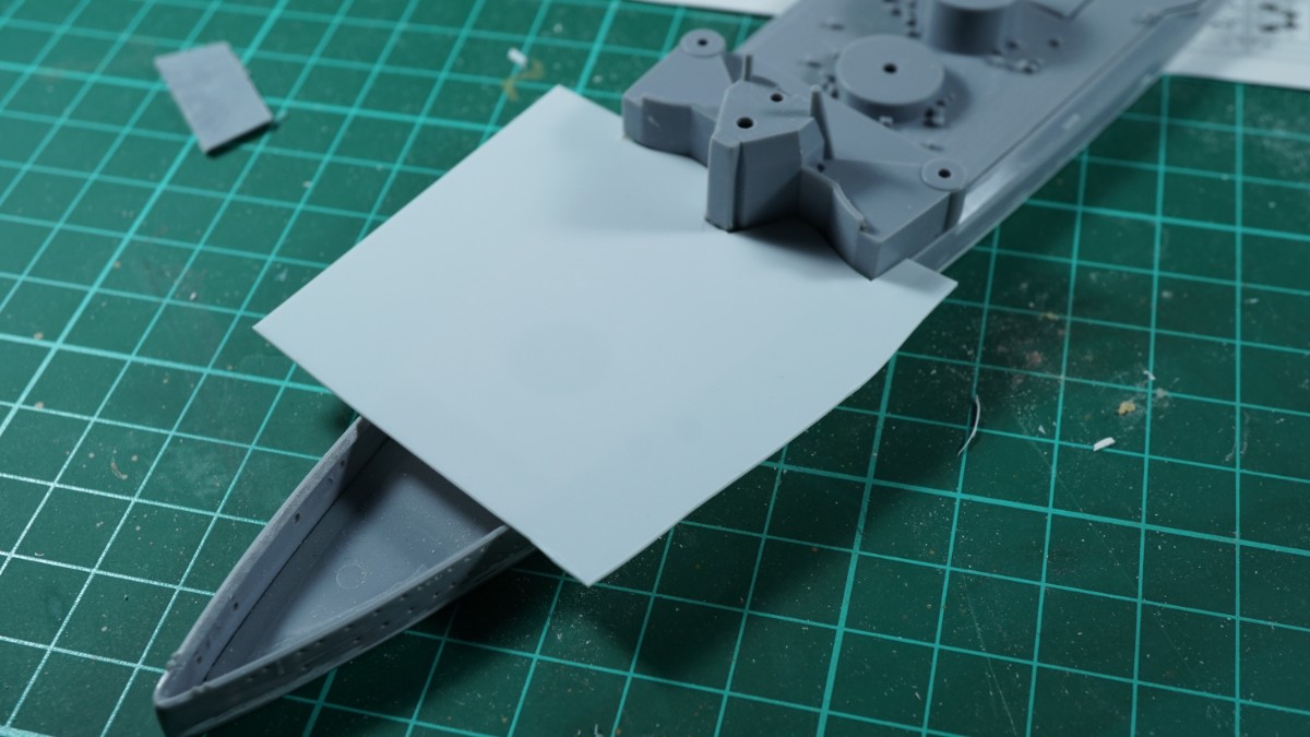

The progress was small, after some vacation and lot of work-related things. I decided to make the inner of hangars because i want to lower the elevator. So i flatten the deck below the flight deck and add flooring
But then i realise that it would be easier to finish the entire hull first. So i stop the hangar building and start working with the hull.

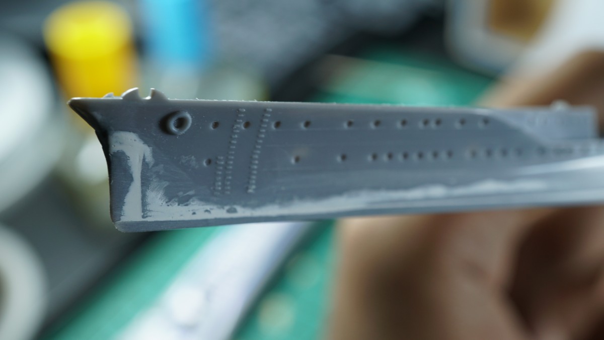

There are not much to fix, but each error require some good amount of efforts. The first one is to extend the bulge height to the deck. I use epoxy putty and finish it with some white putty. It works, but did not quite like the result. I failed to make the side angle 'sharp'. This is my first time to use epoxy putty to create shapes. After leaving it to harden for 12 hours, i sand the putty with metal file, but somehow the sanded putty sticks to the file, make it hard to clean :( I also close the gap of hull parts and waterline plate with white putty.
