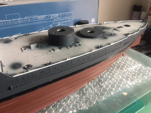

 Post subject: Re: At 'Em Arizona Fans!
PostPosted: Fri Oct 26, 2018 4:38 pm
Joined: Mon Apr 03, 2017 4:28 am
Posts: 50
Location: Newcastle, Australia
Hi Franz,
I tackled that on by running a bead of plastic strip around the deck edges.
download/file.php?id=102903&mode=view
Check out my build under the Works in Progress forum. I haven't made much progress of late due to moving house and an early retirement, but I had got to that part prior.
