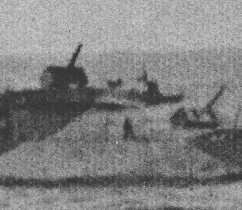

Just as a matter of interest Mike, my previous comment on small calibre weapons fit.
At Calabria and first half of 40, a single gun mounted on X gunhouse awning.
Very likely this single Vickers, the lower extensions on the pedestal may be what can be seen in the stern image.

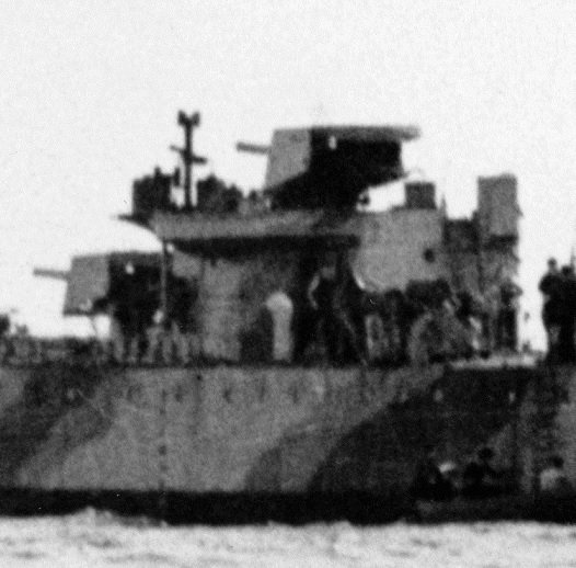

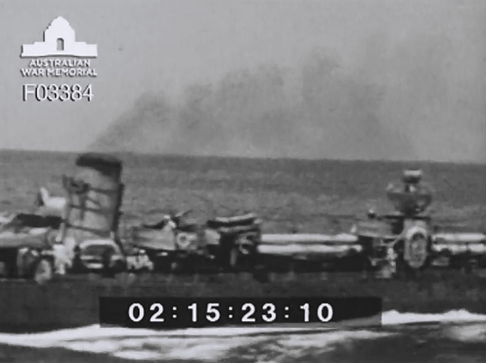

Hello all,
just wondering if anyone can tell me what the two objects on the Waterhen's rear deckhouse may be. I have marked them with two purple arrows. They are just aft of the upper main gun. They seem quite large, just as big as the 20 mm Breda marked in the same picture. A penny for your thoughts,
cheers, Will
PostPosted: Mon Oct 22, 2018 4:15 pm
Posts: 343
I think what we can see in your Waterhen attachment, the trailing blob is nothing more than an imperfection in the photo.
From the angle taken, I believe what can be seen in your forward question mark is a single Vickers in vertical position with magazine attached.
Behind the gun on the awning is a storage box installed sometime before going to Med.
The object forward of the gun is the collapsed galley exhaust pipe, they were hinged to allow training of X gun.
In my attachments, before you ask what the blobs are on the awning edge, they were some type of marker float, they donot appear to be present in the sinking image.
Your model is coming along nicely, your Breda will be on the centreline?
Cheers.

Thankyou Brett,
so you think there was a single vickers next to the upper main gun, and a twin down next to the lower main gun?. Is there a list/timeline of the modifications made to the Waterhen somewhere? I see there is a lot of information on the Vampire.
Yes the Breda will be in the centreline, between the aft standard compass and the 3 inch HA mount. Is that right, did the Waterhen have the aft steering and standard compass?. Those photographs you posted are great, where did you get them from - do you have anymore. I have been trying to get more from the Naval Historical Society but haven't had any luck of late. I am trying to install the myriad of voice pipes, wiring etc around the outside of the bridge structure so any good pics would help. If you see me going off course with model please feel free to correct!,
cheers, Will
PostPosted: Tue Oct 23, 2018 6:14 am
Posts: 343
Will, there are no lists/timelines of mods, if there were I wouldn`t pay much attention to them.
It was a constant evolution so to speak, our best sources of evaluation are images, ship log and ROP`s.
From what I see, yes, I believe it is a single Vickers on the awning similar to the one fitted on Vampire.
The gun on the Qtrdeck looks like a Lewis fitted with empty cartridge collector bag, but impossible to say for sure, and if it was, whether a single or double.
The Breda`s appear to be fitted on the centreline midway between the 3" platform/bandstand and the secondary conn, but images can be deceiving. The secondary conn was present on all the RAN V/W`s, it was identical in every way to the wheelhouse primary conn.
