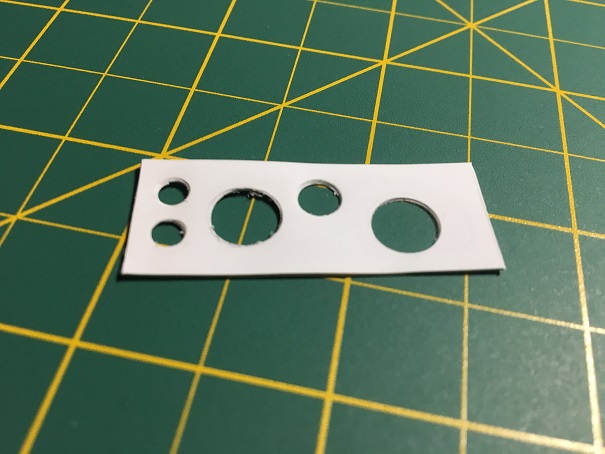

I have been experimenting on how to punch holes in sheet plastic for the stack cap, but it's not really coming out all that well.

Does anyone have a suggestion on how to better punch holes in the plastic sheet to be similar to the stack cap on DDG-51 Flight IIA's?
Thanks!
-Dave :thumbs_up_1:

DavidP wrote:what are you using to punch the holes?
I am using brass and aluminum tube in the appropriate diameter. I do not have a heat gun, but I have a hammer! I may simply need to sharpen the tubes so they can �cut� more than �punch� though the sheet. :big_grin:

DavidP wrote:sharpen the inside of the tubes' edge so that it has an inside bevel not an outside bevel so the punched holes have vertical sides not bevelled. the heat gun or hot air gun was to soften the plastic before placing the heavy flat object on top of it to flatten the distortion til the plastic cools. hot water should do same as heat gun or hot air gun.
Thanks much! I will give it a try. I think I will wrap sand paper around the brass tubes and sand inside of the punched holes smooth as well.

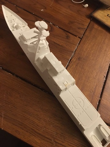

Here is a real quick mock up of the parts and pieces. Work on the stern boat deck is a little slow.
Again, the material the hull is printed from is rather tough. Once I get it cleaned out, however, I will begin construction of the stern ramp and boat bay.
The work continues!

After a lot of work, the shaping is done, and here is the bow cladding. Next here will be bitts, weld lines, capstains, etc...
Wow, this one took some effort :doh_1: The boat deck is now cleaned out. Thank goodness...
The stack cap was re-done. Good to go.
