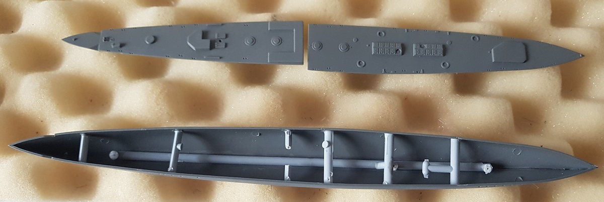

I like doing more ships at the same time...new project in the dry dock...a four-stacker I will do as DD301 USS Somers
first...hull...put together...and decided where black waterline should be cause nothing on mirage hull gives this line

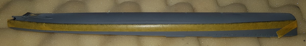

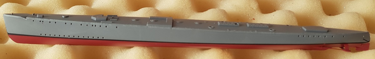

PostPosted: Wed Nov 28, 2018 12:08 pm
Posts: 1125
and with a little paint...it looks better
I must say these small mirage kits are more and better detailed than heller...

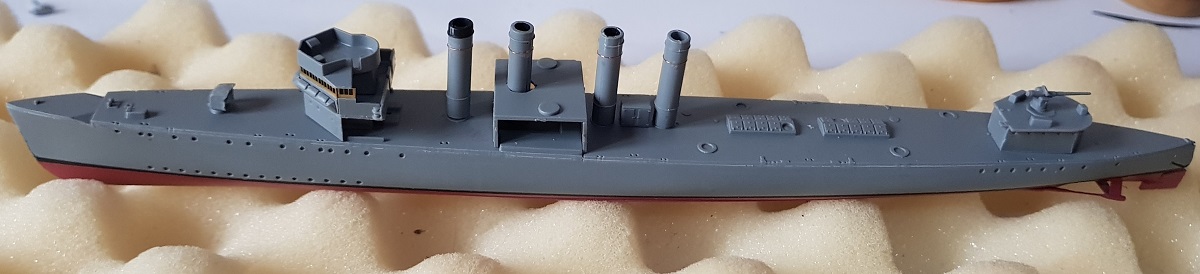

PostPosted: Fri Nov 30, 2018 11:58 am
Posts: 1125
a few things done...putting together...cut and replace...well...you know the usual stuff lol
above main deck its only dry fitted and fixed not more than 1 floor up
I bought the WEM PE4015 to complete and improve her....like the bridge windows

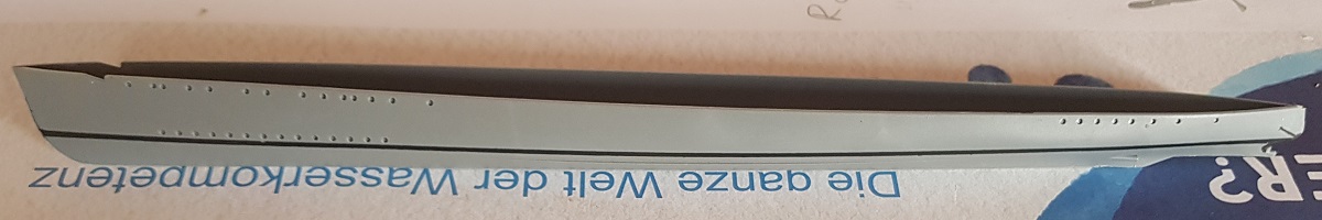

added rings on chimney's...did top of hull in light grey....not happy with it ...will have to see how gonna correct it

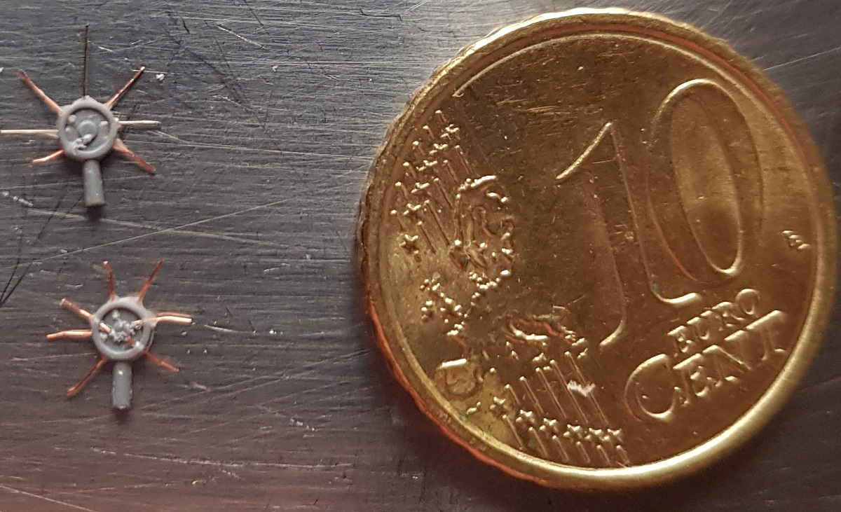

Posts: 1125
I just found this tread here ..Calling all USS Wickes and Clemson class Four Piper fans
gonna try doing many of the big scale details done and scale it down to 1/400...a nice challenge
a first small thing...the 2 stearing wheels...yes the handles are to long....will be cut to size ones dry and hard

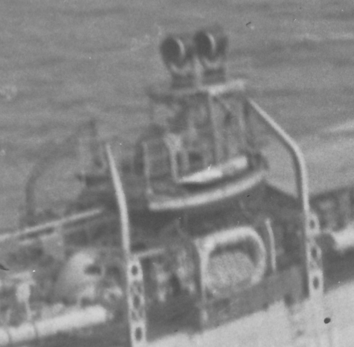

I decided to do her as she was mid 1920's...with the extra gun platform, just behind searchlight tower....like in the picture where she is with USS Langley...anybody knows how many and what guns she had on top of that platform?

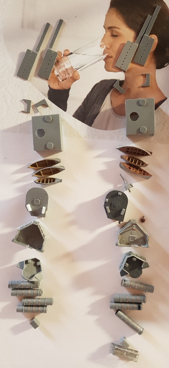

PostPosted: Thu Dec 06, 2018 11:17 am

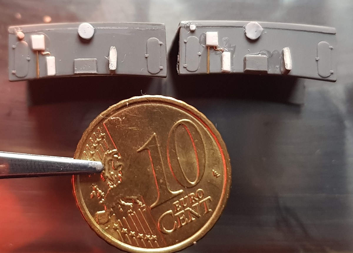

Posts: 1125
the little pieces...per ship and details done on 1...will have to be done same on other ship....don want jealousy in the family

Posts: 3841
To answer your question. As for the platform aft of the searchlight platform, I don't think that guns were mounted there. Look at the image third from the bottom on USS SOMERS (DD-301) Navsource page. Even though that area of USS SOMERS can't be seen, that area can be seen on her DesDiv sisters moored with her. A single water cooled 50-cal MG mounts would be seen, even if the gun its self was removed. See the attached image from another flushdecker in the mid-1920s showing the platform without the canvas on the rails, it looks like the platform was the aft emergency con station with minimal navigation equipment. Lewis 30-cal MGs may have been able to be used on that platform, but given its function, that is unlikely.

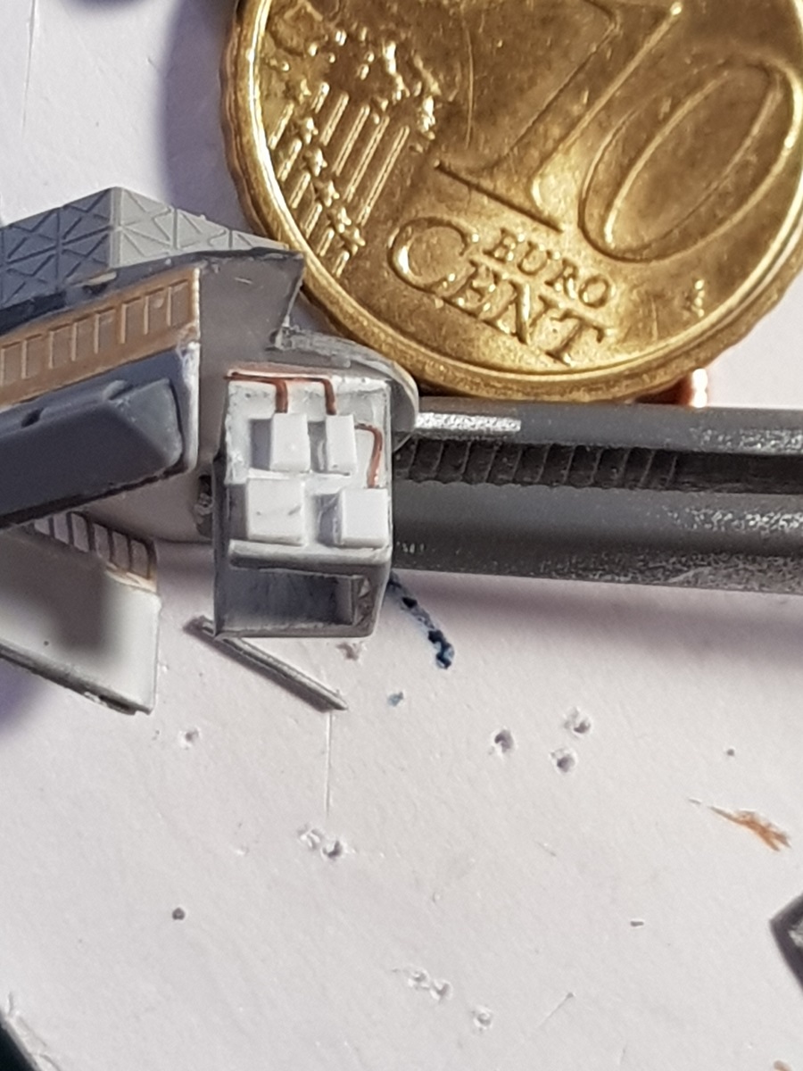

PostPosted: Sat Dec 08, 2018 2:03 pm
Posts: 1125
some stuff made scratch....like ammunition rack for main guns..I opted for a 5 shell reserve and not the 10 you see in some images, as she was only on active duty during peace time...5 rounds per gun is largely enough
added a small thing on torpedo launcher...will be used to fix an extra line on it

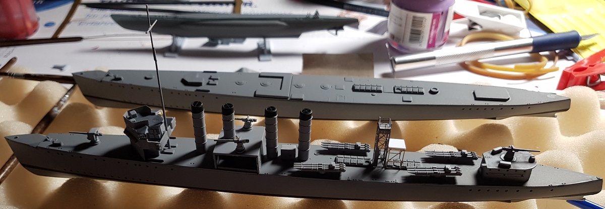

and a global view of the two, dry fitted
I'll be stressed ...have a deadline to finish them both..26 Dec

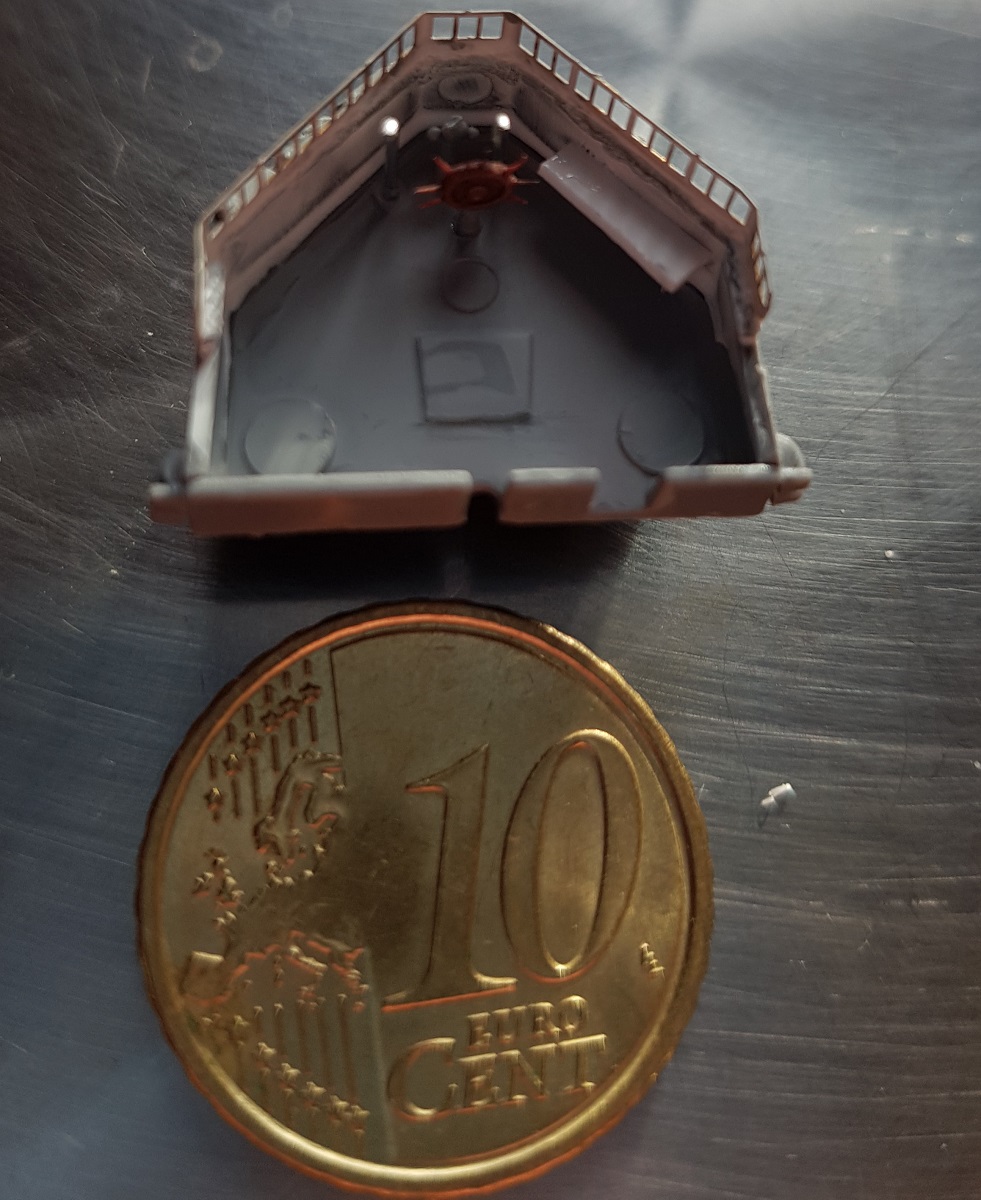

PostPosted: Fri Dec 14, 2018 2:19 pm
Posts: 1125
done a few super small things...I agree own input as no pictures show part in between 2 forward castles...well much modifications have been done and so many different versions of four stackers...so I just put some stuff I thought nice...it will look different once painted...but wanted to show how I made it
added a table and 2 pipes in bridge...painted walls white to give better visibility inside bridge
and of course...both ships same
