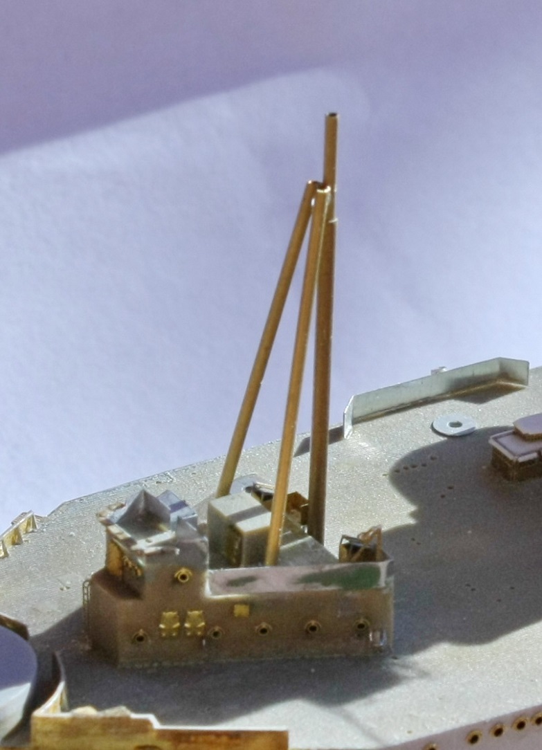

I have again made some little progress.
My next task was to construct the mainmast. For the tripod legs I used brass tube from Albion Alloys with a diameter of 1,0 mm and 0,8 mm for the struts. Precise alignment is of course very important and not easy.
The starfish was based on the one found in the Artist Hobby set. Some of the supporting triangular gussets proved to have holes in them, so I made my own from aluminium sheet. The platforms were fashioned out of fine PE mesh.
Various small fittings were added, among them another fine 3D printed HACS III from MicroMaster. The topmast is 0,5, the topgallant 0,35, the flagpole 0,2 mm thin. I used Master�s tapered yardarm with a maximum thickness of 0,2 mm.After painting railing (to the platforms) and Jacob�s ladder will be added. I will have to attach the thinnest rigging possible later in construction, for this mast turned out really delicate.

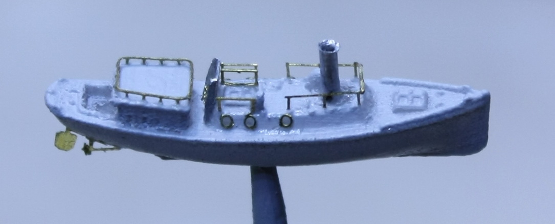

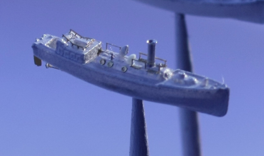

HMS Barham had a sizeable collection of boats. I could not obtain any information as to how many of them were actually carried on the day of her demise, so I decided to include all of them � with the exception of two cutters hung from davits as sea-boats � according to pictorial evidence they had been unshipped by 1941.
I started with the 50� steam pinnaces (capital ships like Barham usually carried two of them). These were quite old-fashioned by the forties and after their construction had been complete I found a photograph indicating that there was a newer-style motor boat in place of them but I could not figure out which type it was. Eventually I chose to depict the old-style steam picket boats. I had a great selection at hand as indicated by the picture below: on top there�s the resin version of Admiralty Model Works, below from left to right WaveLine�s white metal part clearly based on Tamiya�s old plastic boat found in their Hood or Rodney/Nelson kits, next to it the 3D printed version by Micro Master, then Trumpeter�s plastic offering and finally the resin casting by WEM.
If one tries to find the best replica of the real thing, MM�s 3D printed version wins hands down. Accordingly, it was the one I had chosen. It beautifully captures the original boat�s elegant sheerline � a point missed by all the other manufacturers. All the details are spot on, except for the positioning of the cowl vents � I reversed their diagonal position. The biggest flaw is the coarse surface of the 3D printed part. Although I have tried to improve it by scraping and careful sanding, it is very evident in close up photographs, less so in real. I replaced the funnel with Albion Alloys� aluminium tube. A flare was given to the top by careful use of the burr shown below.

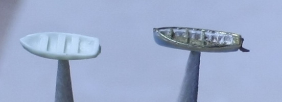

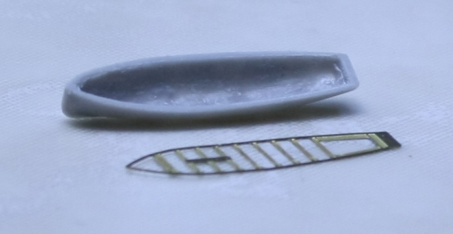

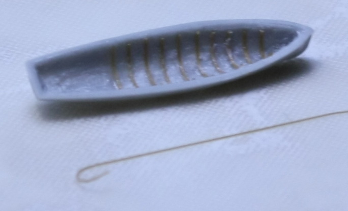

Next came the open boats. The 42� sailing launch and the 32� cutter were based on Trumpeter�s plastic part and constructed along similar lines. First the inside was carved out,
then ribs from stretched sprue were glued inside,
next the inside was painted off-white, weathered (there�s no way to access this part later).
I added boards and PE gratings to the bottom, painted,

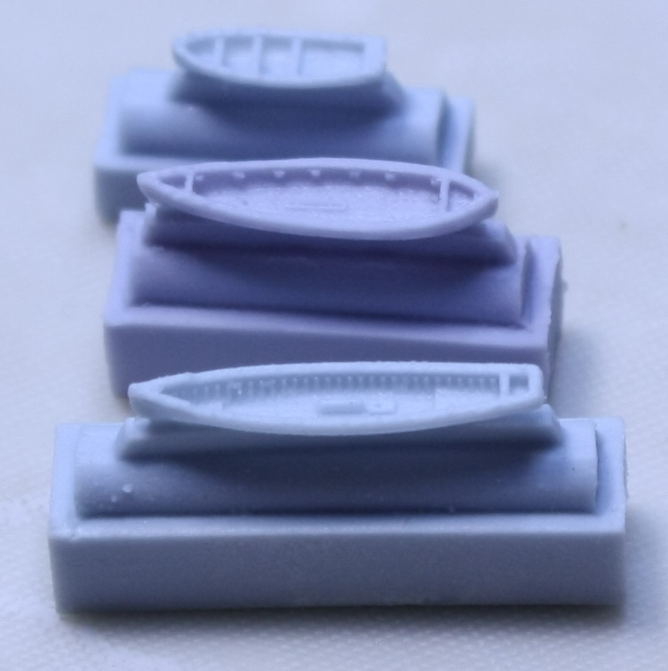

The ship also had three 30� gigs, a 27� whaler and a 16� dinghy. I was fortunate enough to be in possession of Admiralty Model Works' beautiful resin items (now practically impossible to come across),
so these were used with their respective PE details (the only additional work done was thinning down the sides and adding stretched sprue rubbing strakes), except for the dinghy which was detailed using Artist Hobby�s PE thwarts. In the photographs WEM�s respective item is placed next to the boat shown for comparison.
30' gig:
27' whaler:
16' dinghy (this one's really tiny):
