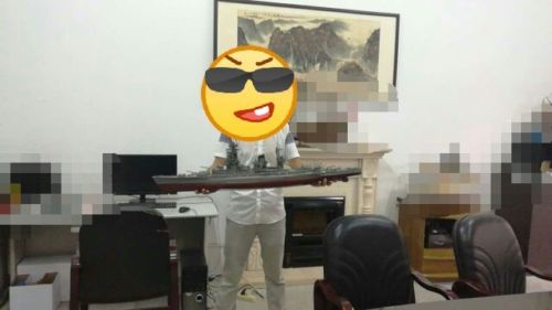

1/200 Nagato in the works....
Building 1/200 Nichi.'45
viewtopic.php?f=59&t=152105
PostPosted: Thu Jul 20, 2017 10:57 am
Posts: 7284
Show and Tell at work? :smallsmile:
Looks cool. And sizable.
