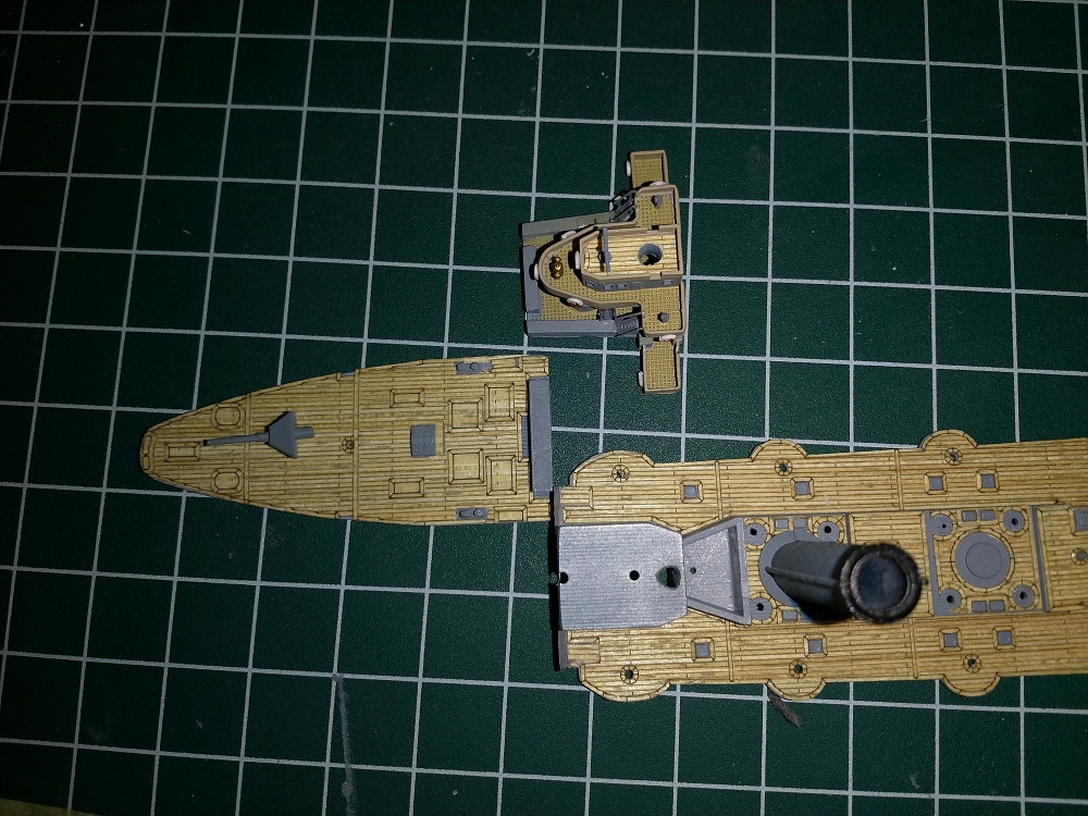

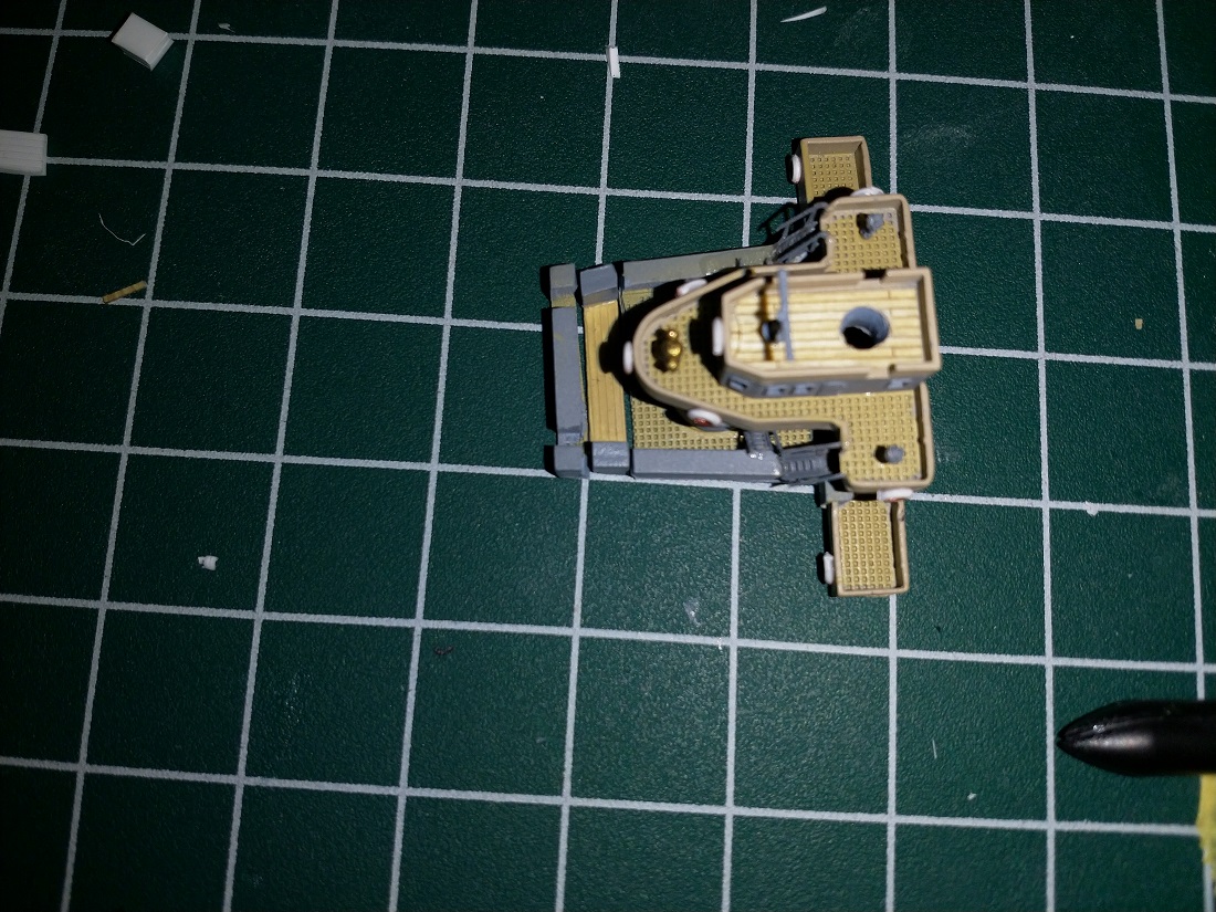

Here are pictures showing the deck pieces separately, for comparison. Nothing has been glued on yet. Is there anything else you can suggest that isn't too complicated?
I was thinking of putting a deck over it, and some added PE detail would be nice to make it look realistic and disguise the abyss, but then it's not the Aurora, if you know what I mean.
This YouTube video (in Russian only): https://www.youtube.com/watch?v=xihQ5-jvdq4 is a build log of the original plastic kit. His deck looks different, because where the bridge ends there is an abyss but no walls around it like my one. But his bridge covers the entire area anyway right up to the funnel. My guess is that the bridge in my kit too small maybe. ARK doesn't seem to care, as in the previous post picture the abyss is clearly there and they haven't bothered to correct it.

If it wasn't for the application of the wooden deck, some scratch-building with sheet, and strip plastic, and re-positioning of the funnels would work. But not so easy now.

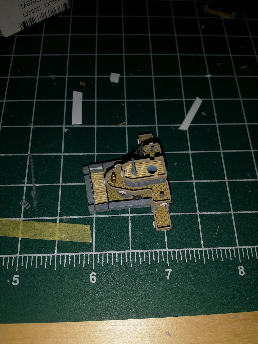

Thanks for the analysis Darren. I still don't really understand. Do you mean bringing the bridge back like in the pics below? (cutting the long piece on the foredeck and moving that back as well) Have to take care of that wall ending on the main deck, where a stepladder goes on either side.

Close.
leave the main deck the way it is.
Extend the deck above by cutting the block and moving it forward.
You will also have to extend the side blocks and the deck itself to match.
Then the bridge will sit closer to the stack like you have it in the last photo.
Not a perfect solution, but it may save you some work and look reasonably decent.

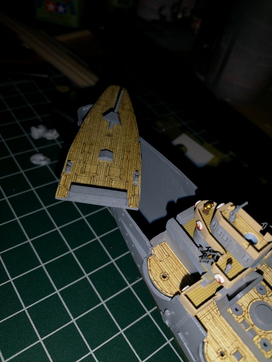

Ok so I've made a good attempt at this but it still looks very rudimentary. I bought grooved styrene which looks close to deck planking, cut a length of that and stuck two pieces of thick styrene on the ends to represent the bulkhead borders. Painted it and this is the end result. Haven't glued it together yet because I don't like it. It doesn't look right because the rest of the deck around it is mesh flooring. Any level of scratchbuilding is really beyond me unfortunately, all I know is how to stick pieces together and paint them.
I could make more attempts, but I can't replicate that mesh decking and without that the scratchbuilt piece will stand out by a mile.

I think your "mesh" flooring is actually a criss-cross wood planking on the deck. In any case, you put your replacement decking running side to side instead of fore and aft as deck planking should usually run. If you've still got the scrap wood from the decking sheet you can cut out a piece to cover the entire area (original and scratch) and draw on a grid with fine point pen, or pencil, to imitate the plastic grid deck.

I think it looks pretty good for a first attempt.
This is where I find scratchbuilding fun, look through your parts stash for a bit of photo etch that looks like the floor grating.
Radars, flight deck netting etc, cut to fit and glue it on top of the new floor piece. But make the floor piece out of plain flat sheet.
A couple of suggestions,
First, Attach a new floor piece to the main section. Make it a little longer side to side, so that the sides stick out. Make sure to align it vertically so that any PE grate you put on will sit flush with existing floor grate.
Now attach what you have found for the floor grate, making sure to align it to the existing grate and that is sits flush with the existing grate.
Next, attach the new side block extensions, ensure they follow the same angle as the existing pieces. leave a bit extra extending fwd over the new deck piece.
Then, sand/cut/file flush across the whole front end. Do the same with the cut edge of the piece you cut off. Sand/trim until the cut piece sits flush with the new extension pieces.
Next, glue the front piece back on to the new extension.
When dry, sand the sides and top smooth and fill any remaining imperfections with putty and sand smooth again.
Darren (Admiral Hawk)
