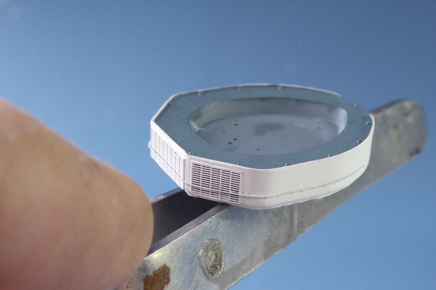

that of having the lifeboat deck faces made as photo-etched overlays
This has been pretty much wholly successful--but not alas without its own minor pitfalls (!)
But I digress--more of that later in this update ( cutting perfect PE ! )

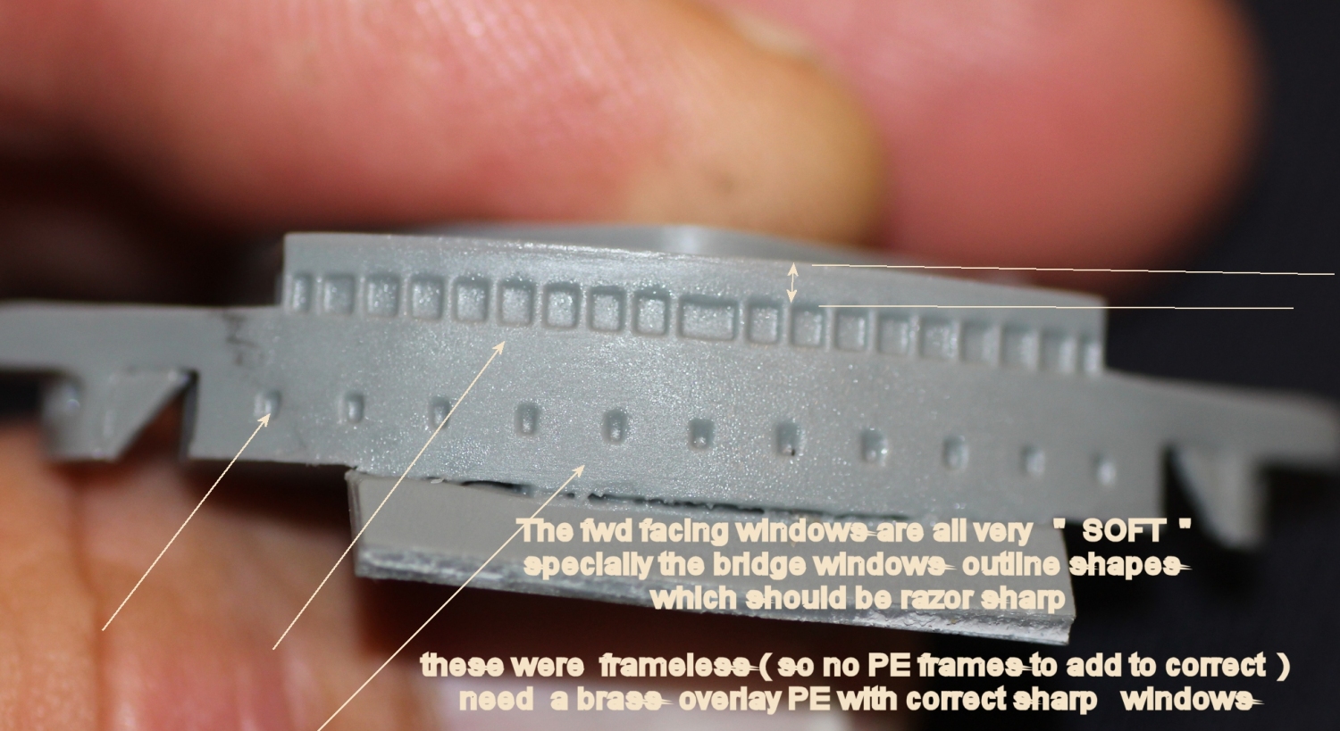

The three small square windows either side would not be covered by the PE--
these suffered from being not ever so sharply cast alas

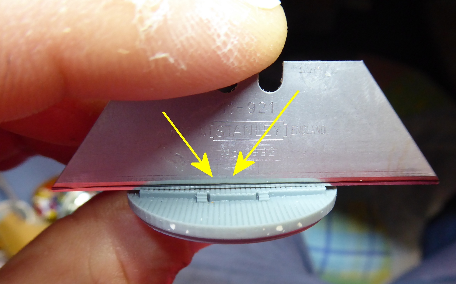

cutting these accurately was surprisingly tricky - I used the reflection of the PE in the cutting blade to get it mostly right
The slightly imperfect remainder was held in my flat tweezers ( padded with Tamiya tape )
and sanded with 1500 blunt sandpaper until flat

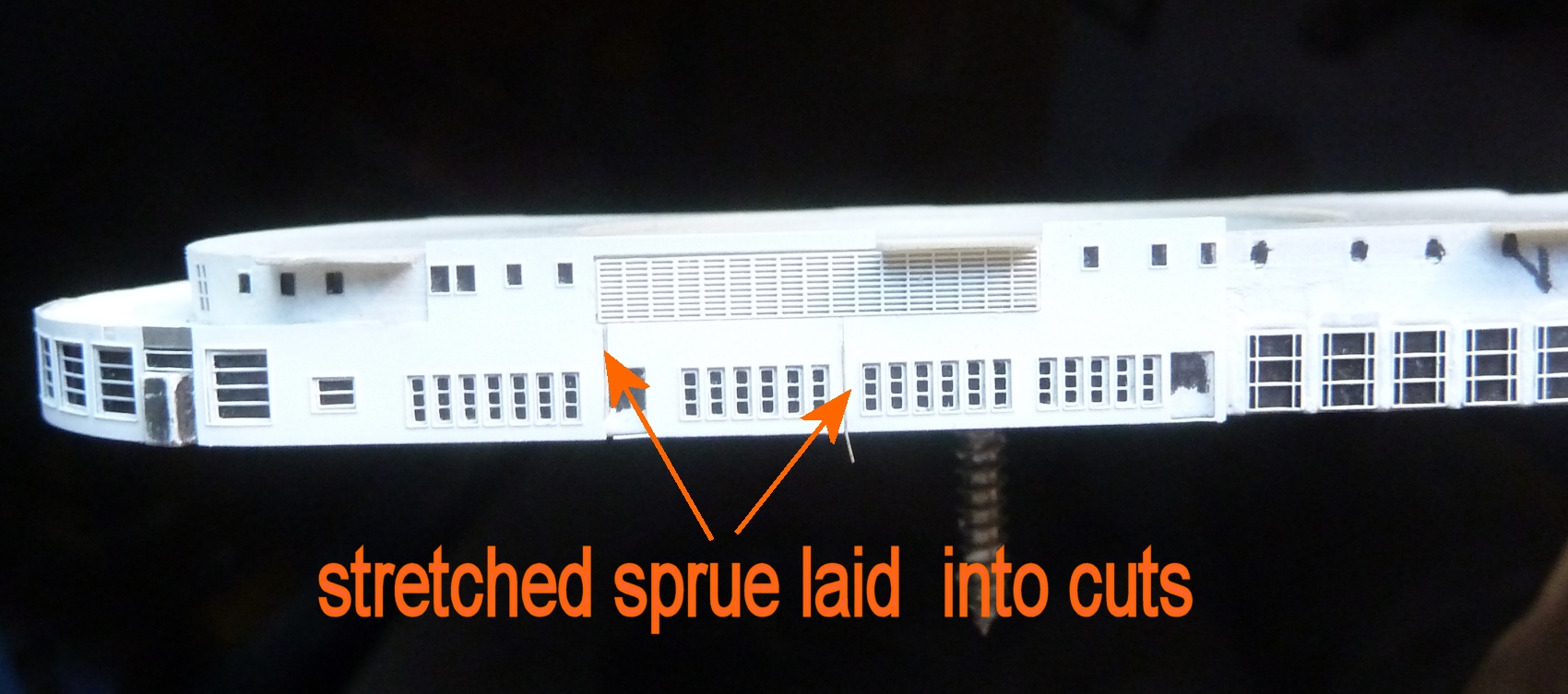

There was a missing window on the casting - above the entrance vestibule
I cut open my PE above the vestibule , inserted a section of window and closed the gap with s/s PE
Offering up my spare PE on the originally supplied funnel deck
( not the-replacement funnel deck )
was a wise move as it fitted well

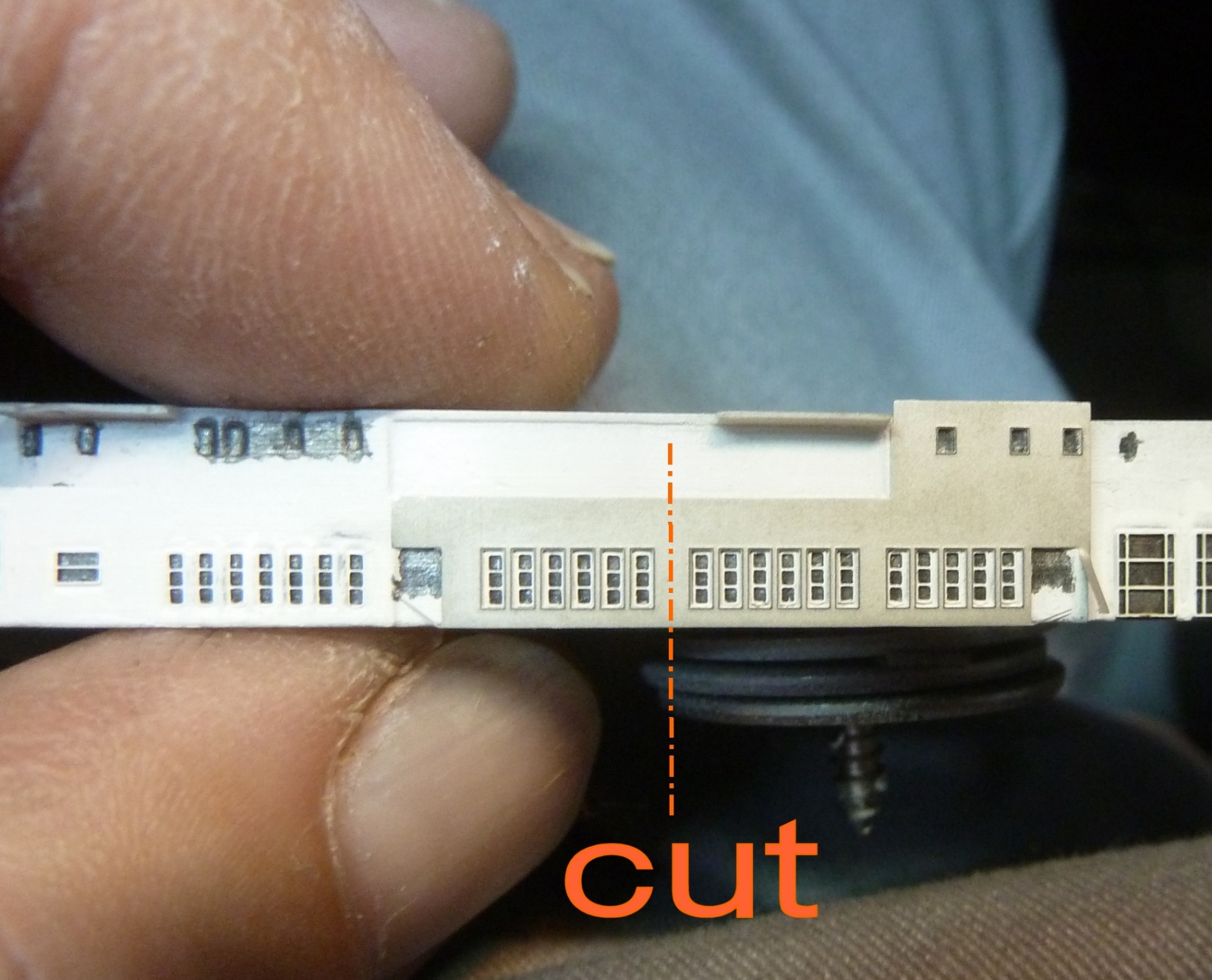

BUT-- as there was a MINOR discrepancy between the the two castings ( o,2- 0.3 or so mm or so overall )
the new deck casting being fractionally smaller ( as evidenced by the packing piece at the bridge end) (albeit it would have needed some of this this anyhow!!)
This threw out the window mullion centres ever so slightly but progressively
This required very very small amounts to be cut out of the PE to get the window mullions to align
The cuts were closed off with stretched sprue which after the first coat of paint will be pared
and sanded flush before the next coat.
The entrance vestibule had window frames cut down to size from spare items of the fwd winter garden

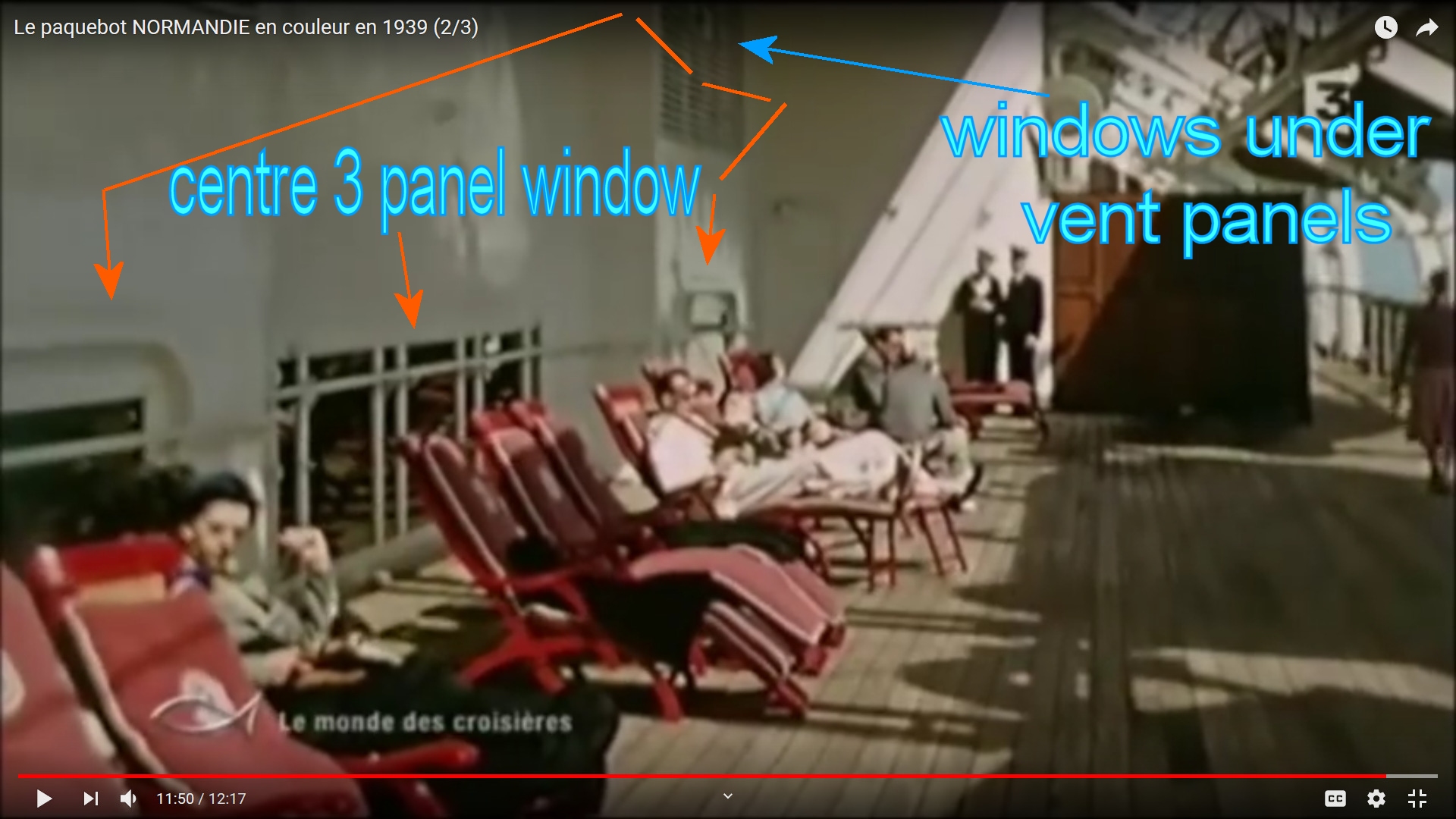

( at the bows)windows. This area is poorly photographed; and is not easily visible in aerial photos either as the after-most davit and boat usually obscures the view
The casting accurately portrays the hollow in the outside wall ==> kudos!
the solid part of the vestibule I made of vinyl tape
Note the hollow to the outside wall has now been added well that is it so far -- some more updates as they happen.
