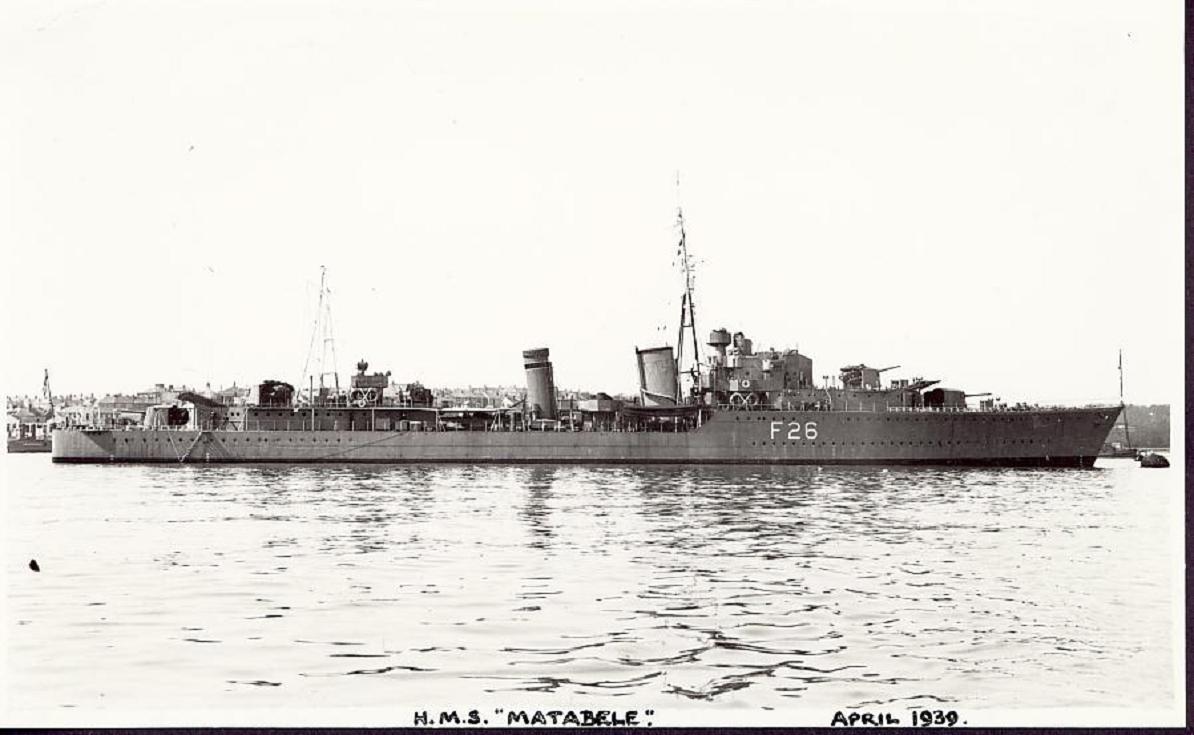

Nice shots Rick, thanks for posting.
We are both on the same page, I actually trust your uploads as not being tampered with more than the majority I see, so take that as a compliment. Also a good explanation presented.
Going back to your original post, you have used the word `deceptive` we can both agree, I can also agree with you that the shot could fall within the timeframe between transition of flotillas and also the fact that she could be lighter than 507A at that particular time.
She does look a bit weather beaten, some parts of the super are darker than others.
Having said that, except for a short period before the end of 41 in which she appears a light tone before going to disruptive, I have seen no other shots to suggest a lighter colour for 1940.
Perhaps someone else will provide a reference image to possibly substantiate your suspicion.
Touching on my previous Matabele images, I would expect we can also both agree that her presentation appears a darker tone which could quite easily be 507A.
Unfortunately, many seem unable to accept the variables involved or that digital images are manipulated, nor the fact that 2 separate images which appear different tones can actually be the same colour.

To me the overhead view of Matabele looks like a peacetime photo dating to the early/mid-summer of 1939. I note the tall stanchions and frame supports for the canvas awning that was rigged to cover her deck aft as she swanned around the Channel at that time are in place (see attached photos).
I very much doubt that on a calm sunny day in wartime, with aircraft about, her pom pom and quad 0.5" would be so firmly covered up the way they are. I think that with the awning stanchion in place it would be impossible for her to fire her torpedoes. Less easy to be sure about (maybe Rick's original has better resolution) but are there any ready rounds in those neatly white painted holders at deck level around A mounting and does the depth charge on its projector on the aft deckhouse have a canvas cover on? Jack and ensign staffs are in place and overall she looks very tiddley.
In the summer of 1939, given the painting instructions then in force via the Fleet Orders, as a Home Fleet destroyer there is no colour that she could have been painted other than Home Fleet grey.

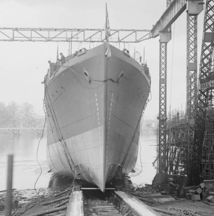

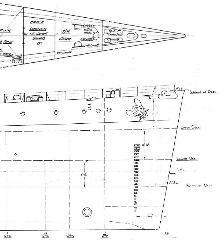

On the previous page an interesting docking drawing of Athabaskan with circular diaphragms in the forepeak.
For those interested, these were in fact `MK II Type C, SA Oscillators`
The drawing presents some confusion, as A/S implies Anti-Submarine, the correct terminology is SA (sweep Acoustic)
They were Fessenden oscillators for acoustic mine sweep and detonation.
The Fessendens were reciprocal devices, they could make noise but could also be used as receivers, whilst information abounds on Fessenden development, little to no reference is available on the PD pertaining to SA oscillators.
The Algerine and Bathurst class minesweepers were fitted with a single MK I Type C located internally in flooded forepeak stem.
The twin MK II were fitted in a number of escorts, destroyers and some cruisers, the exact number is unknown and probably never will be.
It is speculative that they were fitted to certain ships as added protection to group/cruiser screens entering forward hostile areas where sweepers have been unable to clean before hand.
As fitted drawings are no guarantee of fitting, as is their absence at launch.
It is of interest that Warramunga`s `as fitted` drawing stamped June 43 shows them fitted but their is no evidence that they ever were, Modified Leander HMAS Hobart as fitted drawing stamped Jan 45, after her repairs and modernisation, shows their installation.
The attachments show Bataan, workmen in preparation to fit MK II`s, plus HMIS Cauvery (modified Black Swan class) fitted at launch.
