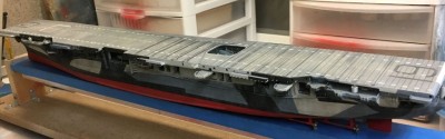

On my Trumpy 1/350 Handcock with an Artwox deck, I removed the cat tracks and made replacements out of 0.010 thick plastic.

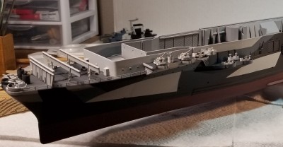

Not quite ready yet, but what color were the 20 mm & 40 mm armament painted? Were they painted to match the camaflouge color where they were mounted or were they painted a neutral gray color?
PostPosted: Fri Dec 14, 2018 2:41 pm
Posts: 8346
Nice looking model.
They were painted to match the surrounding camouflage
