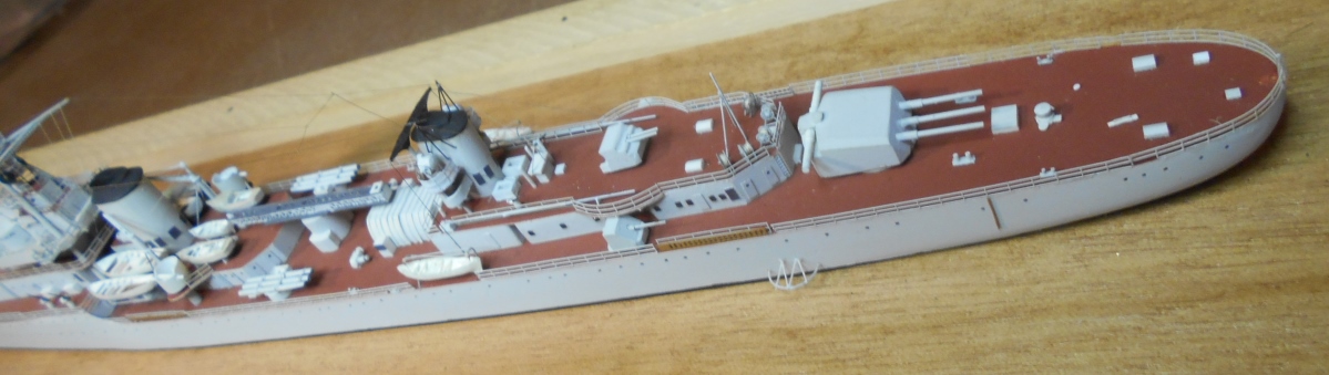

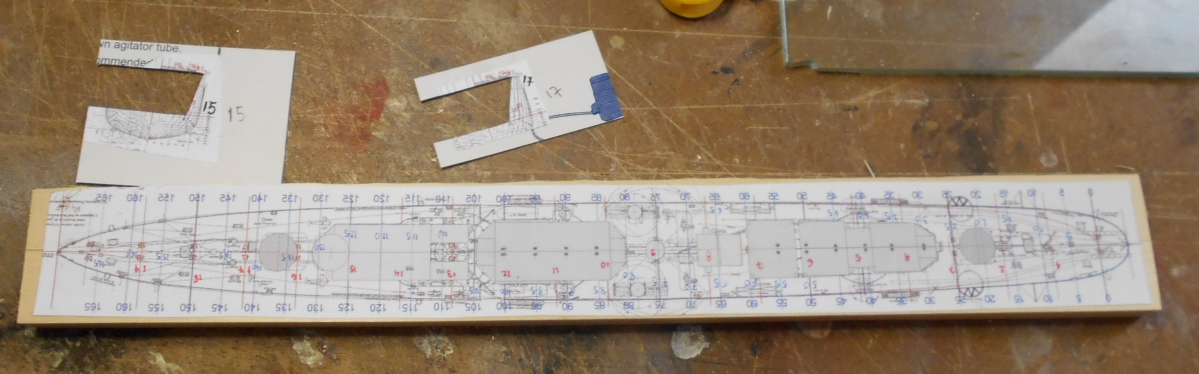

EMILE BERTIN

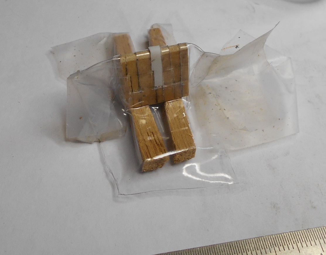

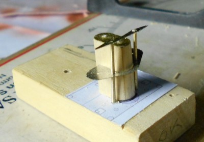

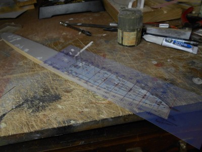

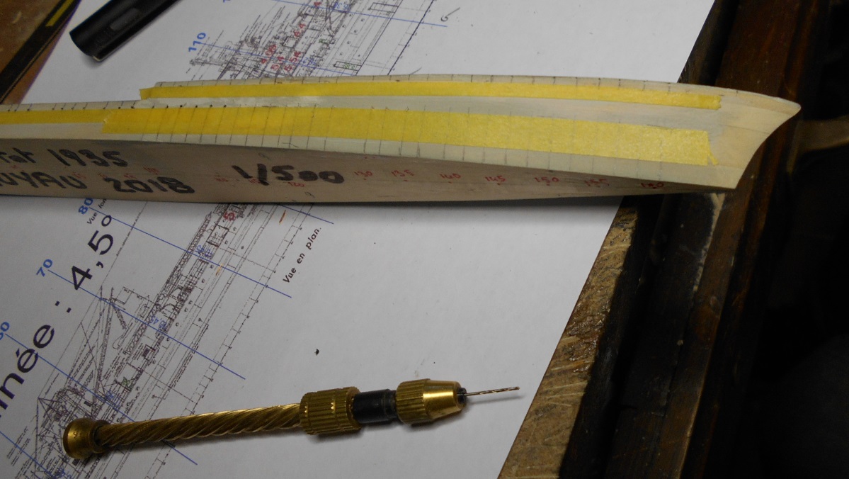

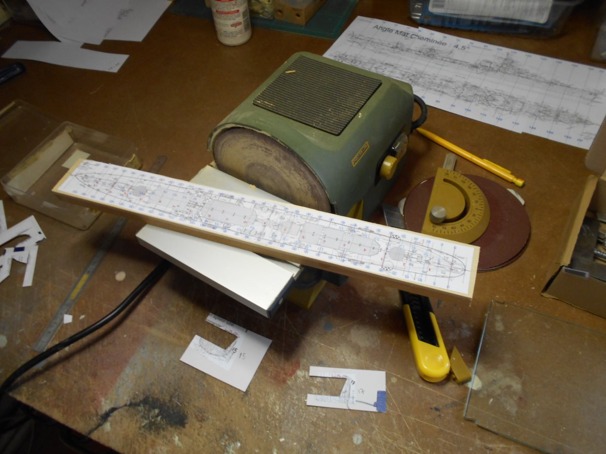

The hull is made with a plank of polar wood
When I get the horizontal shape I pin point the place of fittings using the plan printed on transparent paper. So the position will be accurate

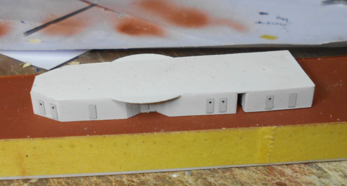

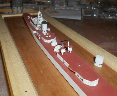

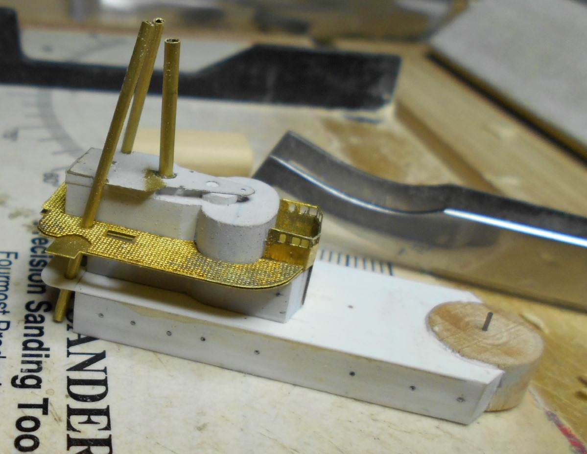

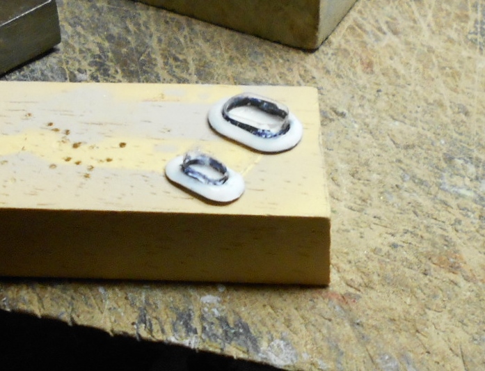

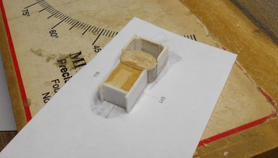

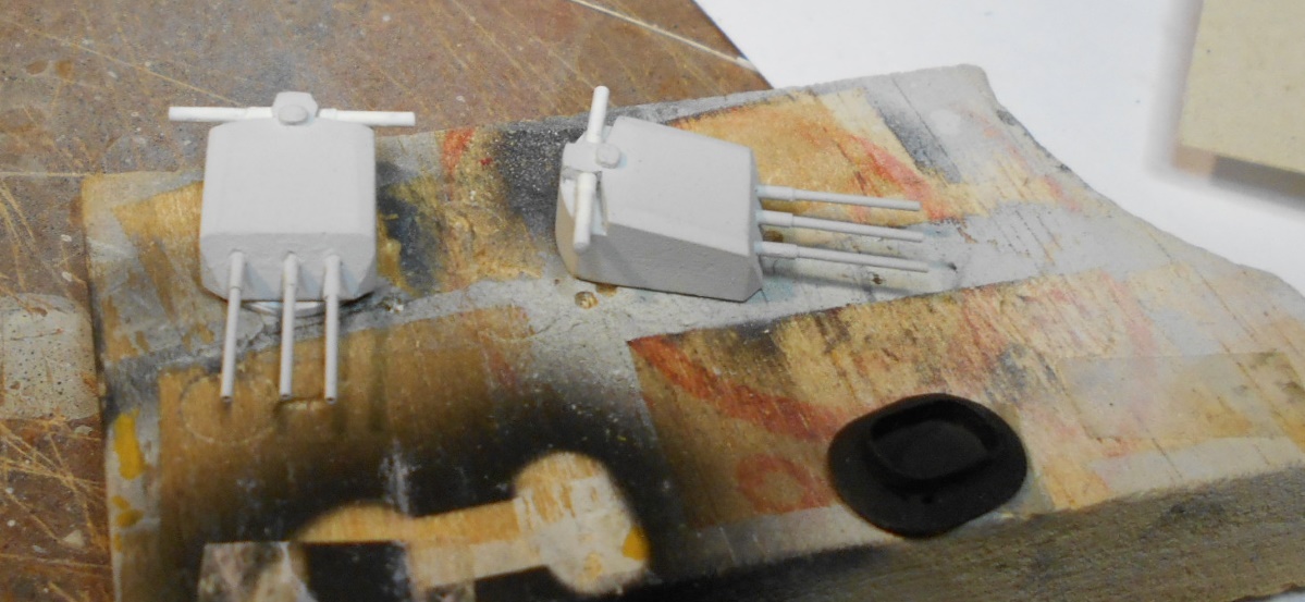

This time I made the superstructures with plasticard instead of wood planks
I drilled rhe portholes using tamiya tape

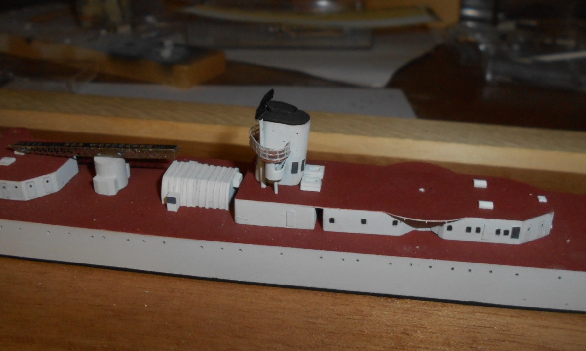

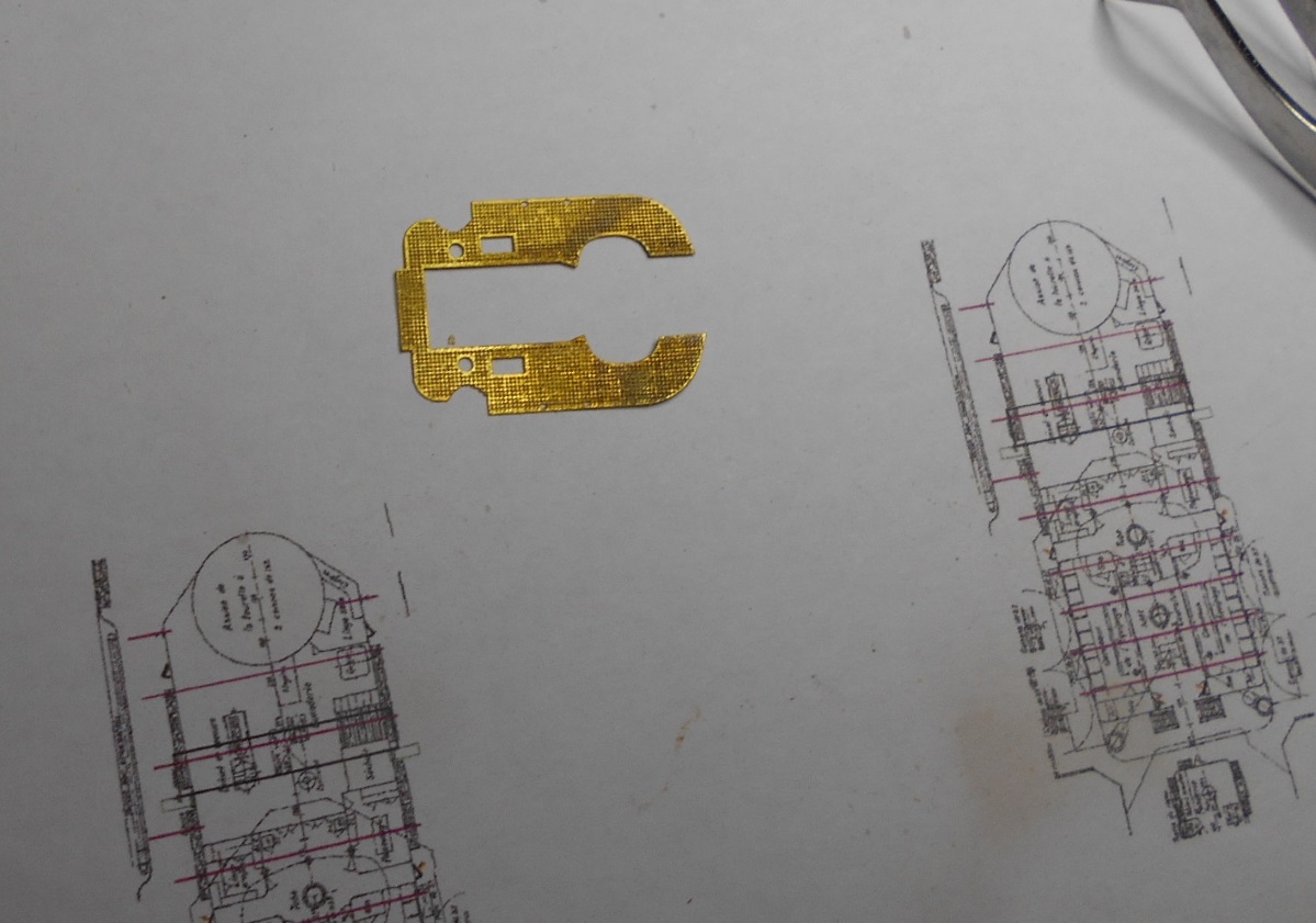

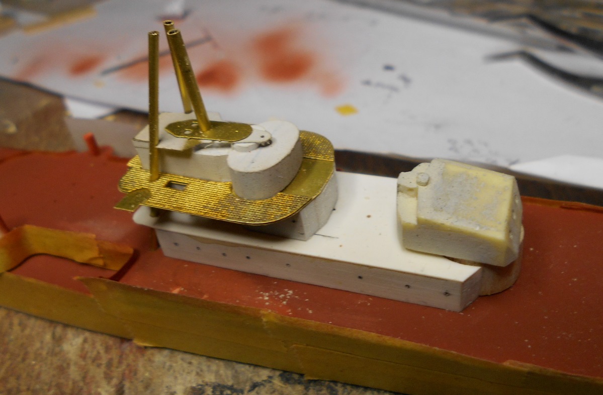

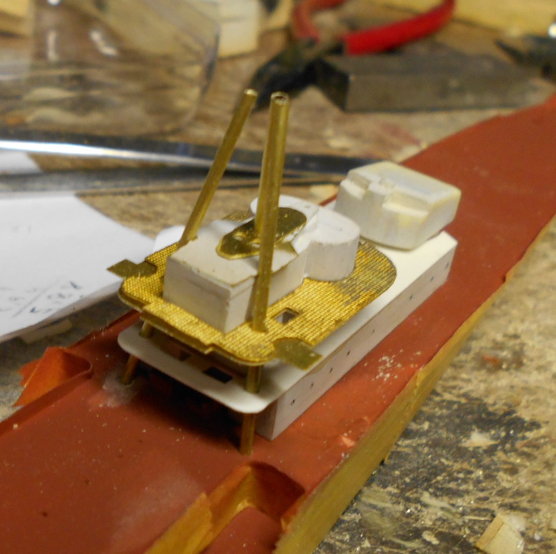

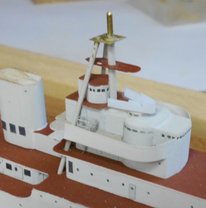

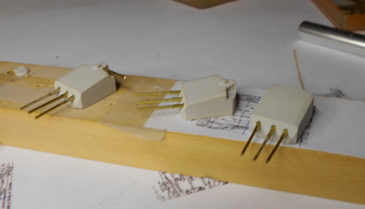

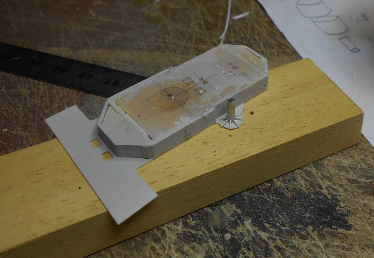

I dry tested the superstructure and the platform around thz after funnel.

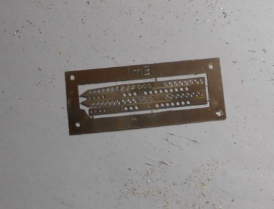

The planking on the bridge is perforated custom photo etch
JIM BAUMANN
Posts: 5689
Re: 1/500 French Cruiser Emile Bertin
Post by JIM BAUMANN »
That is looking good -- nice PE-- is it yours...?

setori
Posts: 307
Joined: Wed Feb 25, 2009 8:31 am
Location: france
Post by setori »
Thank you !!!!!!
yes it's mine

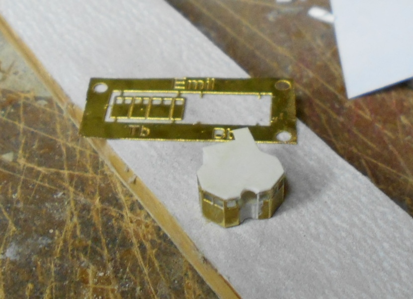

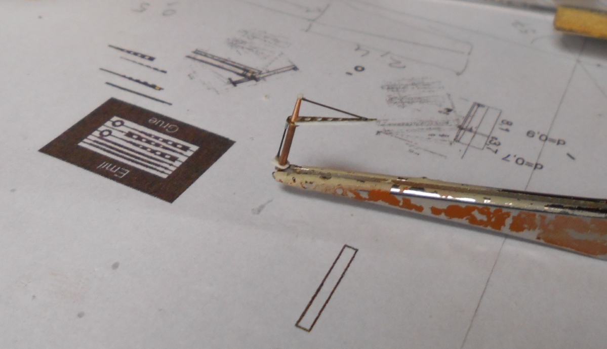

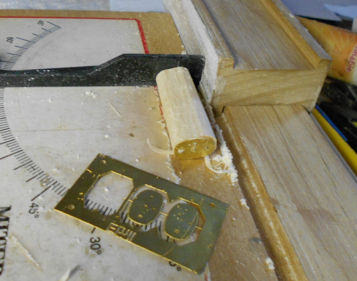

I've made some fittings
photo etch for the navigating platform

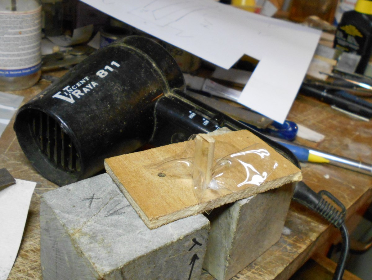

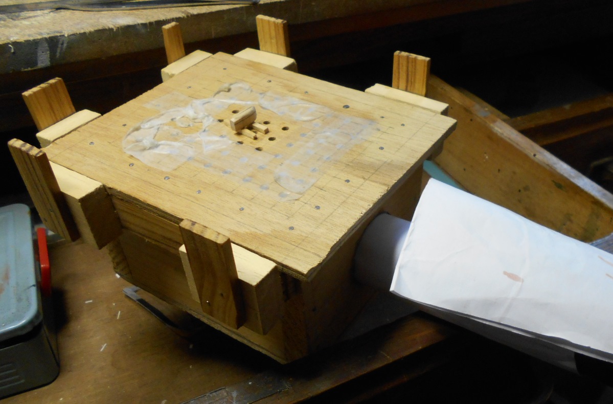

The funnel caps are vacuum formed using an hair drier

The admiral shelter with photoeth for the sides

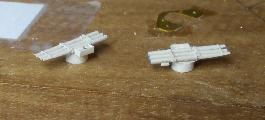

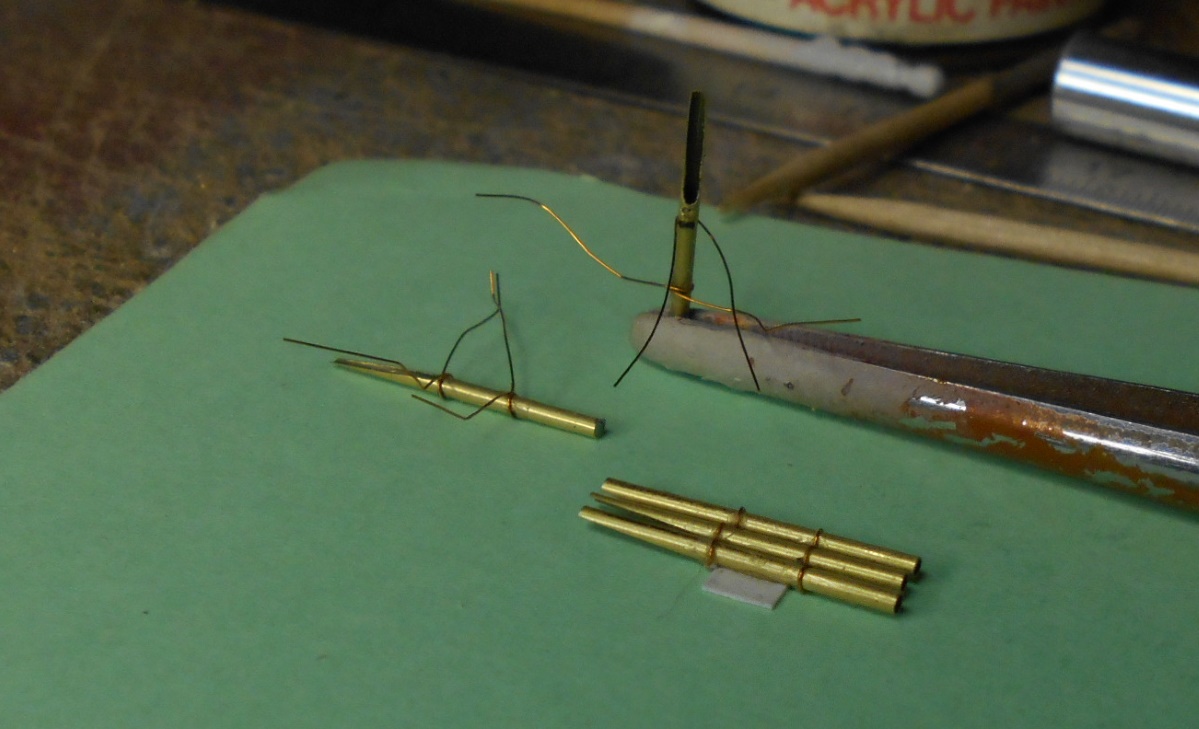

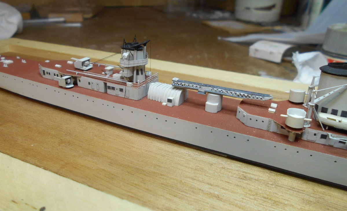

The torpedo tubes were made with "albion alloy micro tube"
I used custom photoetch for the boat crane

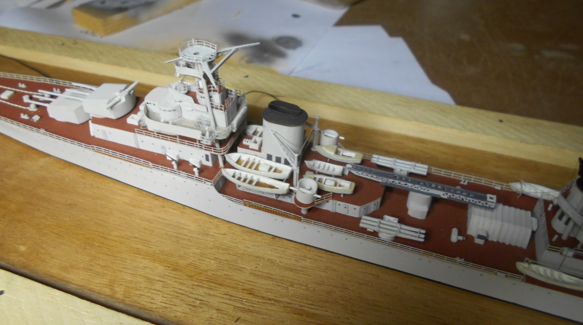

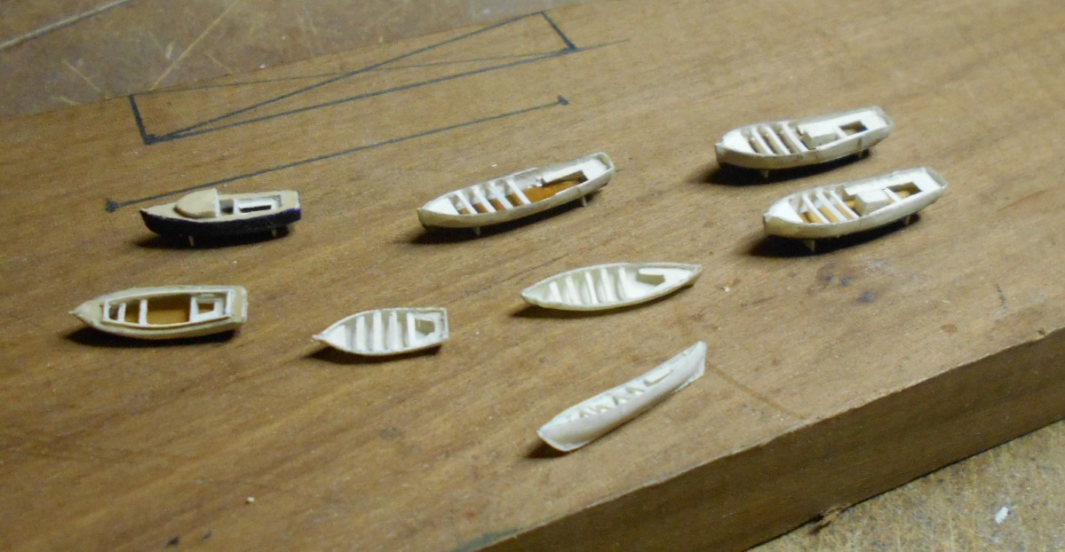

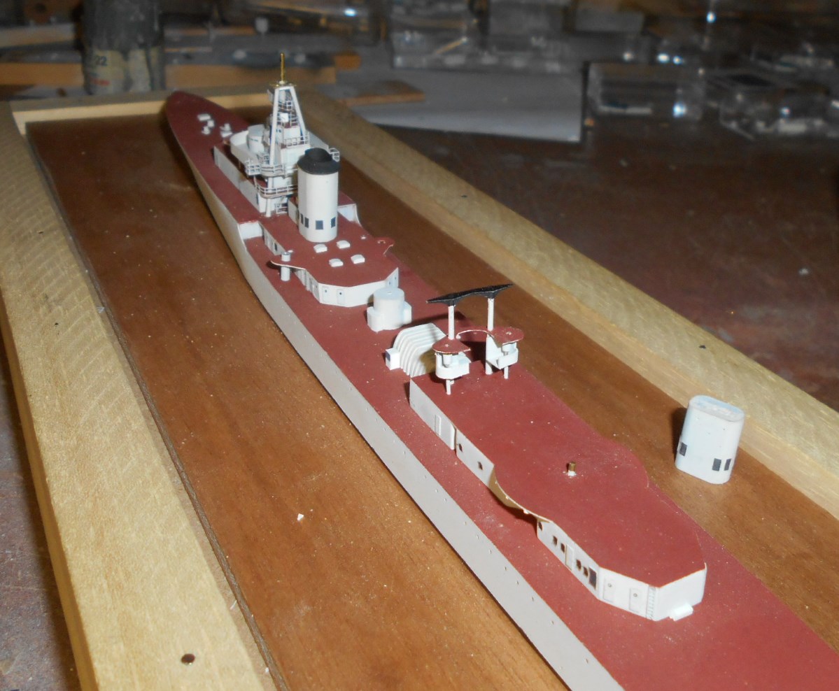

I vacuum formed the boats and 2 are glued in place,

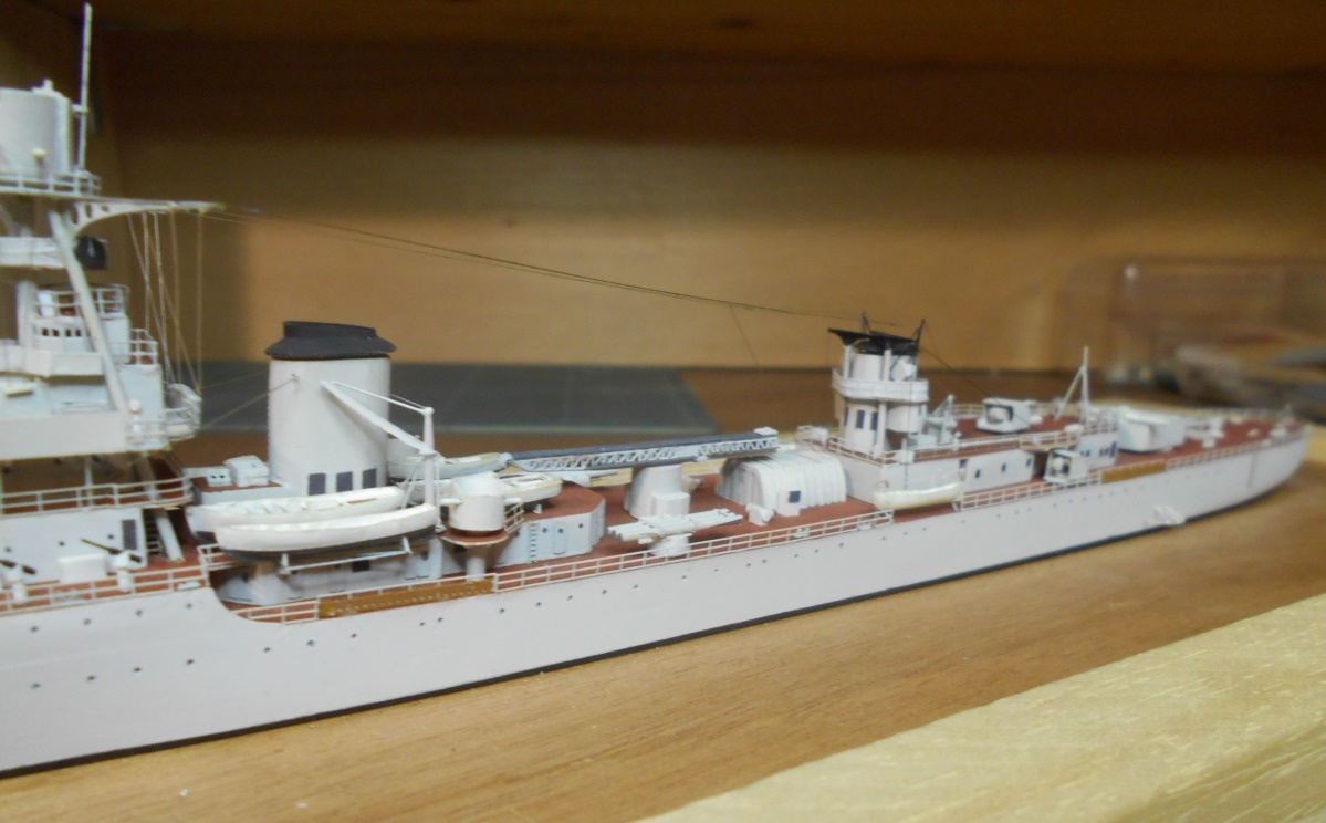

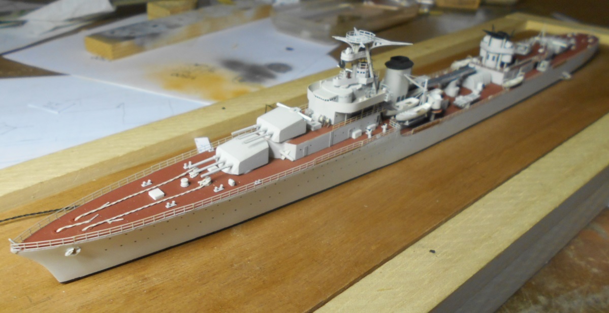

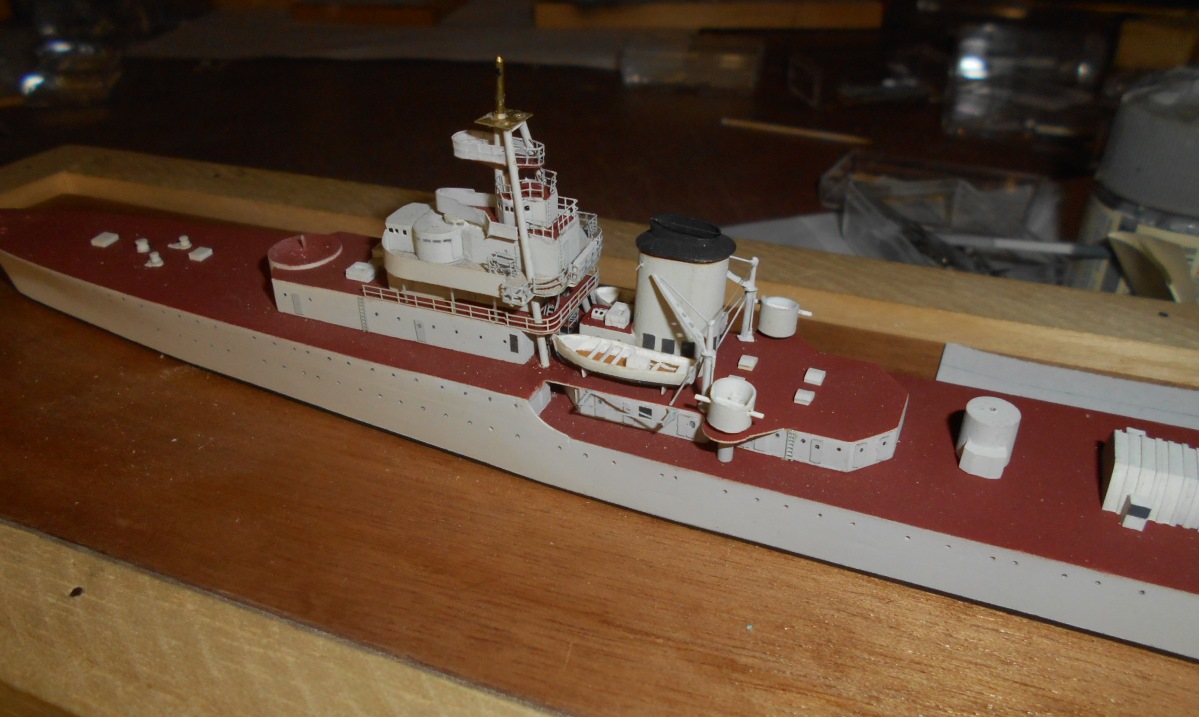

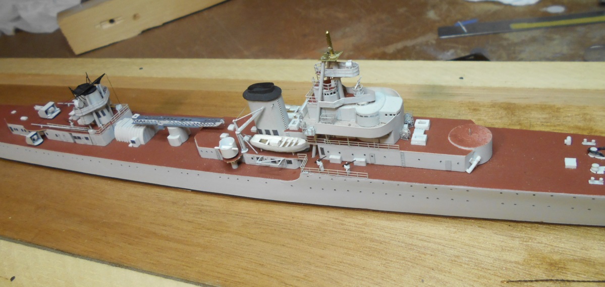

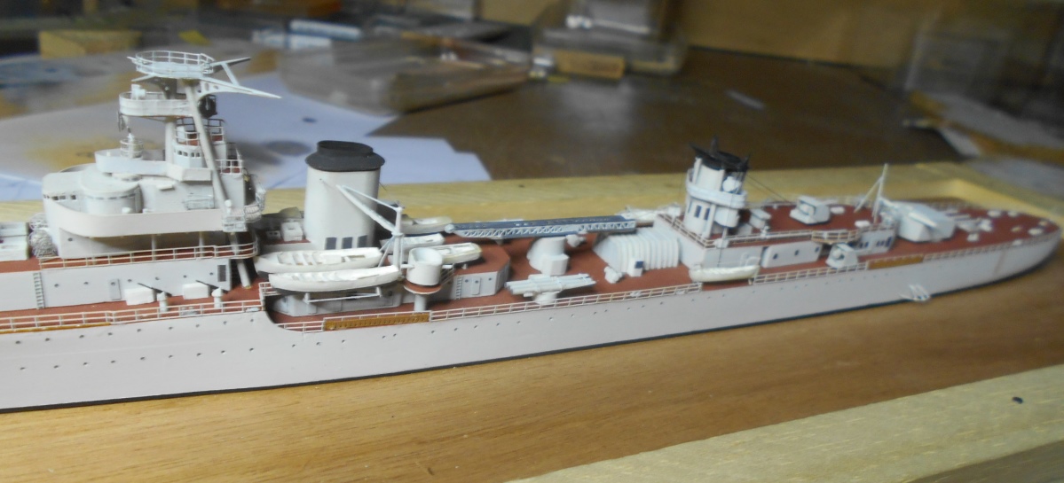

Almost finished ! I still have to make the riging, glue the director and some machine guns
I made some photoetch for the hawser reels

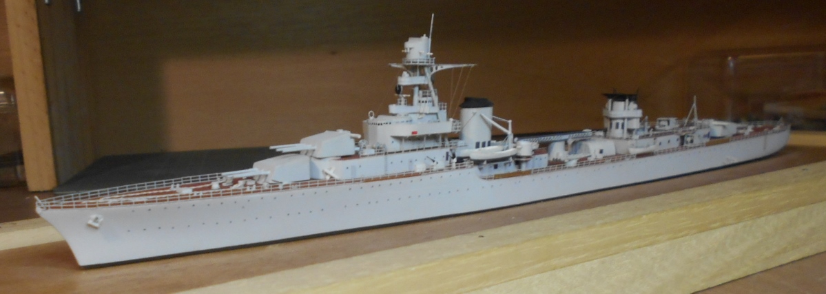

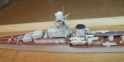

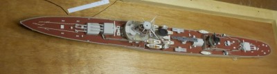

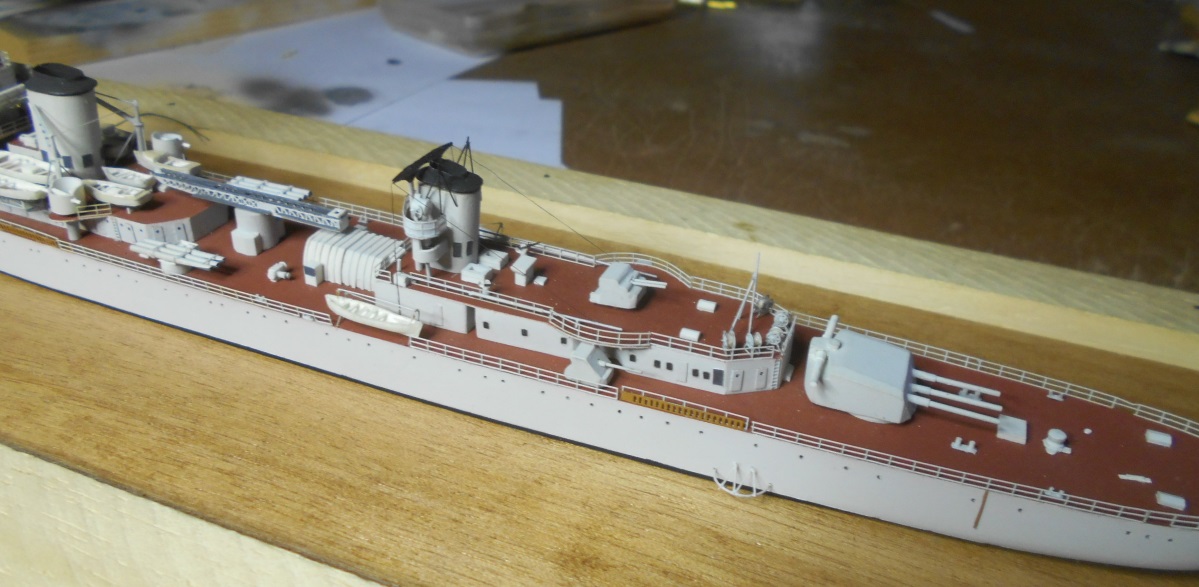

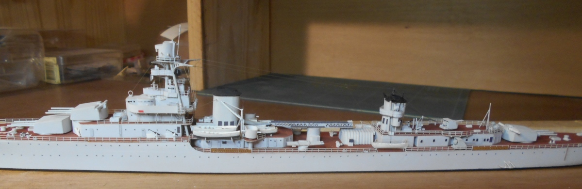

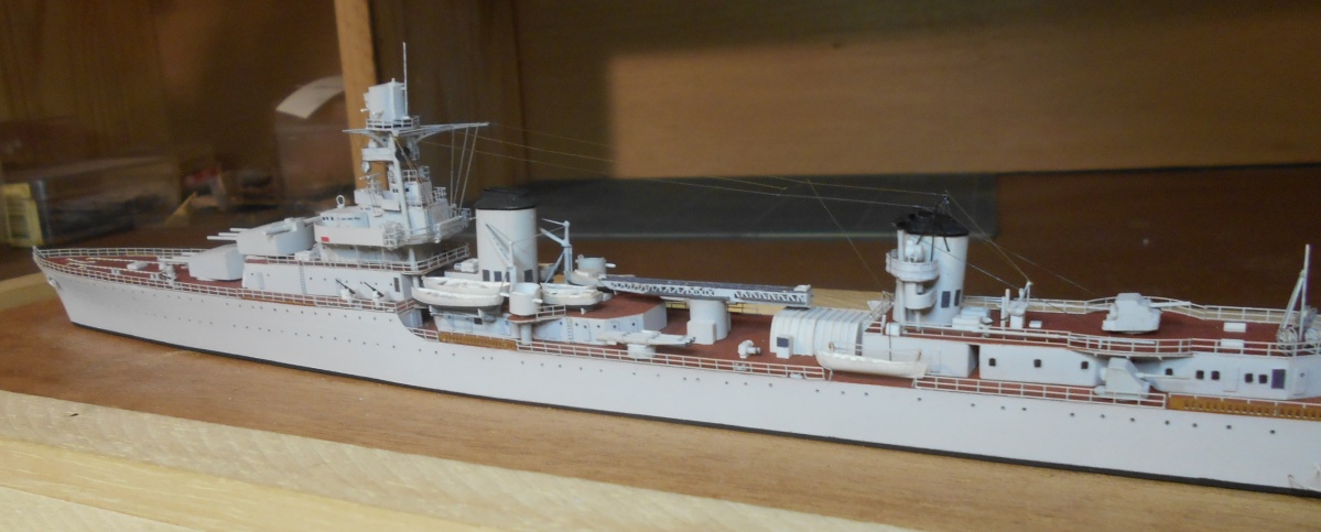

Finished !
