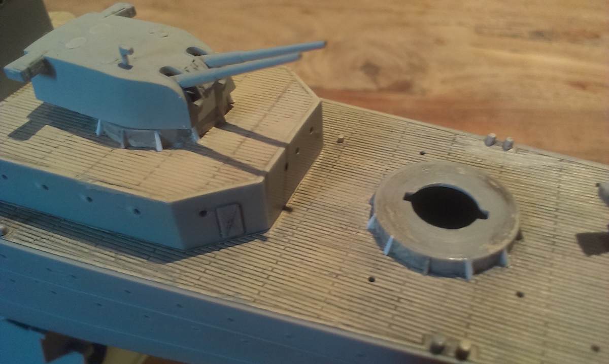

And here are the corrected barbettes, with twelve reinforment plates.
As you see, the replaced deck around B turret from Evergreen is quite nice. The butt ends of the deck planks I scribed in similar fashion like the rest of the kit, not to fall out of tune of course.
On the Y barbette I replaced all the triangles to make them similar with those of the forward turrets.

Re: Calling all HMS York class (HMS Exeter-WWII) fans
Well that confirms it, two doors are correct. Nevertheless I find Shapeways detail overdone in some aspects, prefer to add the details scratch and with PE. Thank you for bringing up the issue with the bases, this kit will need some additional work, more than what I expected.Brett Morrow wrote:Are these images any help?
Marco
- Maarten Sch�nfeld
- Posts: 1846
I fully agree with you, Marco. The Trumpy kit is better than expected, looking at their previous kits, but lacks in a lot of places. I also agree with Tracy White, it seems Trumpeter fully relies on Profile Morskie, but that reference is not always very accurate, making too many assumptions without checking with solid references like photos.Marco wrote:Well that confirms it, two doors are correct. Nevertheless I find Shapeways detail overdone in some aspects, prefer to add the details scratch and with PE. Thank you for bringing up the issue with the bases, this kit will need some additional work, more than what I expected.Brett Morrow wrote:Are these images any help?

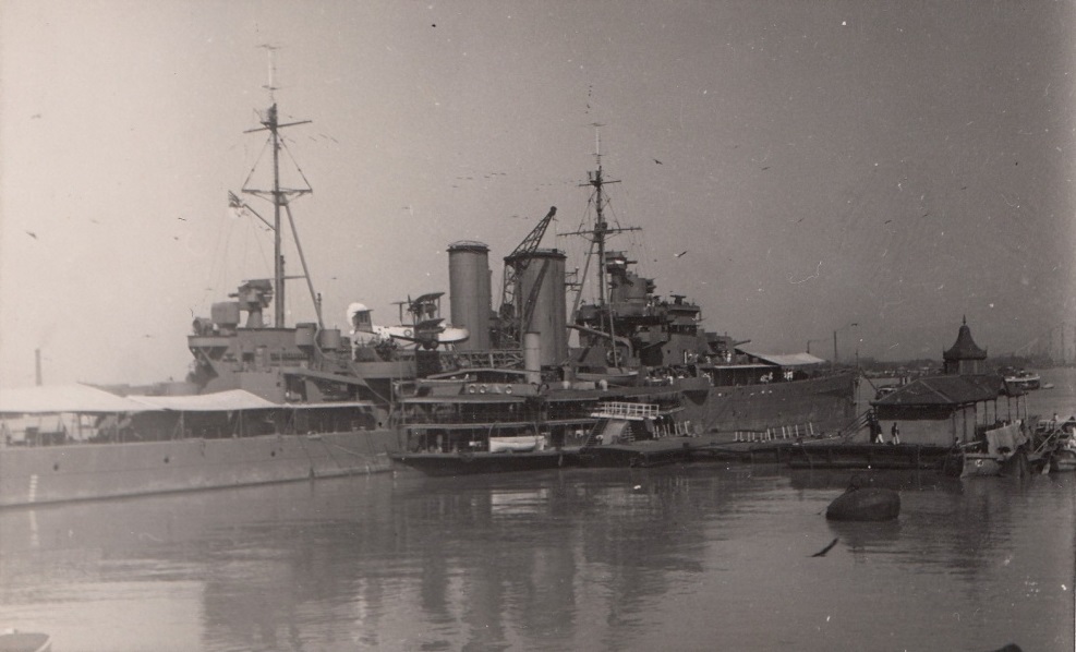

FRAMSailor
- Posts: 168
- Joined: Thu Apr 28, 2016 11:03 am
Was there ever a general consensus on if the "EX" on the tops of the turrets were black or red?
- Maarten Sch�nfeld
- Posts: 1846
I'm afraid not yet! The red version seems to have emerged from Profile Morskie, but I have no idea on what evidence this was based. As far as I'm concerned David Hogues version in black looks more credible although less colourful to me.FRAMSailor wrote:Was there ever a general consensus on if the "EX" on the tops of the turrets were black or red?
And to add to the confusion: here we have a picture with the "EX" only on the rear turret, and in white apparently!

FRAMSailor
- Posts: 168
Maarteen, interesting photo of Exeter with the white "EX." Can't make out if the aircraft is a Fairey IIIF or a Hawker Osprey but, either way, prewar.
Speaking of aircraft: Exeter had York's Walrus at River Plate, but was it camouflaged or silver?
- Maarten Sch�nfeld
- Posts: 1846
I believe the embarked Walruses were still in silver paint by that time, and all photo's I've seen of Walrusses on HMS Exeter support that. There was simply not the opportunity to exchange them for camouflaged examples. It's just a peculiarity like the bronze eagle still being on the stern of DKM Graf Spee at that time, although the order had been given to remove all these peacetime markings.FRAMSailor wrote:Maarteen, interesting photo of Exeter with the white "EX." Can't make out if the aircraft is a Fairey IIIF or a Hawker Osprey but, either way, prewar.
The aircraft on the previous picture seem to be Seafoxes to me, as Ospreys had a longer engine compartment.
