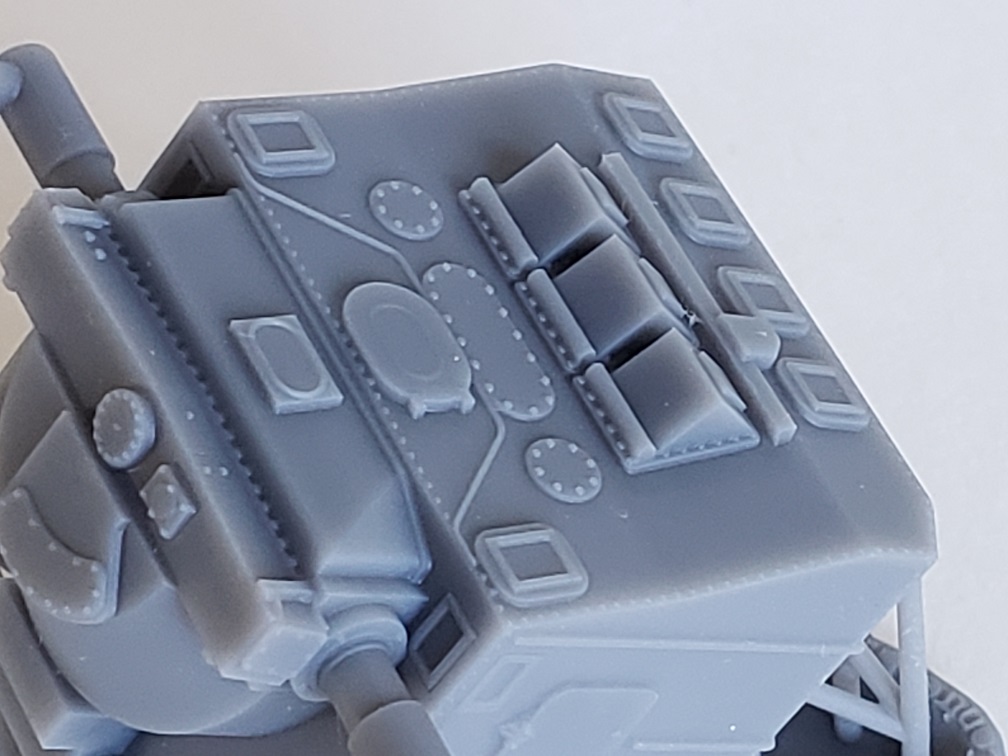

Certainly, Shapeways offers many attractive advantages. Shapeways' "smooth fine detail plastic" is a good material for many modeling purposes.
Having said that, gray resin is an alternative worth considering. Please be aware that there are different kinds of printers that use gray resin as a printing medium and all gray resin printers are not created equal. Some are excellent, professional-grade machines. Others are novelties.
In my opinion, there do exist gray resin printers that produce models that are far better than those printed by Shapeways and they are accessible to modelers.
The gray resin printer I use, a Formlabs Form 2, is based on a different technology and printing method than that used by Shapeways. I chose to purchase one and print my own designs in response to customer complaints about the smoothness of Shapeways' products using their tech. The Form 2 is a professional-grade machine best known for its use by dental professionals to create extremely accurate molds for dental work. It is not a hobby or high school printer extruding nylon.
For modelers, in many respects, the Form 2 produces superior models than the tech used by Shapeways. The Form 2 achieves greater detail and exceptionally smooth surfaces right out of the printer. There is no need for any surface smoothing using an air eraser or other baking soda blasting (effective but messy work). Gray resin also accepts more kinds of hobby paints, including enamels, without the need for post-curing by the modeler. The Form 2 is an expensive machine and so is the resin. But there are Form 2 owners and printing companies that are happy to print designs created by others for a reasonable, affordable fee. I don't offer this service but can point you to some who do. Their pricing is comparable to Shapeways.
Shapeways' "smooth fine detail plastic" printers use wax to support overhanging features during printing. Wax contact with the resin during printing causes surface roughness. Instead of wax, the Form 2 uses physical sprues to support overhanging features during printing. The sprues must be cut away by the modeler. Some modelers find the sprues objectionable and prefer Shapeways' waxy tech.
Here are some examples of gray resin models as they appear right out of the Form 2 printer in scales from 1/700 to 1/24. None of these models has been cleaned up or altered in any way. This is exactly what the printer creates and exactly what the customer receives.
Model Monkey 1-96 Mk33 Director late enclosed c.jpg [ 157.36 KiB | Viewed 2971 times ]

Oh yes, 0.1mm is no problem. The exterior cabling on this 1/700 scale USS Yorktown island is 0.05mm thick, half the 0.1mm you're looking for.

You're a gentleman and a scholar! I'll check it out when I finish this build. Thank you!
