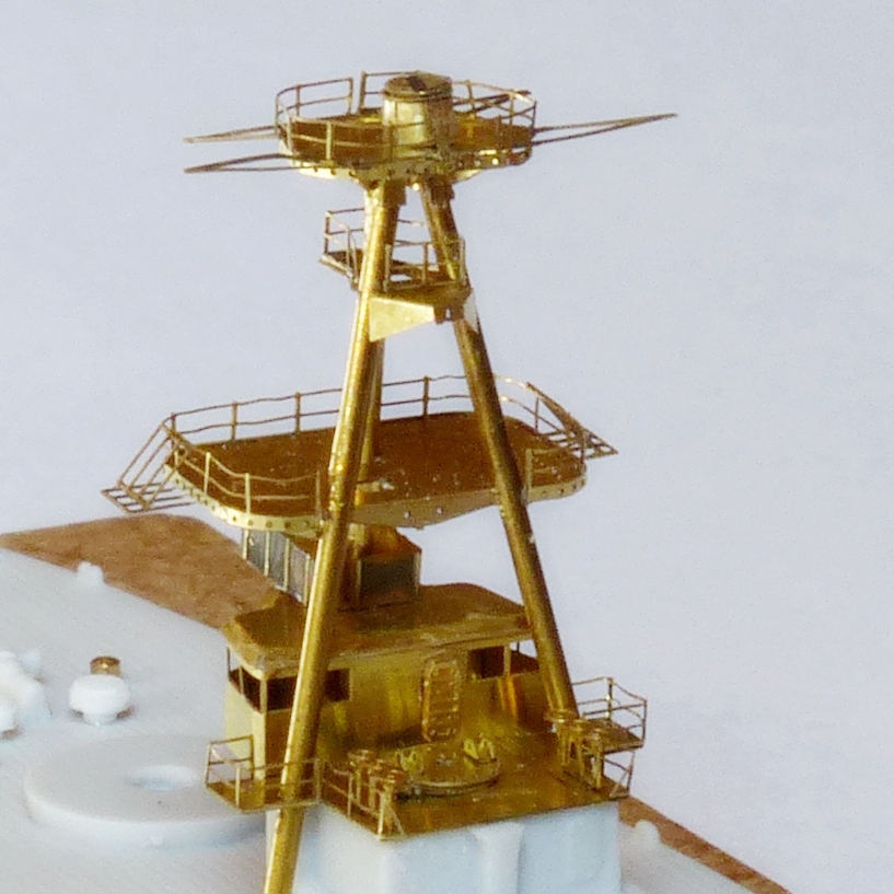

Nothing much done in the meantime, only those small searchlight platforms and their related ladders added to the forward tripod mast.
Happy May Day (and no Mayday)!
