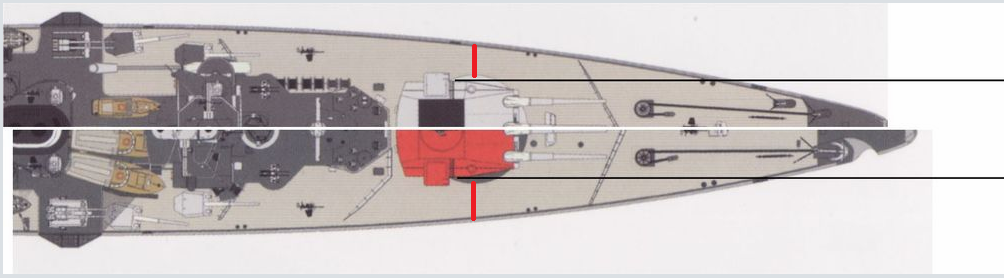

maxim
- Posts: 4031
- Location: Bonn
Re: Calling All Deutschland-class (WW2 Panzerschiffe) Fans
- Miguel
- Posts: 1562
- Location: Abu Dhabi
The drawings are wrongmaxim wrote:Here are the drawings in German Naval Camouflage, Volume One:
Top 1935, bottom 1940. Both adjusted to the same scale.
I added two lines so that it is easier to see. You can measure yourself. For sure, I am do not know, if these drawings are right.
just check the distance from the external part of the turret to the side and are not equal ,it is in a different scale ,so maybe that is misguiding you.
Unless the Scheer was based in a totally different hull ,and I am pretty sure was basically the same as the Lutzow and the Spee, they just modified the bow as the Atlantic bow

maxim
- Posts: 4031
- Location: Bonn
Ok, lets us recapitulate the literature:
All the big German ships were designed with a bow with a straight stem and not much flare (outward bending frames forward). All of them except of two, L�tzow and Admiral Graf Spee, got the Atlantikbug (Atlantic bow) to improve their seakeeping and make them less wet forward. Although some of the ships got the Atlantikbug before being completed, several were converted afterwards. These conversion had according to the literature also the feature that the frames were bend more outward (vergr��erter Spantenausfall). See e.g. Wikipedia:
This was part of a conversion, which should have been executed for all three ships of the Deutschland class. The purpose of the conversion was to reduce top-hamper, to improve the seakeeping and to overhaul the diesel (see e.g. Die Panzerschiffe der Kriegsmarine by Siegfried Breyer). Because of the war that conversion was not executed as planed, but it was executed for Admiral Scheer, because her engines required an urgent overhaul (therefore she could not be deployed at the start of the war). During this conversion also the foreship was modified and she got the Atlantikbug. Her sistership L�tzow was not converted to the same extend, e.g. she did not got the Atlantikbug, but only a much more limited modification of the stem. That is visible by two characteristics: the amount of flare (outward bending of the frames; not only of the stem!) and the position of the anchors.
What kind of evidence do we have that the modification was more extensive than just the modification of the stem? Obvious are the anchors. And obviously the frames bend outward as seen at the photo linked by Miguel:
The bow looks very similar to other ships, which got the Atlantikbug, e.g. Admiral Hipper, Bl�cher, Prinz Eugen, Scharnhorst, Gneisenau, Bismarck, and Tirpitz.
If the frames bend more outward, the expectation would be that the deck is wider. And that is exactly what we see on the drawings by Eric Leon in German Naval Camouflage Volume One 1939-1941:
(top Admiral Scheer 1935, bottom Admiral Scheer 1940)
Here is the deck wider. Miguel wrote that I scaled the drawings wrong. Ok, but please check the width of the hull midships on both drawings and the dimensions of the forward 28 cm turret. It is the hull, which was modified and this modification was extensive, even though it was executed in a very short time. But that was the execution of a modification, which was planed anyway and which was also done for most other bigger German ships.
By the way: the hull of all three ships of the Deutschland class was different. All had different beam and side armour. And all had a different bow in their last fit: L�tzow only got a modified stem, Admiral Scheer got a Atlantikbug, and Admiral Graf Spee was never modified.

My dear Lars ,this taking us nowhere , your drawings are wrong and what I checked the vertical profile on Lutzow and Scheer were almost identical in the front part of the ship and the Graf Spee only was shorter by about 2 mts due to the lack of Atlantic bow .
I hope that somebody can en light us ,because your references are not reliable ,neither mine what I can see in the photo I provided ,the flange was more radical ,but the width is the same or maybe just a few centimeter wider,but I think the profile can be accomplish in the plastic model by just removing material from the sides of the bow in the red curve lines

maxim
- Posts: 4031
- Location: Bonn
Why are these drawings wrong and the other correct? To simply claim that these are not reliable does not really help. I would consider these more reliable than the ones included in the Monografie Morskie volumes. The drawings in German Naval Camouflage Volume One 1939-1941 fit to descriptions in the literature and to the photo of the bow.
To repeat myself: the literature writes about increased flare, more outward bend frames and that would increase the deck as shown in the drawings in German Naval Camouflage Volume One 1939-1941.
The conversions of Admiral Scheer and L�tzow are clearly different.
- Miguel
- Posts: 1562
We will not know until some valid proof appears, all I can say is the Scheer was different in the flange profile ,but otherwise the horizontal profile was the same I found another source and as told earlier the Lutzow and Scheer were identical in size and the horizontal profile also matches ,so I have no doubts .
The point is simple for me because I am not scratch building the ship ,just modifying the Trump Spee,so my homework is to give the bow a more radical flange and that's it .
