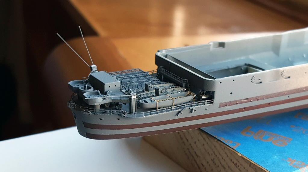

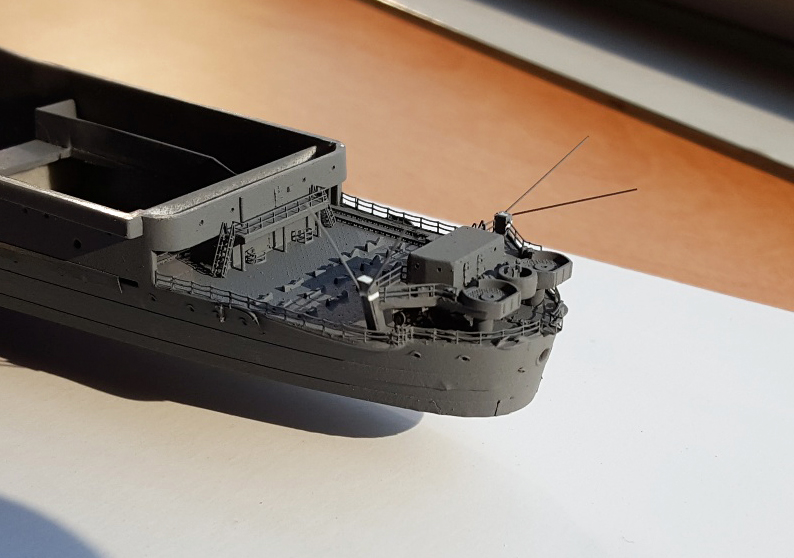

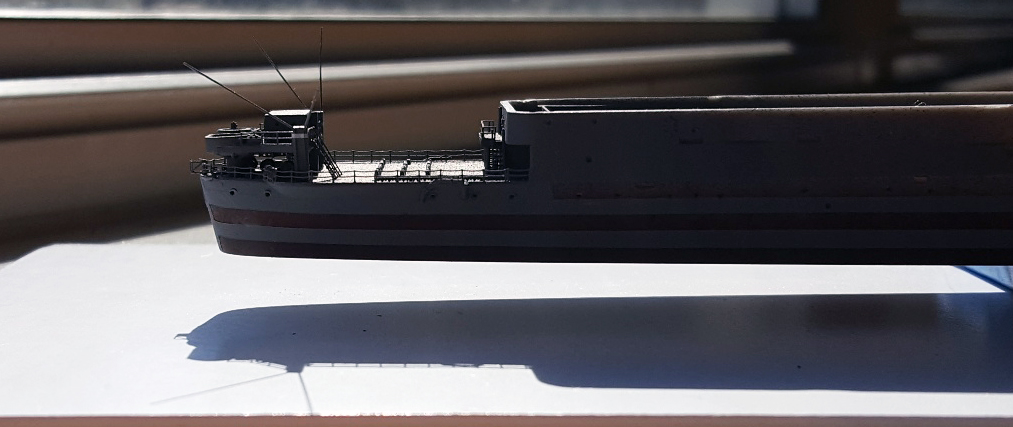

Since the last update, I�ve been working to complete the stern area and boats. When all that�s complete, I will then be able to mate the flight deck to the hull.
I started by adding the main deck rails and a leadsman�s platform. Note that the Fujimi (and AH) PE rails do not extend all the way back to the bulkheads. The resulting gap on either side could act as the opening for the accommodation ladders at the stern when in those were in position, but I think that gives them a bit too much credit. I filled these in with extra railing.
Drainpipes for runoff from the flight deck rain gutters were added to the support columns, and I prepped the hull for some paint plating effects after hull red was applied to the waterline.

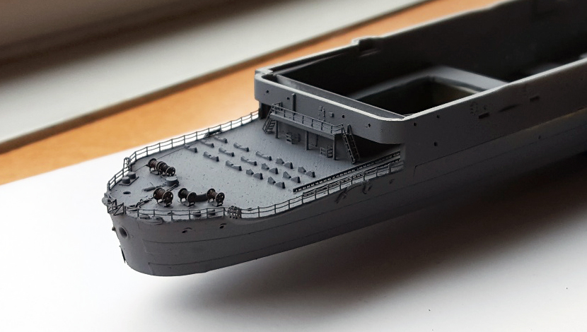

The forecastle deck, stern deck, and stern AA deck were then painted grey. Hawser reels were added to the stern and the AA platform emplaced over them. Btw, Fujimi didn�t bother to provide any hawser reels. Admittedly, the documentation about those reels is unclear, but it�s reasonable to speculate based on earlier carriers.
Once everything was glued in place, the tape for the plating was removed.

Ship�s boats were created using the AH PE, which (it has to be mentioned) is pretty much a knock-off of the Five Star PE, with portions of the instructions left out. Not helpful.
I would have preferred to use 12m motor launches and motor cutters from Pit-Road and the NE series, but those were in short supply. Given the PE, it was easier to strip down the more generic boats from the Waterline Consortium Large Vessel Ordinance sets and use them.
When I've finished painting them, they'll be glued in place.

Boat straps installed. Normally, I would use paper, but I purchased some Five Star versions on sale, so I though I would try them. Aside from having to cut them down in length, they worked out well. No need to strap the inner boats down as one will never be able to see them.
I also painted the underside of the aft flight deck. The deck is now ready to be mated to the hull.
I just like to make the W-I-P interesting and useful.

BTW, for those keeping score at home on consistency, I did have the mandatory "drop the model" incident a few days ago. Fortunately, only two boats popped off. Stout construction, it seems.
Obviously, I am now using a heavier construction base.
